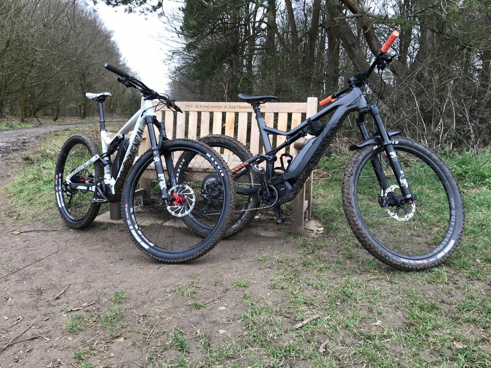

Hi damo, thanks I’m really pleased with the white!
I have had a spin on the canyon but my friend is significantly taller than me - the canyon is XL and my Commencal is M - so as it was way too big for me it’s difficult to give a fair comparison!
It was between the canyon and commencal for me too, after test riding a few different motors I decided I wanted a bike with the shimano steps motor and the spec level and prices are very similar on the two bikes. Tbh I struggled for weeks going back and forth trying to make a decision between the two!!
If it helps I’ve been mega happy with the metapower and I know my friend loves his canyon, so I think whichever one you go for you will have great fun riding! ?
Trail Doug
Nov 22, 2018
96
81
Wrexham
It was a close run thing for me also. The deciding factor came down to the faster rolling rear end on the Meta Power 29, the coil shock and not wanting to have to carry 2 different sized spare tubes.
That and I prefer the less industrial look of the Commencal.
