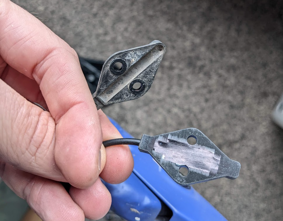

I haven't had the chance to install it yet. On outside, it looks just like the normal disc magnet sensor from shimano, but the underside looks like the inside has been re-potted with epoxy so something is going on in the inside.
Shimano original on the left and mbiq-s on the right.

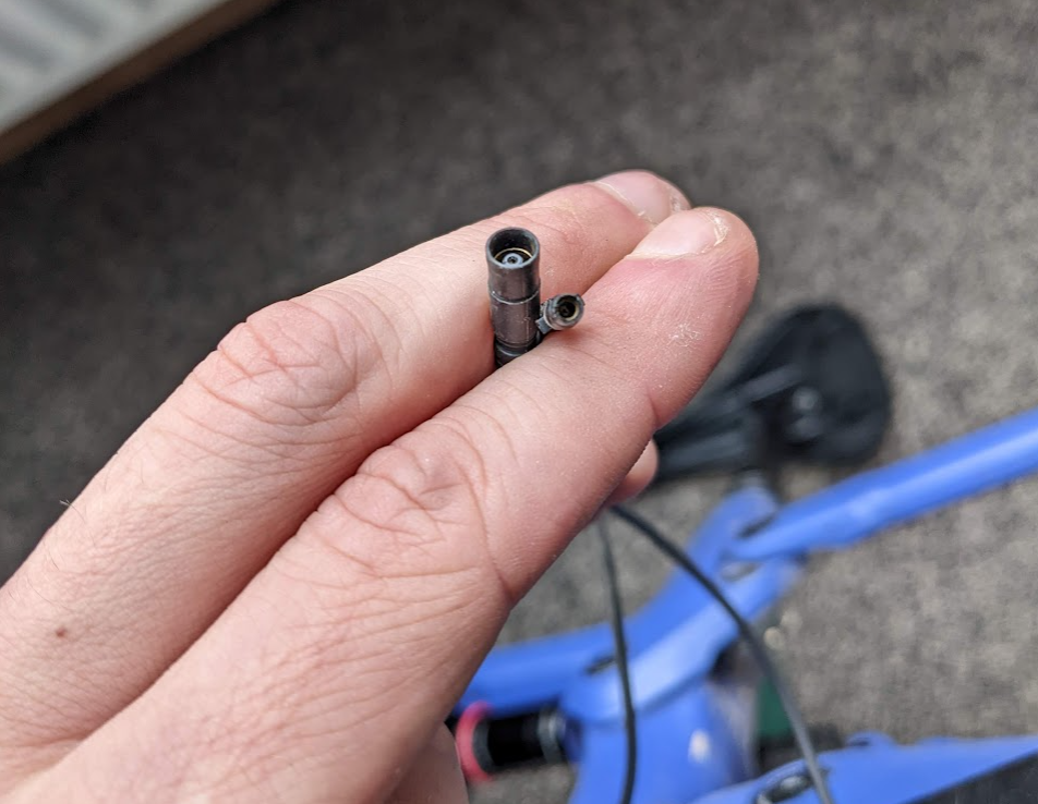

But the main problem is, that the connector is different to the normal speed sensor (pictures). The mbiq-s sensor has SD300 connector but the EP8 motor has the SD50 connector. So I need an adaptor to connect it.
Smaller is Shimano original and the bigger is the mbiq-s.

Yes, there is such adapter:
I also need a sd50 wire to go with it:
