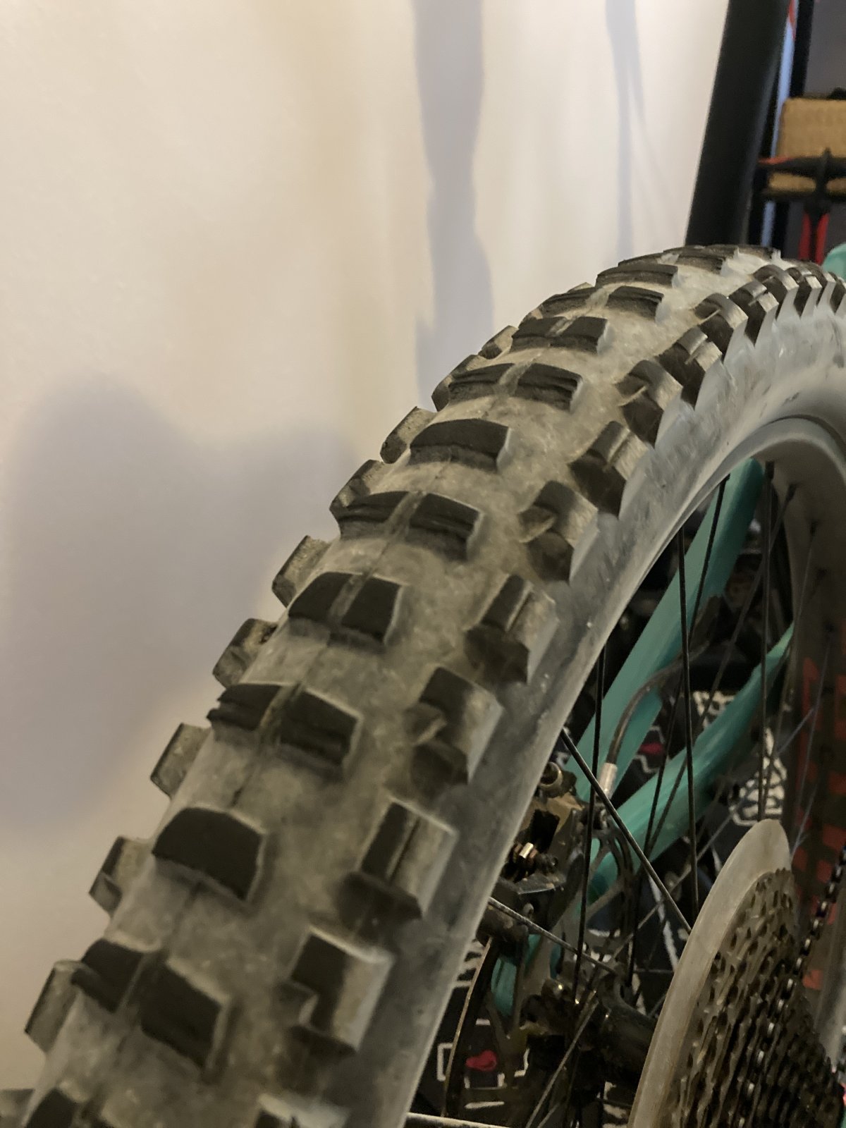

Well yes, my 2020 Kona Ebike came with 2.8" Maxxis Minion DHF and DHR on it.
They seem fine to me, only had one puncture in 1500 miles, when a ruddy great thorn went through the front, needed pliers to pull it out!
The rear is due for changing soon but after 1500 miles off/on road l don't think that's too bad.
Lets not be hasty here ..if that is a current pic you are good for another 1500 miles ..?

Straight line billy ?
l know, it does look fairly bad doesn't it? Although l don't get my knee down on corners, l thought l was better than that....
I think it's the road miles that may have squared off the rear tyre, out of the 1500 miles l've done on the bike, around 1000 have been on the tarmac.
