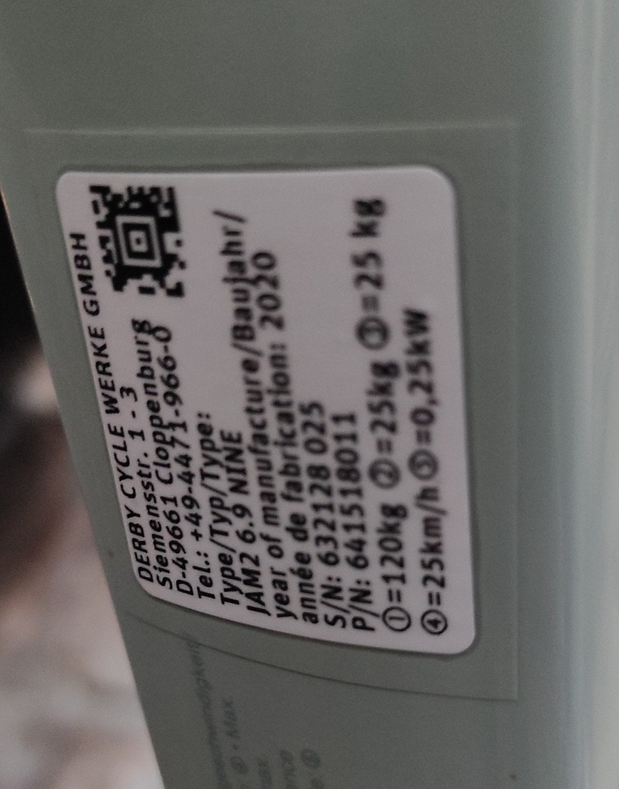

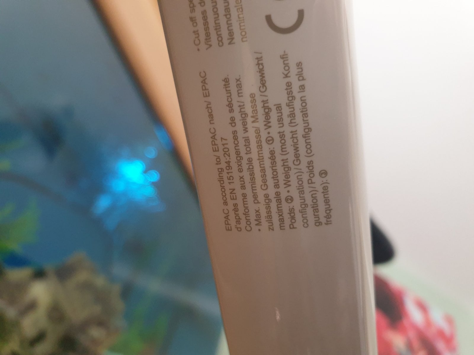

This has been discussed on here before.
And the answer wasn't made clear then either. There's contradicting advice given and nothing is clear, even the labelling on the bike from the CE sticker.
The website says bike and rider plus gear and all the sticker on the frame actually says is " max permissible weight ".
So which one is right ? The website or the actual warnings given on their bikes ?

I must be missing something. What is the difference between "max permissible total weight" (off the pic above) and "bike and rider plus gear" (Focus website)?
What would be useful would be an actual figure stuck on the frame.
In hindsight, anybody who doesn't know anything about mtb would look at that sticker and think that they can't be over 120kg in weight. Otherwise its a bit like saying your car can only carry 100kg of luggage because you have to take into account the weight of the car. It makes no sense

I still don't understand the point you are trying to make. What else can "max permissible total weight" mean? The bike makers have to use total weight (bike, rider, kit), due to the massive range of rider weights. Especially when even the lightest rider is likely to be at least twice as heavy as the bike alone. In my riding kit, I'm 4.5 times heavier than my bike. So rider weight (inc kit) is a key design criterion to the bike designer.
But my car is quite happy with just me in it OR me plus 4 passengers, a boot full of luggage and a tow bar rack with two bikes. My weight is a triviality to the car designer.

If you asked Joe bloggs off the streetvto read the label and then answer the question of... what is the maximum weight for the bike they will tell you 120kg.
They would even think about adding the weight of the bike into the mix so why are people saying you have to take this into account when the labelling doesn't state this
