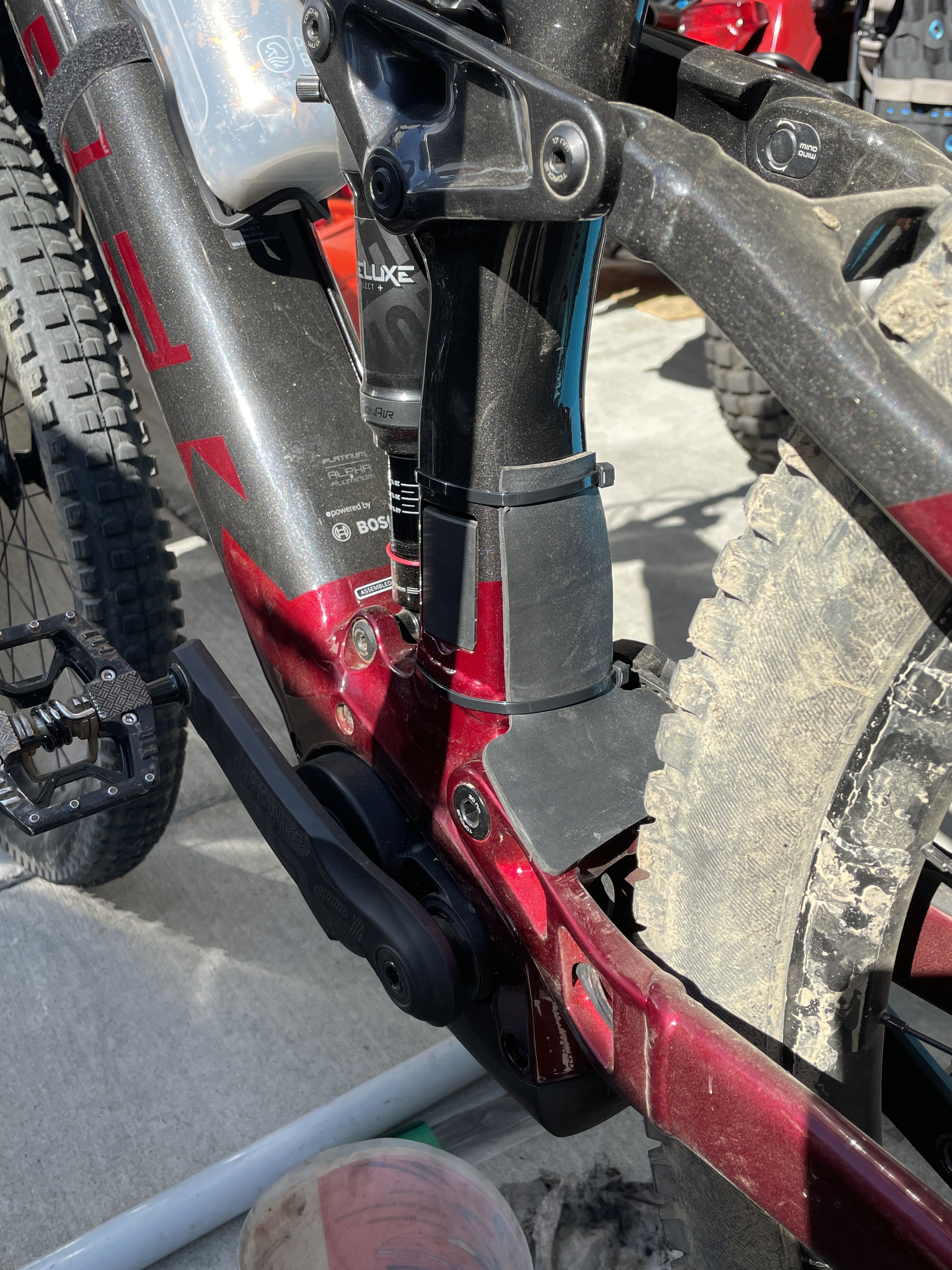

A thing I noticed with my new Relay is that there is no guard/fender/mud flap to keep mud, sand, and most importantly ROCKS out of the main pivot. I have seen photos of catastrophic carbon frame failures due to rocks getting into a pivot.
As a temporary (or maybe permanent) solution I used a scrap piece of Rok Block from my truck tailgate to fashion a rubber mud guard
This was version 1... I have more scrap if needed to change the shape, location, etc. I think the main change I am already looking at is not notching it at the bearings to keep debris out of that gap. Kind of ugly, but it is a prototype. Haven't ridden to test it

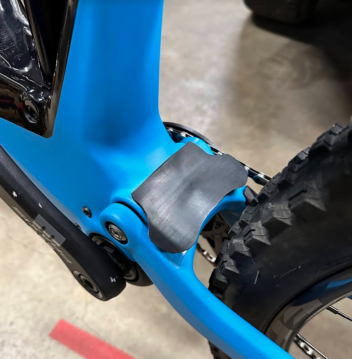

Your solution looks very similar to what came on my Pivot Shuttle AM. It's just a little patch of rubber that's stuck to either side. It works nicely.

yeah, same as my Phoenix 29.
