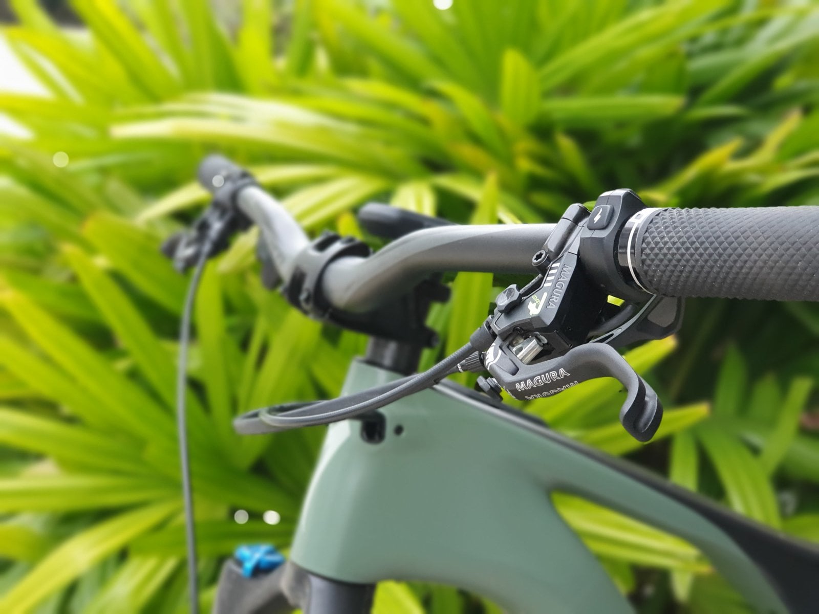

center the calipers carefully and there will be no noise coming from the pads. I did upgrade to hc3 levers and love them. One finger stopping power that could stop a locomotive. No issues with fade, no overheating. Tons of modulation as others have mentioned, very similar to motorcycle brakes. i Am now running jag wire pads having worn out stock pads. I also run magura discs 220 front and 200 back. I do not recommend 220 in the back as that will be too much and you are constantly locking up the rear. Even with 200 in the back I’m locking up the rear easier than I would like but this will be something I get used to. View attachment 49844
Some people say that the HC3 adjustments do nothing? So are you able to adjust modulation? I suspect the choice of pads will affect the bite therefore locking up more. I see people using perfomance pads as they don’t have a strong bite as the race version ... what jagwire model are you using?
Johneracer
Sep 17, 2020
32
78
Modulation is excellent as is expected. With hc3 I for the bling factor (important) plus I was really able to tune the position since it is a one finger brake and needs to be comfortable. I do a lot of single track, dragging brakes, hard breaking etc. my fingers are always one the lever.
