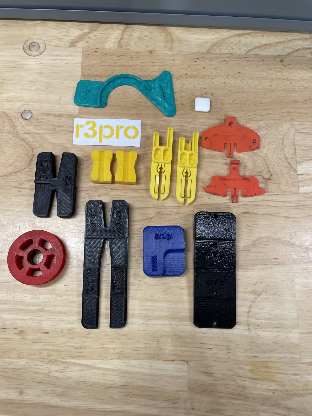

I saw those piston freeing plastic blocks on line the other day where it holds in three of the pistons and let's the other sticking one extend when you gently pull the lever. Might get one of those in case.

R3pro 3D print’s a few things for Magura brakes. I think he’s based in the UK but there was no problem mailing to here.
