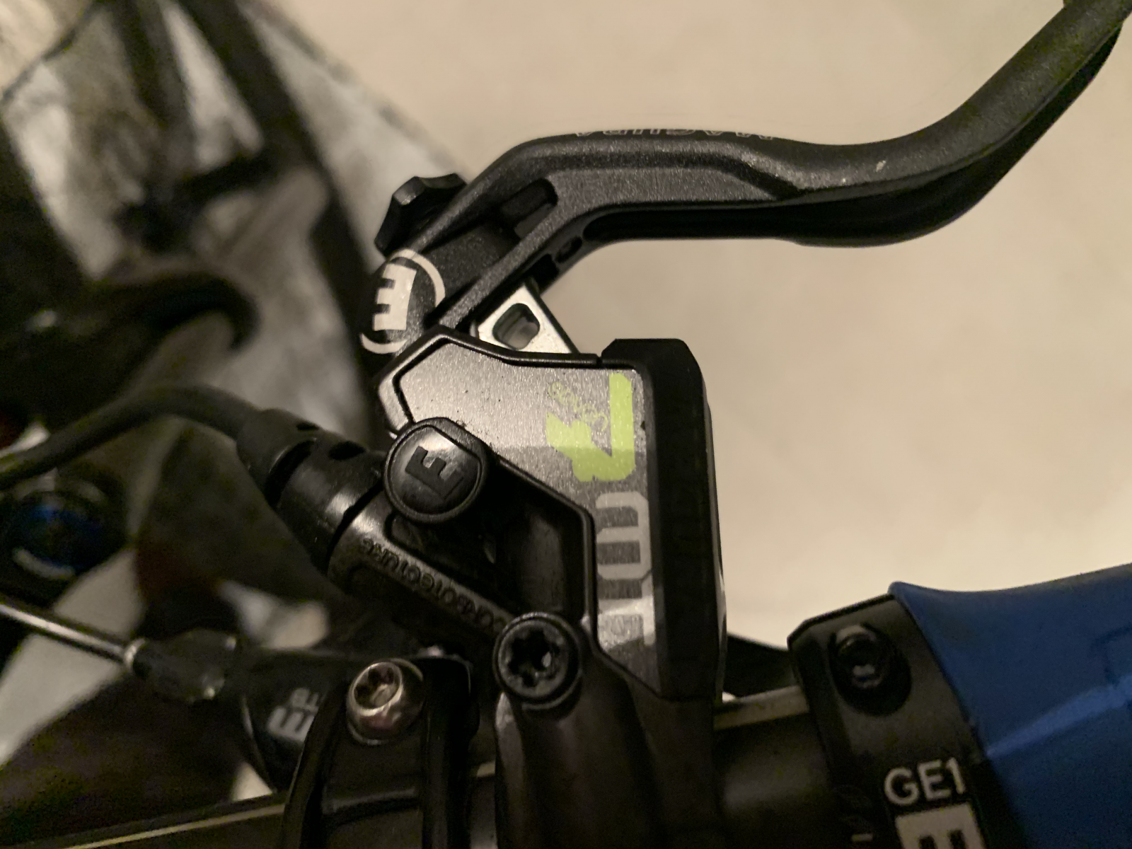

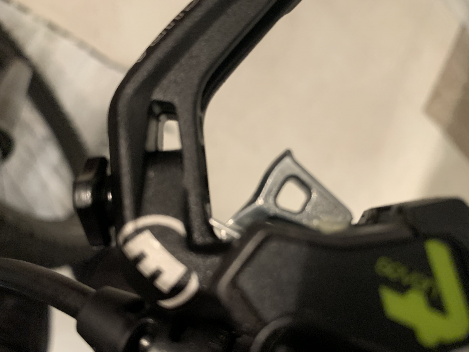

I recently had my brakes upgraded to MT7 Pro.
Brakes are spongy so was about to follow folks' bleeding instructions tips and then found this .
The lever 'lifting away from the body / stop' and a thin piece of cable showing which isnt apparent on other side. I love fixing stuff and would rather do that than refer to my LBS however I am mechanically challenged. Can anyone see what is wrong before I dismantle everything and try and fix myself o_O
Pictures are below.
First is RH Brake at rest
Second is RH brake lifted away from 'Stop" that I cant do with LH brake.
Thanks for any help

I'm not sure, but that is probably part of the spring which holds the levers in the correct position.
I had a problem with mine that one lever lept flopping out and I couldn't reach it.
It turned out that by turning the adjustment screw, you can engage or disengage that spring.

Thanks @Akiwi. I assumed that originally but it makes no difference -- may of course be my '(lack of) technique so will try again. Im using the bike so doesn't appear t0o be a major issue.
I seem to have lost that spring. Is it possible to order just that?

Probably, but I have no idea. You mean this one?
Like I mentioned above. I thought mine was broken, but it was fixed by turning one of the adjustment knobs.
I have never heard of the springs breaking or going missing, but I am not an expert.
