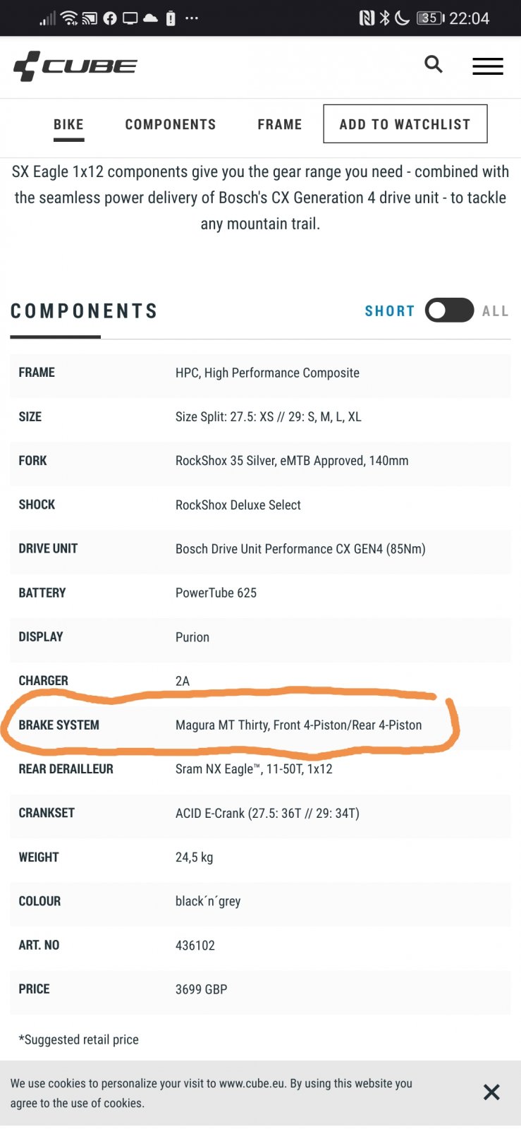

just thought I'd let others know about a confusing situation with the new Cube bikes.
I have purchased the new Cube SL625 CUBE Reaction Hybrid SL 625 29 grey´n´orange 2020
Looking at the brakes it states Magura MT Thirty, Front 4-Piston/ Rear 4-Piston. However the Magura MT Thirty do not exist so I had no idea which brake pads to buy as there's no mention of them on the Magura website. I contacted Magura and this is there reply
thank you for your request.
The MAGURA MT Thirty is a version that has been specially specified by the bicycle manufacturer. As rear brake the MT SPORT two-piston brake system will be used and at the front wheel our MT5 four-piston brake system was combined with the MT SPORT brake handle.
At the front brake (4 piston caliper) the 8.P (Performance), 8.R (Race) and 9.P (Performance), 9.C (Comfort) pads are useable.
At the rear brake (2 piston caliper) are the 7.P, 7.R and 7.C pads compatible.
After reading this i'm still confused as the rear brake on my bike is 4 Piston as stated in the Cube description and not the 2 piston stated by Magura. I'm kinda assuming I will need the 8.P,R, or 9.P,C on the rear and not the 7'ns stated by Magura

I know it's not complicated. The point of the thread is that the MT Thirty on the Cube web site, do not exist

well it looks complicated to me! cube say they are 4 piston f & r, but magura seem to think they are 2 piston rears?
fenwick458
Oct 6, 2020
295
187
Cumbria
They are 4 Piston Front and Rear
MT5 Pads are what you need
thanks. I wasn't so much interested in what type of pads they need, I don't even own any of these but I just wanted to know what the differences were between the MT 30 and MT 7
so the MT7 is the top spec they do
and the MT30 is MT7 front caliper & MT5 rear caliper, with some poorer quality levers???

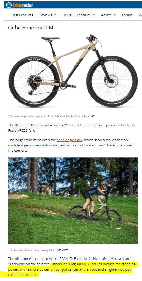

The MT30 is 4 pot caliper like the MT5, though Bike Radar, describe this bike as having a mix.
#edited to correct previous assumption#

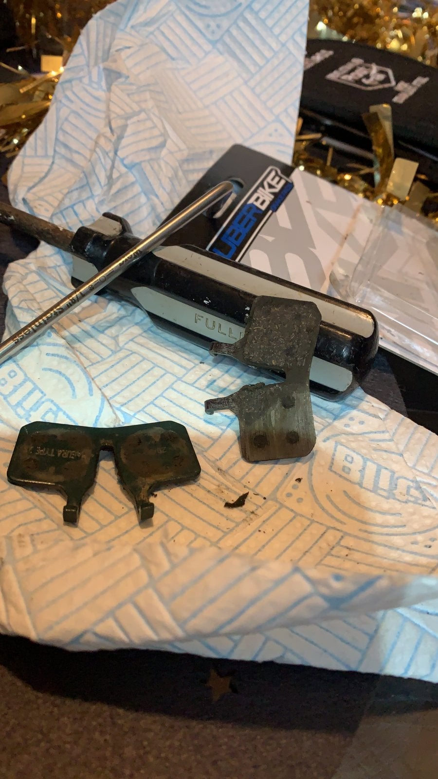

These are the ones I've just purchased and put in mine
