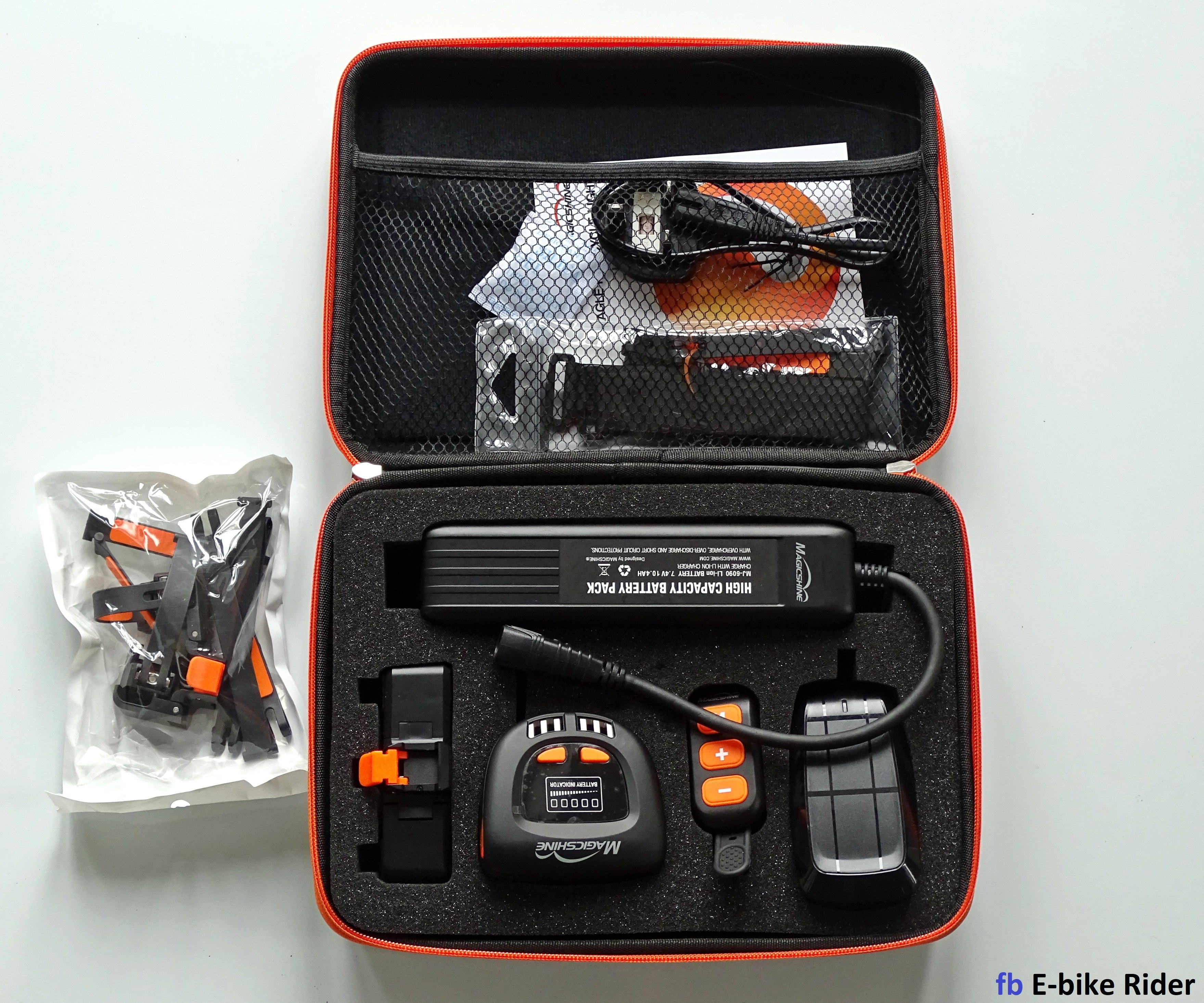

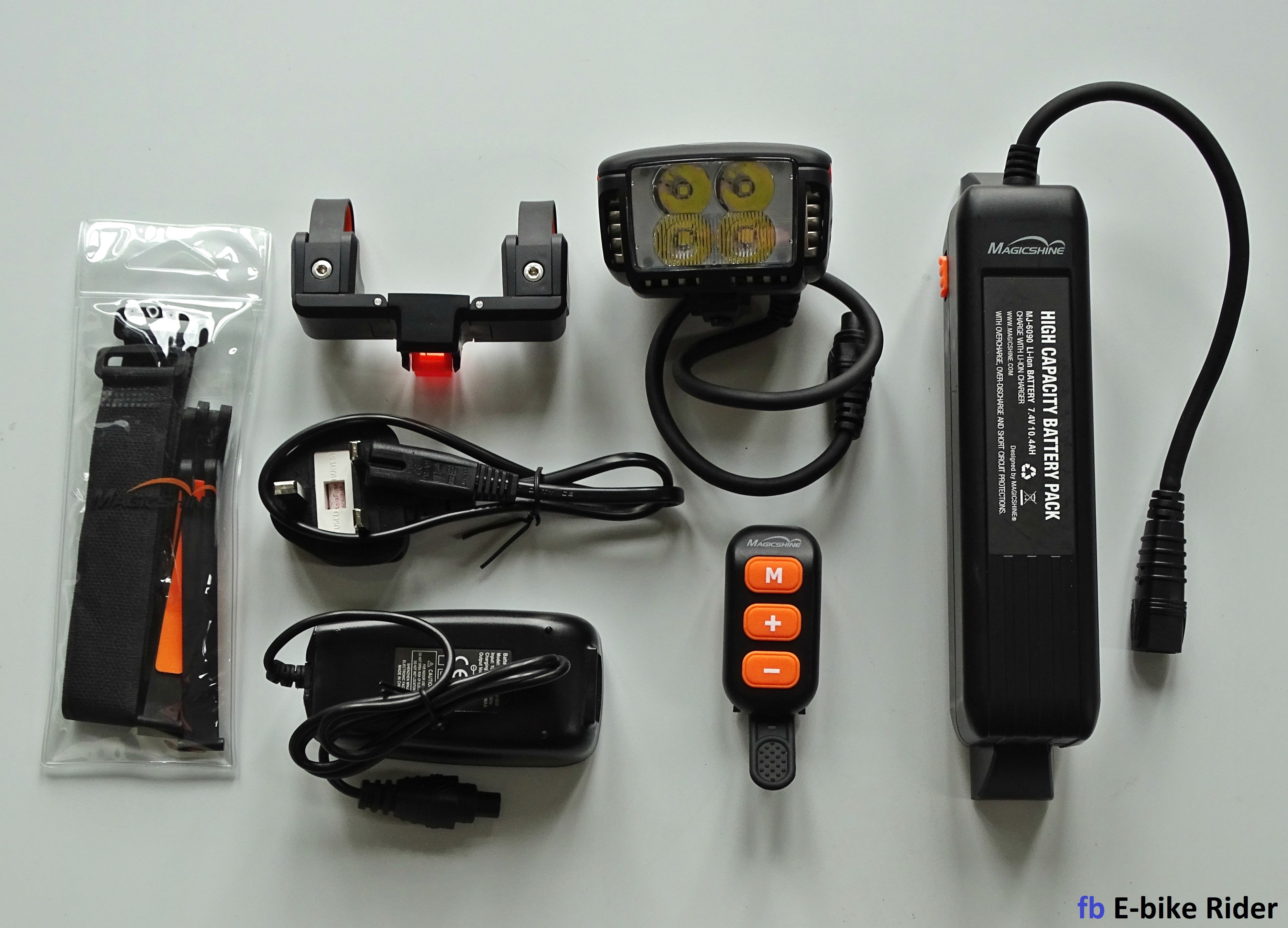

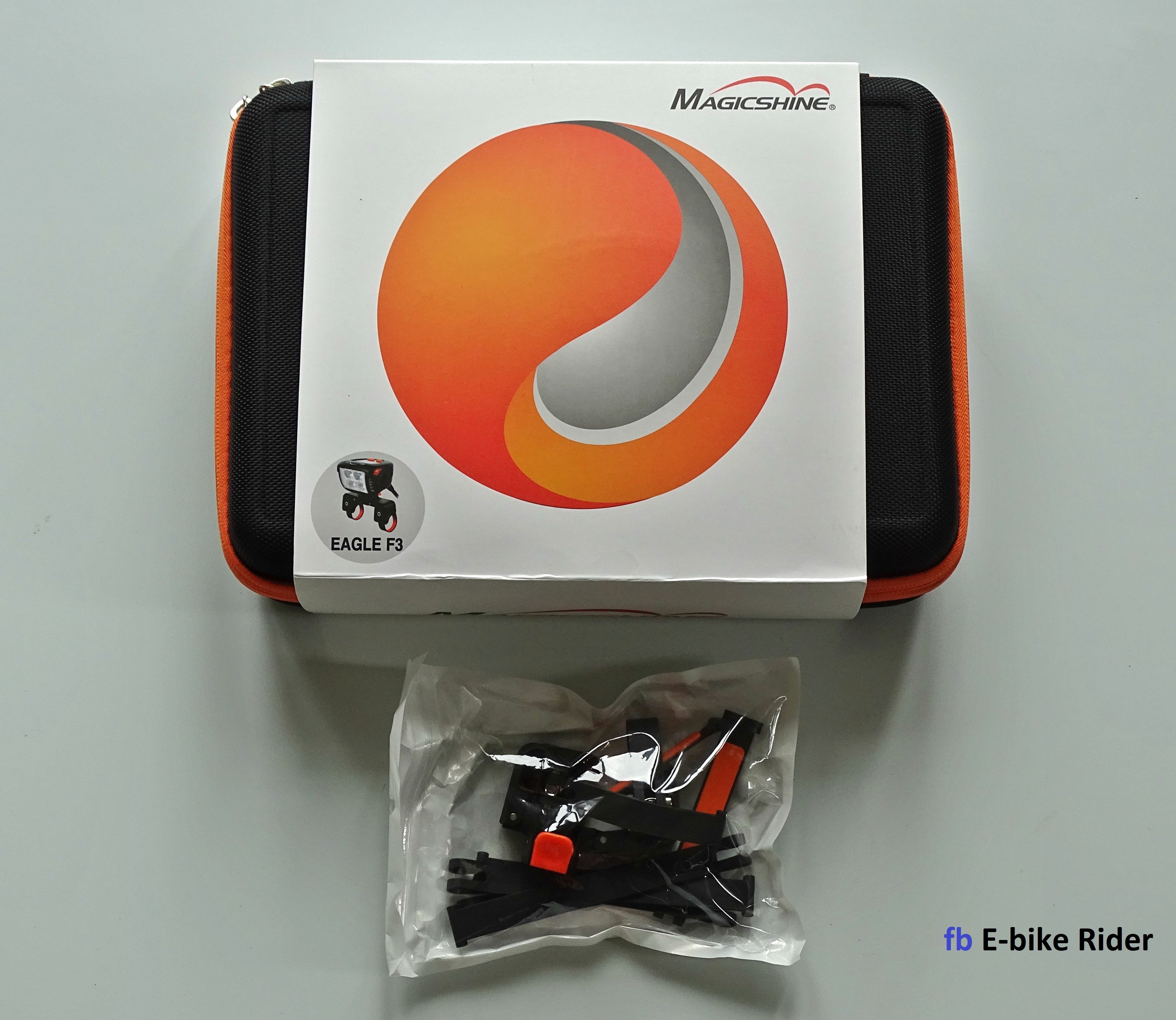

So what's in the box. An additional mounting bracket is also shown.

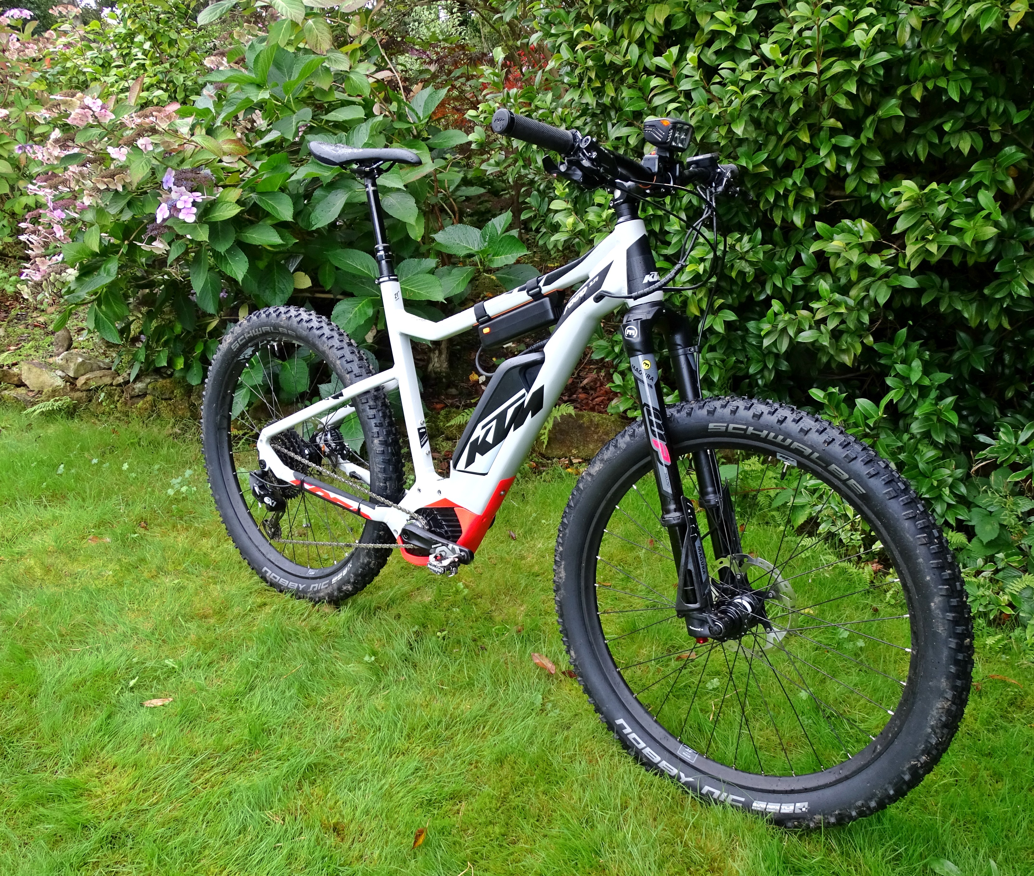

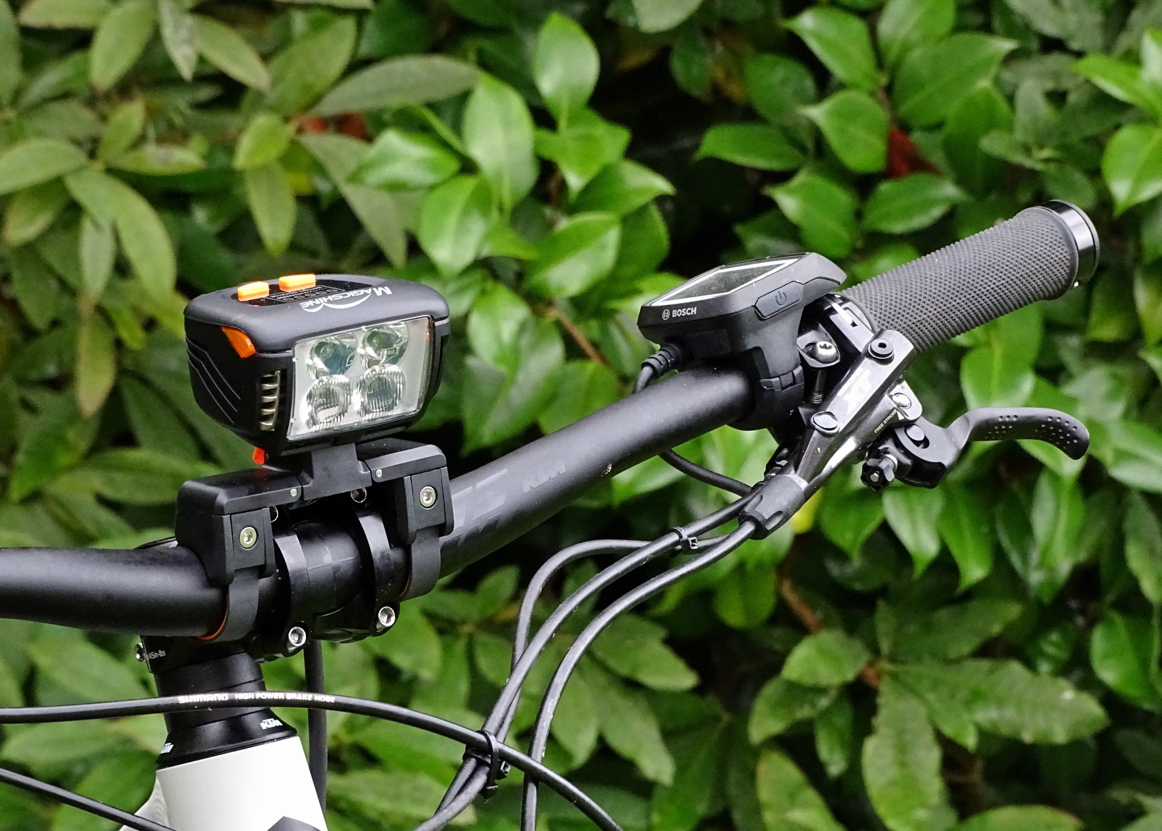

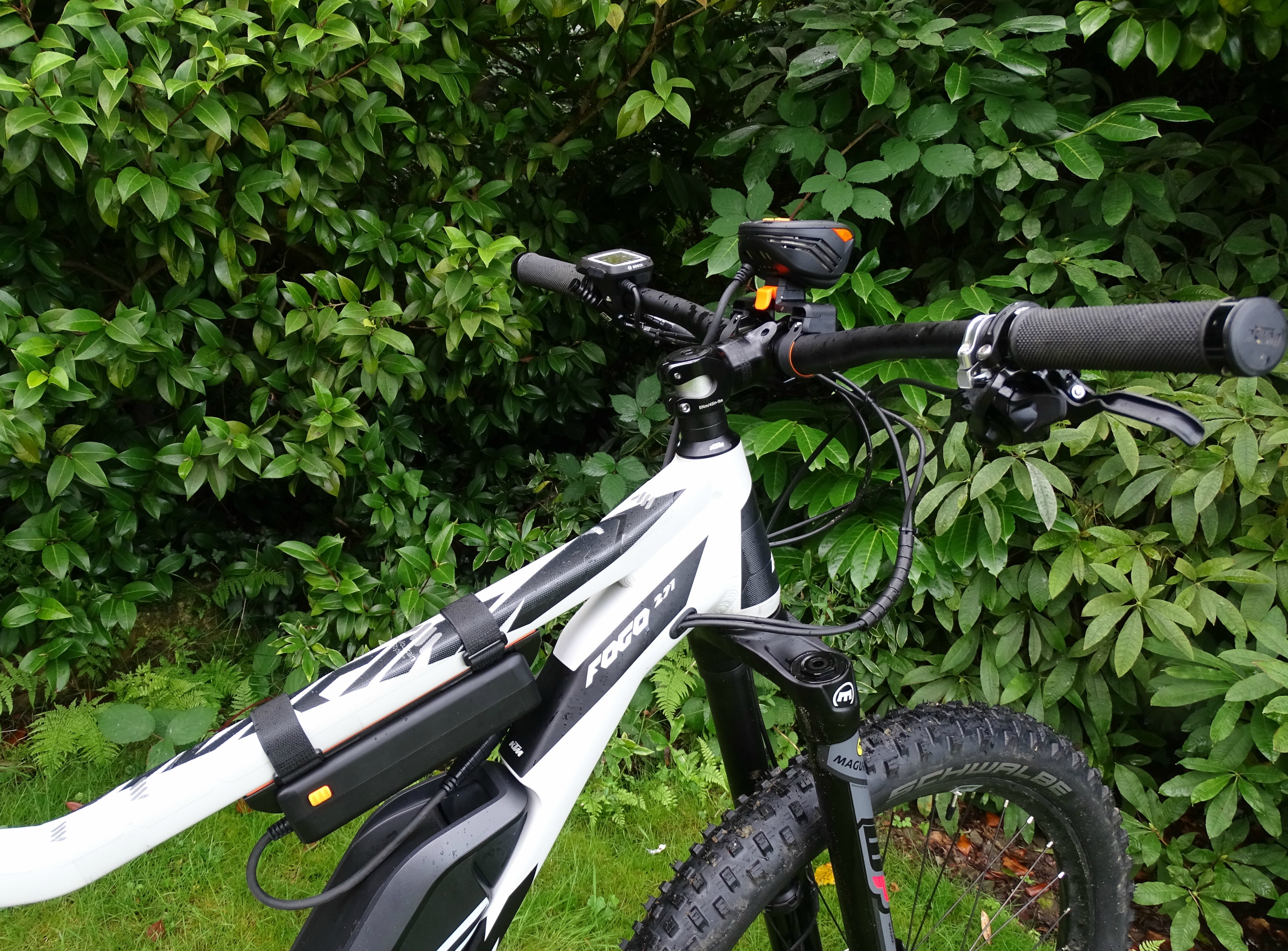

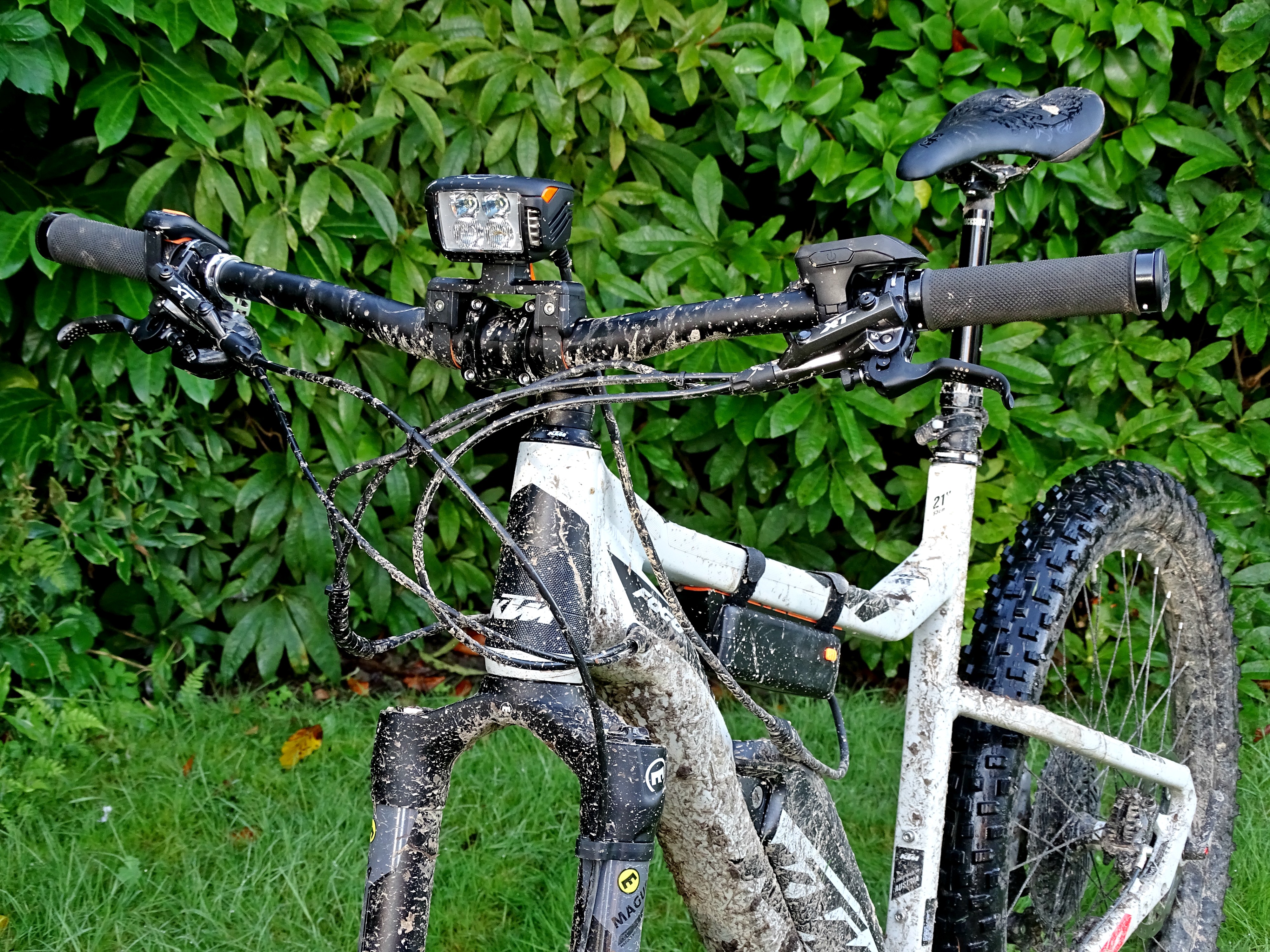

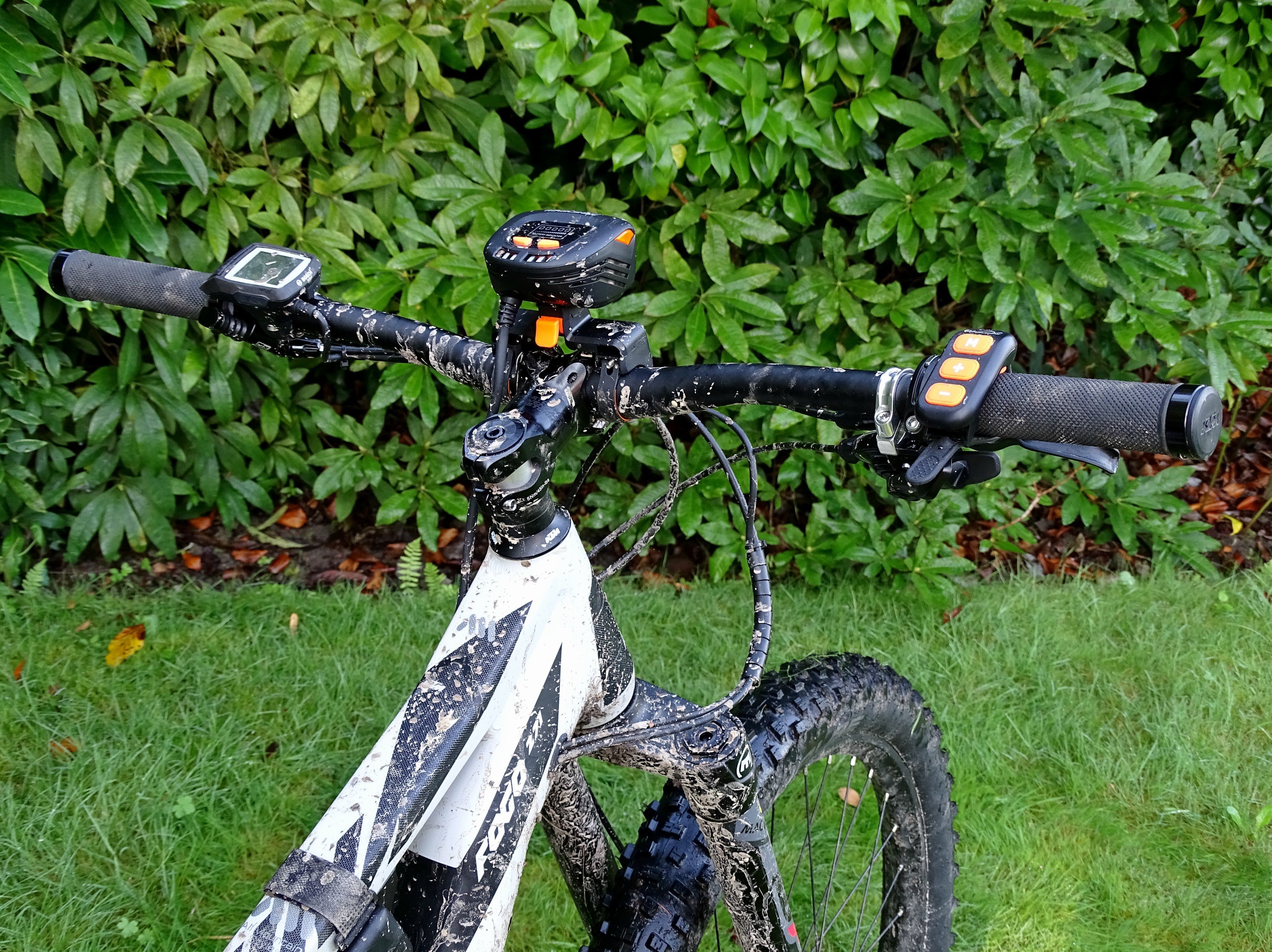

How the lighting kit looks on the bike.
The morning after the nigh before.

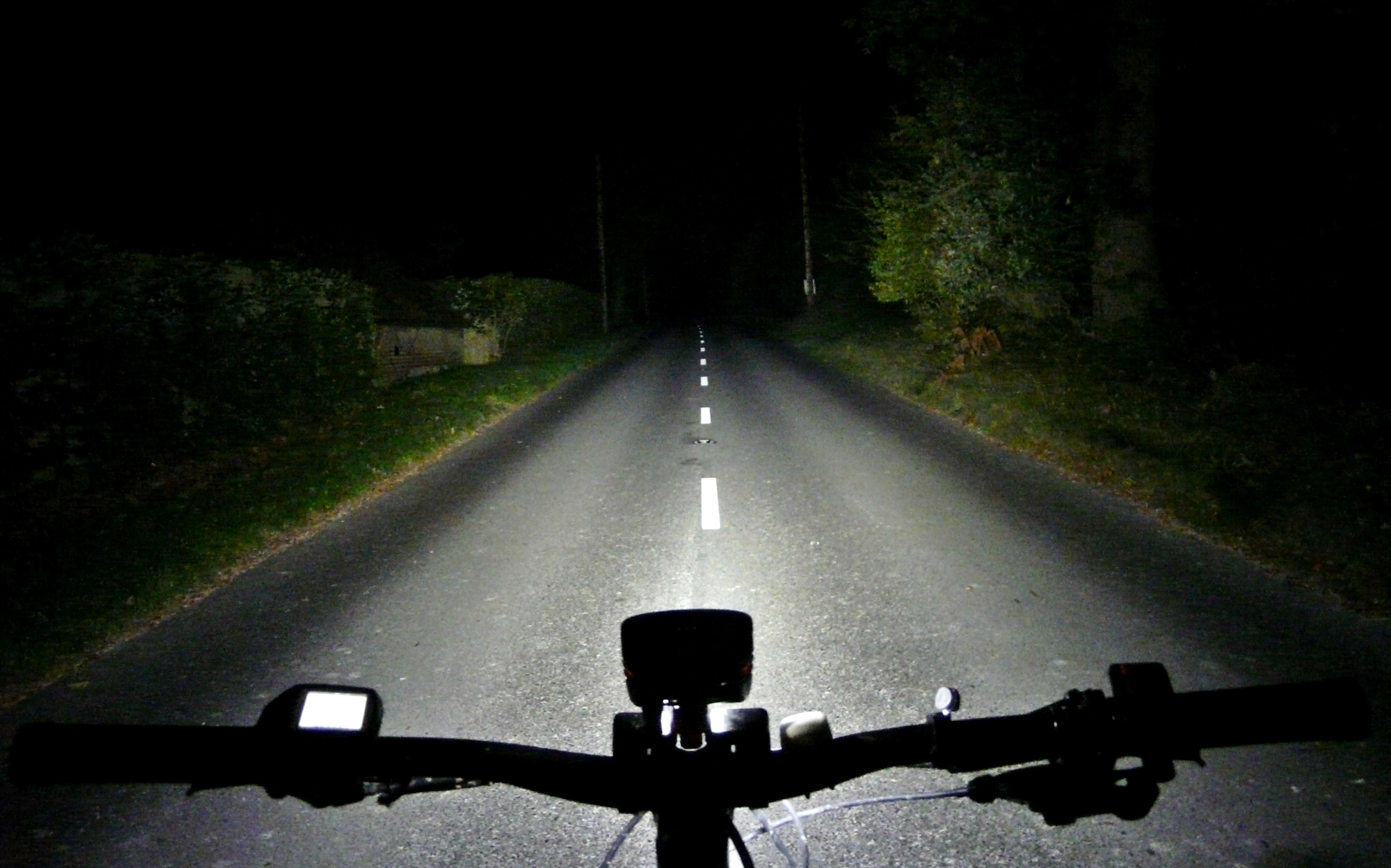

And of course the light in use. These were taking on maximum settings for the light. I shall further this as time progresses, and for comparison purposes, I also intend to show photos of the lesser lights in use.

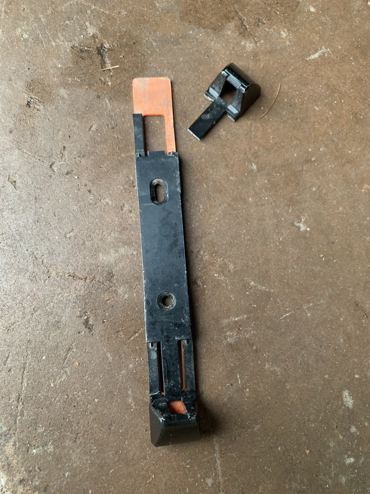

Hey guys, ive had the Eagle F3 light for almost 2 yrs and still working well. 2 problems, the connectors pull away from the cable exposing the internal wires and the battery mount bracket (uses the bottle holder screws) has snapped. It looks like the metal used for the bracket has simply perrished and is a cheap alloy of some sort. Ive now sent countless emails to purchase a replacement but no help or replies!!!
