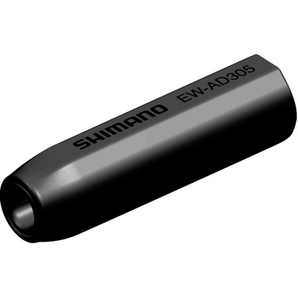

My e8000 has failed (E010 / W0013) and I’m out of warranty. This seems like a good way of upgrading, especially considering that an e8000 from Madison is £ 920. I had a quick look online for the adapters and the only place that seems to sell them is a shop in Italy (on eBay). Ridiculous delivery charges, so it will make it expensive.
Anyone know of another supplier and what, exactly, is required (adapters, display, switch, etc.)?
Master Link
Dec 7, 2018
161
63
Isle of Wight
SHIMANO EW-AD305 is available in German online bike shops and shipping cost is reasonable

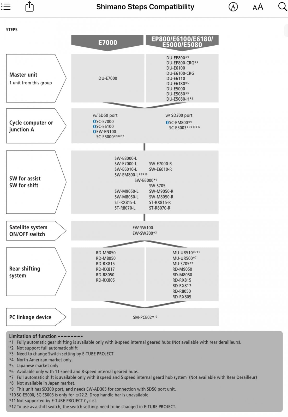

I have ascertained that my current display (SC-E8000) is not compatible. I found this compatibility document in another post.
This is the relevant page.
