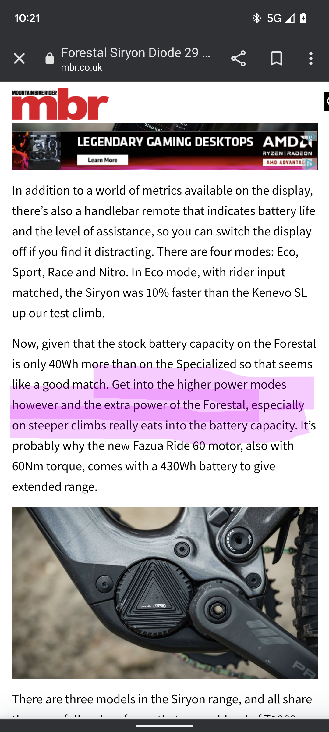

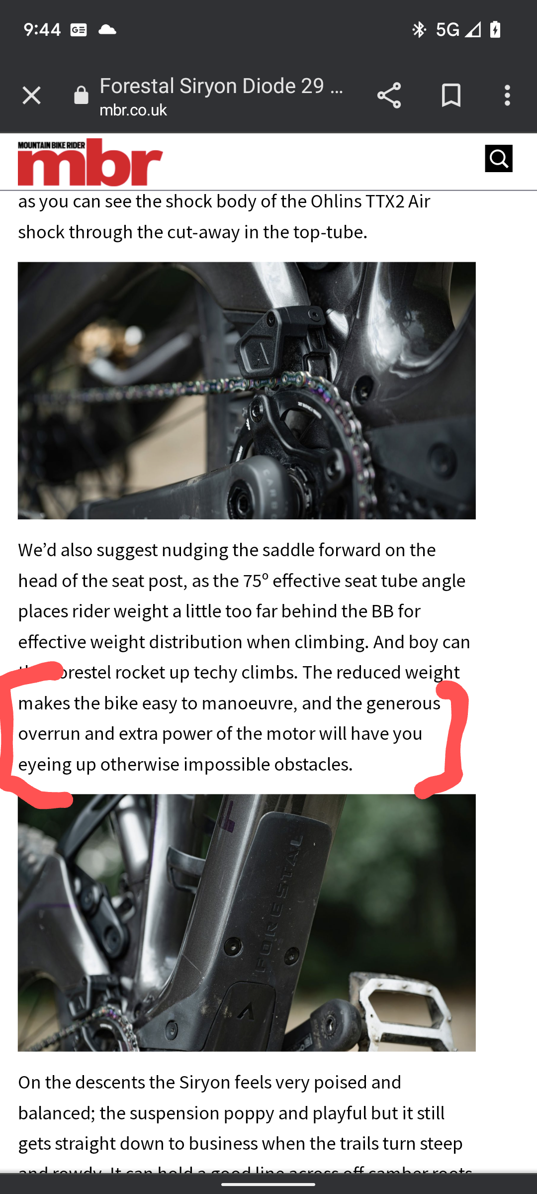

Goods news on M820-60 (EonDrive) power when comparing the Forestal Siryon to the CEF50'S M820-75.
Key point: It is good! 😁
This from a reputable review a few months ago. See link for the full review.

Mesa, AZ
Better news on M820-60 Forestal's 360 Wh battery compared to the M820-75 410 Wh. So, good move overall....another 50Wh will help, especially with another 15Nm of torque!💪
But still, pro/con depending on terrain, rider load, and prior fitness. Flatter vs. Higher elevation gain. Heavier load vs. lighter load. Also, your baseline fitness. Nutshell, lighter, more fit riders, doing flatter terrain should benefit most from the 50Wh battery capacity upgrade!

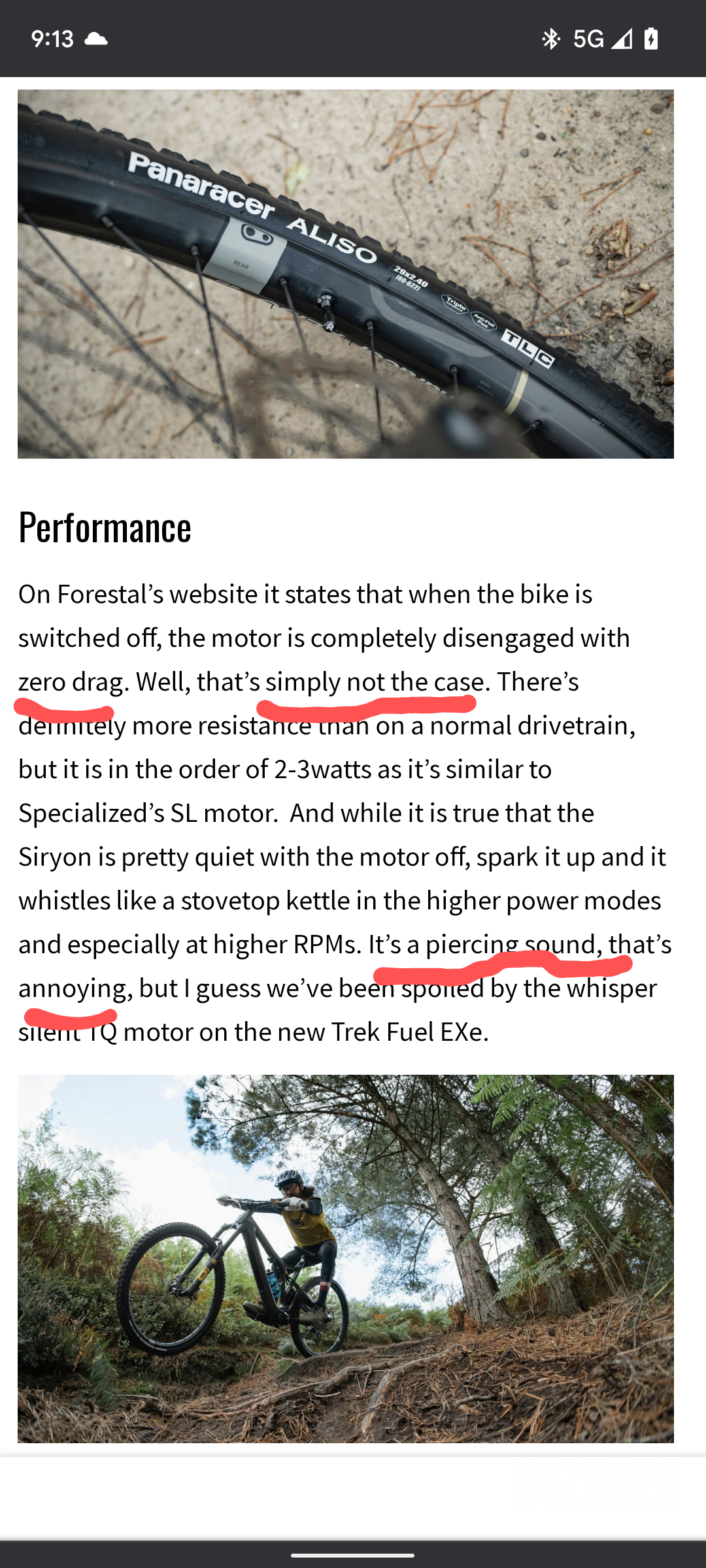

Not so good news and realistic news! Good news is that power off "mode" generates low wattage on spin friction...not zero, but very low.
Another independent reviewer likened the TQ50's zero drag felt like pedaling lower PSI or flatter tires. I agree.
My subjective experience was that TQ50 felt slightly flat, the Fazua60, slighter more flat, and RS60 slightly, even more flat. Let's hope the M820 does mirror the TQ50 🤞
On the pragmatic...silence vs. noise. At lower to mid power modes, even full-powered tend to be fairly quiet. The TQ50 makes noise, but barely. The Fazua60 and RS60 are pretty quiet as well. Given that 10Nm of the latter exists it makes sense that a little more whir/whine is inevitable from physics.
Now the M820-60...turbo and superburst modes on the other hand may require some noise tolerance adjustment or earbuds to cancel out to metallic screeching?
See a compelling Emtb Video reviewer of the "screech" in higher power modes. Cue it to about 4:55 min to listen...sorry but it's weird and a little idiosyncratic.

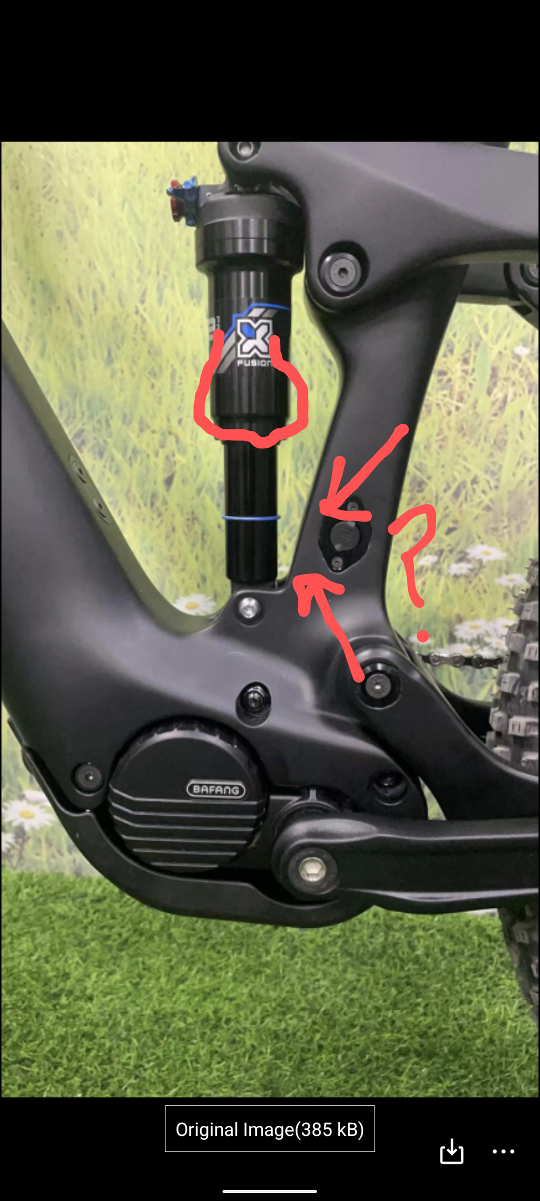

But first thing I'll do is fit my MegNeg out of the box when frame arrives. My backup was going to be the Fox X2...so that should show you my confidence level.
I am looking at used Fox x2 210 x 55 rear shock.
Will that fit?

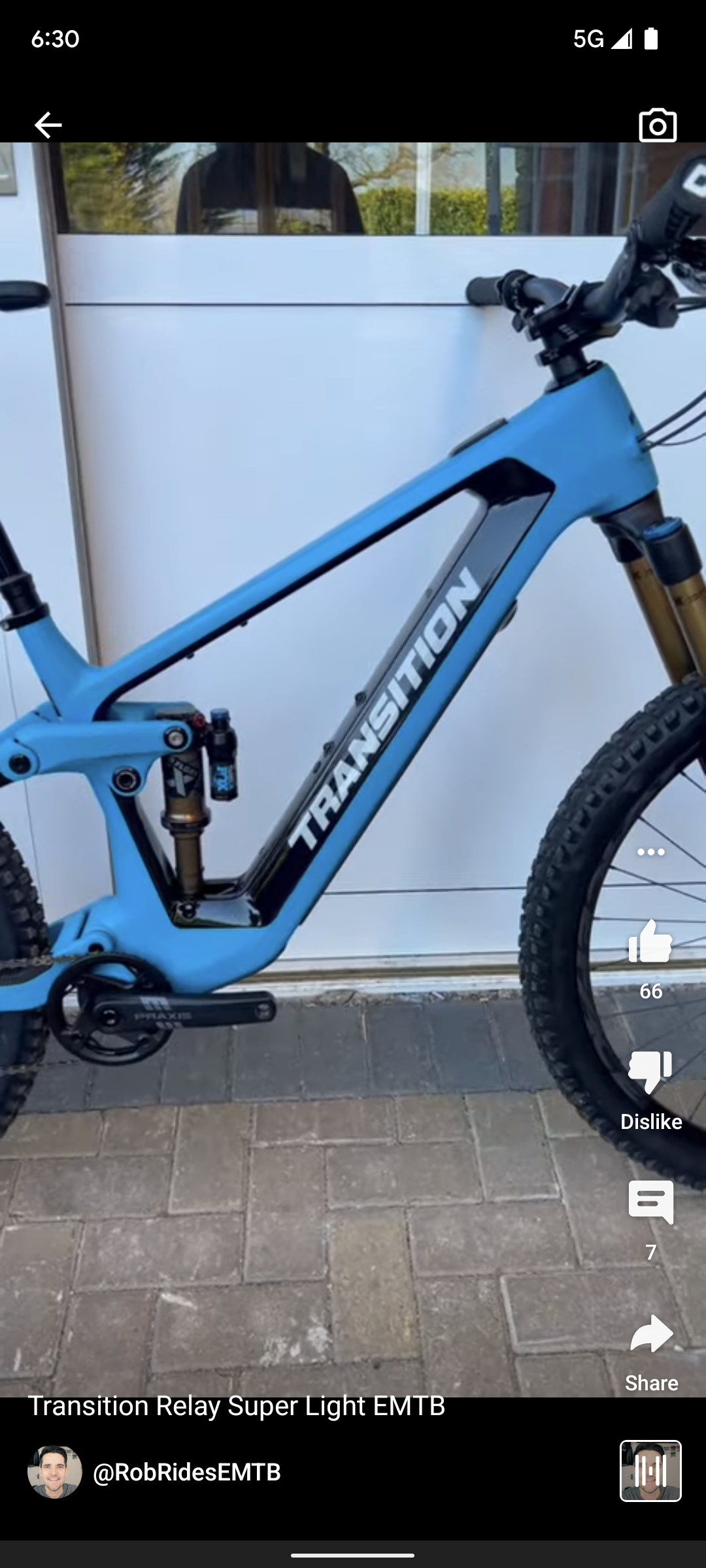

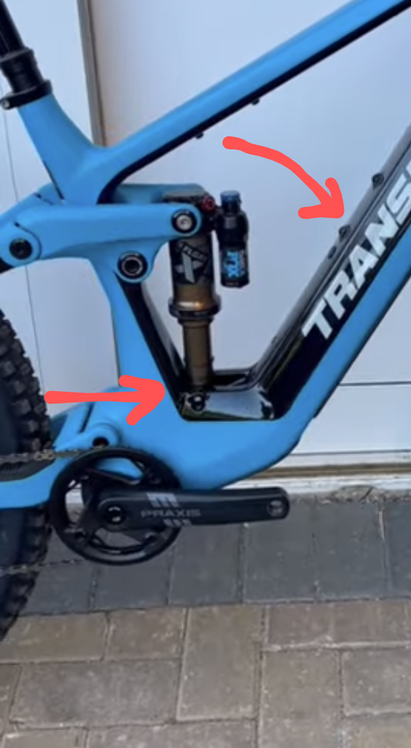

Here's the Transition Relay. It has a similar shock set up. See how similar it's the CEF50'S? The rocker arm should push the rear shock out forward and down in a compression arc, clearing any friction points away from the seatpost. It looks to be an optical illusion.
If not Relay testers/reviewers like RobRides and others would have definitely said something. So, I think that boosts my confidence level a bit, and when I finally get the chance to toss on my fatter MegNeg air can as soon as my frame arrives... hopefully!🤞

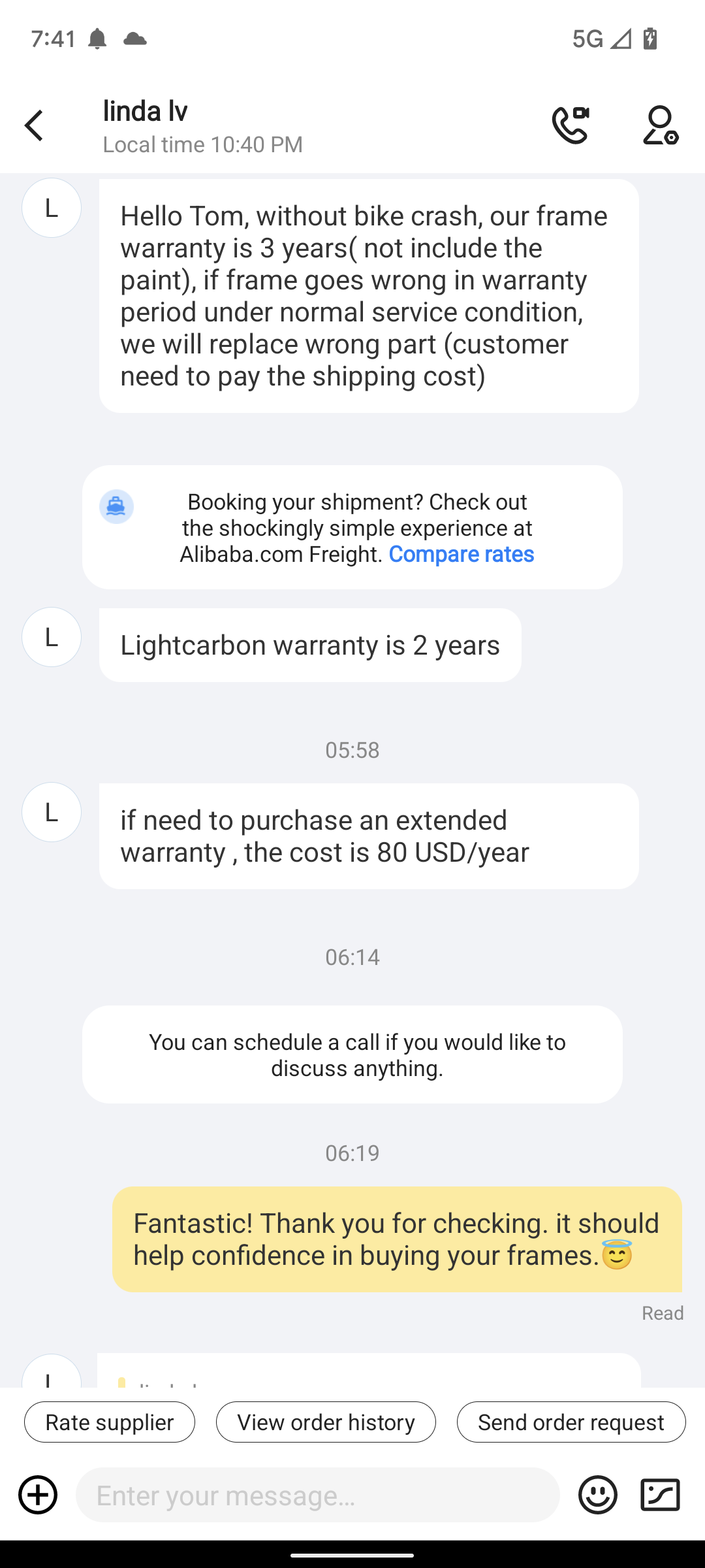

DIY Frame warranty: elephant-in-the-room? Mentioned here in recent previous threads is the CEF50'S light-weight frame. And the 3-year frame warranty. Most of us buying direct consumer or DIY carbon builds acknowledge that quality control lacks, support lacks, and warranty lacks compared to the big brands.
Consider these arguments. Many if not most high density carbon frames in the world are fabricated in mainland China, and the big brands use them! Orbea and Kelly appear to make theirs in their home countries, as well as a few obscure others.
What stands out is little to no field-testing and quality control...the DIY builds take a certain amount of courage to be among the first to spend precious resources on an untested product.
As others with previous DIY build can attest to, customer support really has improved after purchasing their products with some of the better-known Chinese frame manufacturers like DengFu and Light Carbon. RobRides really held the DengFu E10 frame accountable along with the Bafang m500 motor. He should be able to do the same the M820 LCE930 light weight build, as well.
Sure, I wish the frames could be lifetime warranty like Forestal, Transition, and Orbea, just to name a few. Their field-testing is unparalleled. Probably why forums like this tend to help bridge the DIY communication gap better. Very few legit Bafang YouTube reviewers out there unfortunately.
While the CEF50'S warranty is only 3 years, sometimes an extended warranty can be purchased. I'll ask to see if they might consider an extra 2-year extension upgrade for an nominal additional fee. I encourage others to inquire if interested. The more that inquire, the higher the demand, the more likely it will happen. A 5-year warranty has nicer degree of confidence.
The linkage is pretty different between the two. I imagine the leverage curve would be substantially different as well.
We're talking just about clearance of the aircan during compression from the actual seat tube near the mount...not spring rates or leverage curves. It looks like there might have been contact but it's a visual distortion. It should clear the front part of the seat tube.

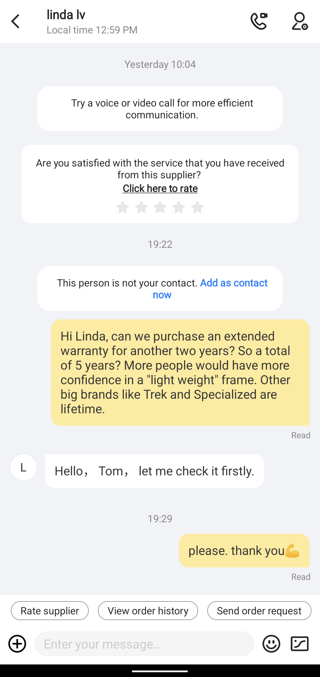

Here's my request to Linda about buying a 2 yrs extended warranty option.

Good news if you want an extended frame warranty. Linda said an extra year of warranty will cost $80 USD per year.
I bought two more for $160.
I feel that 5 years for a total warranty will give me more confidence in case of frame break potential not under crash conditions.
Hopes this helps if some are worried about frame integrity.💪
Contact Linda for details if interested.
