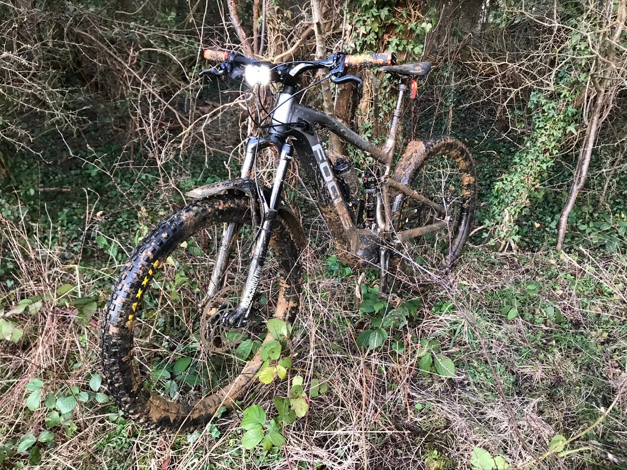

It isn’t small, that’s for sure, but then it’s size is one of the reasons it provides such a good beam pattern.
Here‘s a pic of it on my bike, not sure if it helps. That’s with the 3D printed mount, which is similar to the factory metal ones with regard to position. On the inverted go pro mount, it’s out front a bit more but lower, I think I prefer the go pro one to be honest.

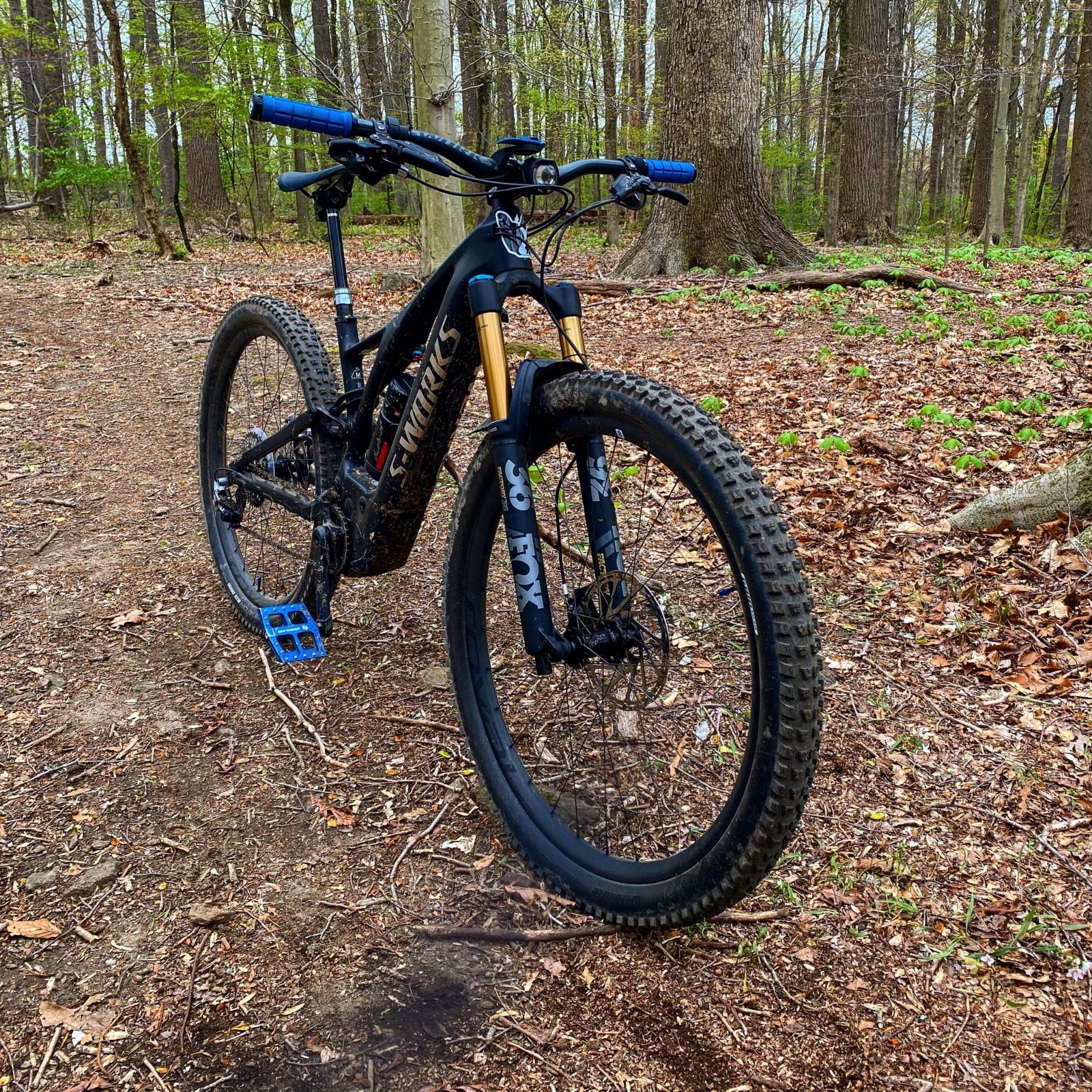

I love mine

You can doit yourself. I’ve installed two

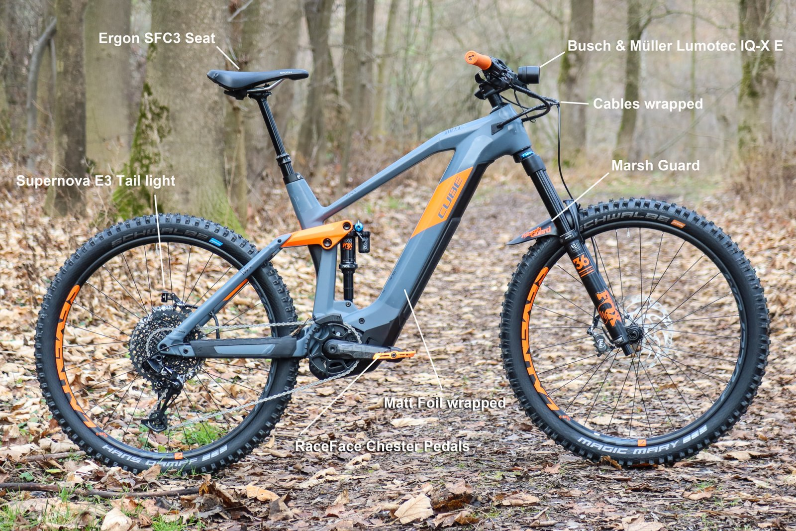

If you are interested, I have the B&M IQ-X E on the front, and the Supernova E3 tail light.I have a light switch on my Bosch Kiox. Not sure how you would do it on Specialized.

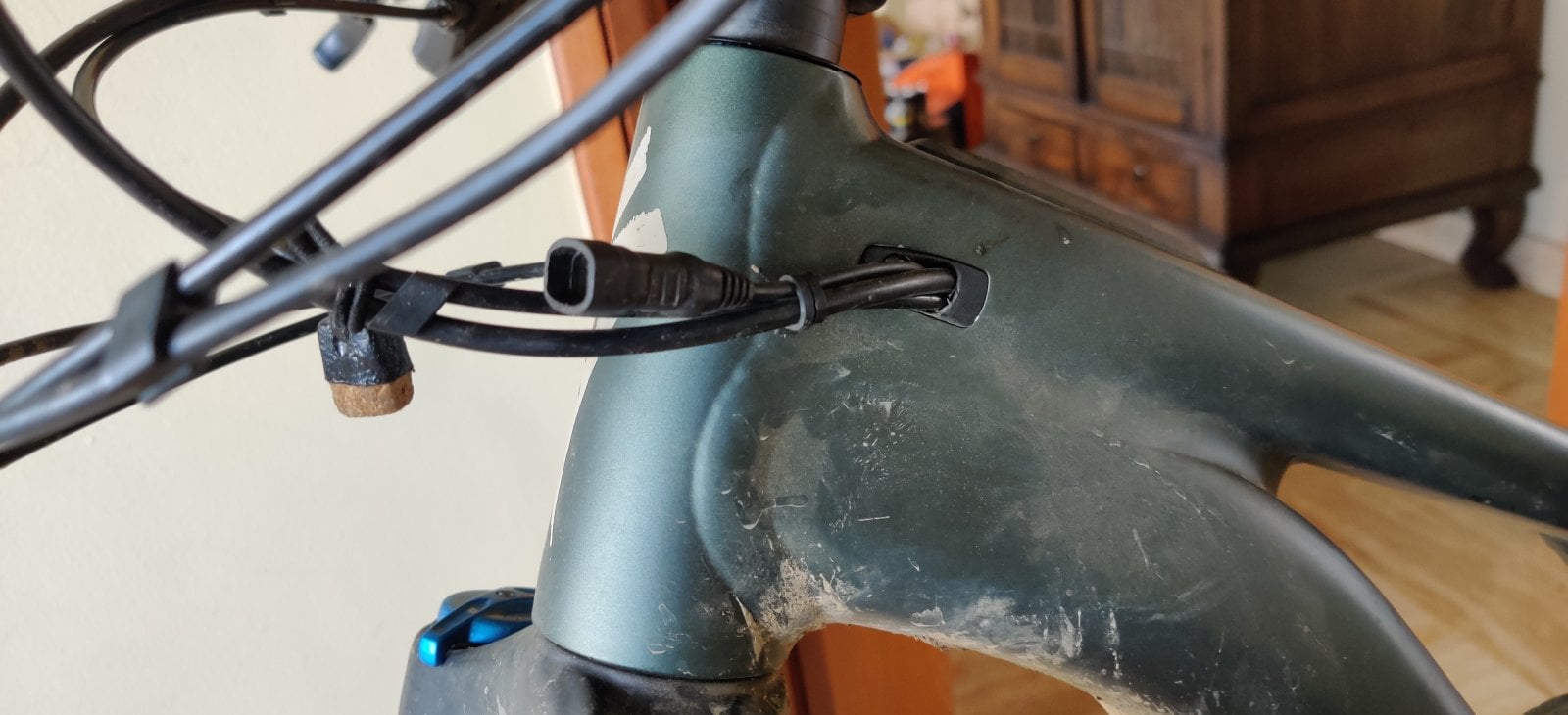

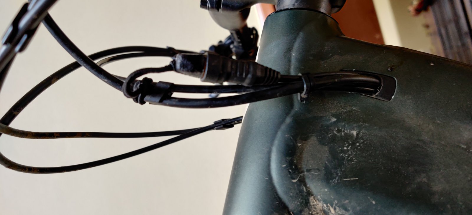

I bought a Lupine cable for Levo and hooked it up to an old Magic Shine light I had. Running the cable through the bike was a lot of work but in the end works flawlessly. I cut and used the battery cable plug from the magic shine (it was bad anyway) so that I can unplug it and carry it in my backpack when not in use. You never know when darkness will catch you offguard.
Sodered the cables and stuffed the excess cable inside the top tube. Had to trim a little with a Dremel the plastic exit port to make the cable fit with the brake and other cable.
I even made a blind plug for the connector when not in use... from cork, a pony tail band and some black liquid electrical tape.

Same here, took awhile, on the Alloy had to loosen the motor mounts to get the cable through. Also removed the TCU to solder the cables and get them through the exit port.
I think with the Carbon frames it's easier because it has routing tibes inside.

The carbon frame is a breeze
