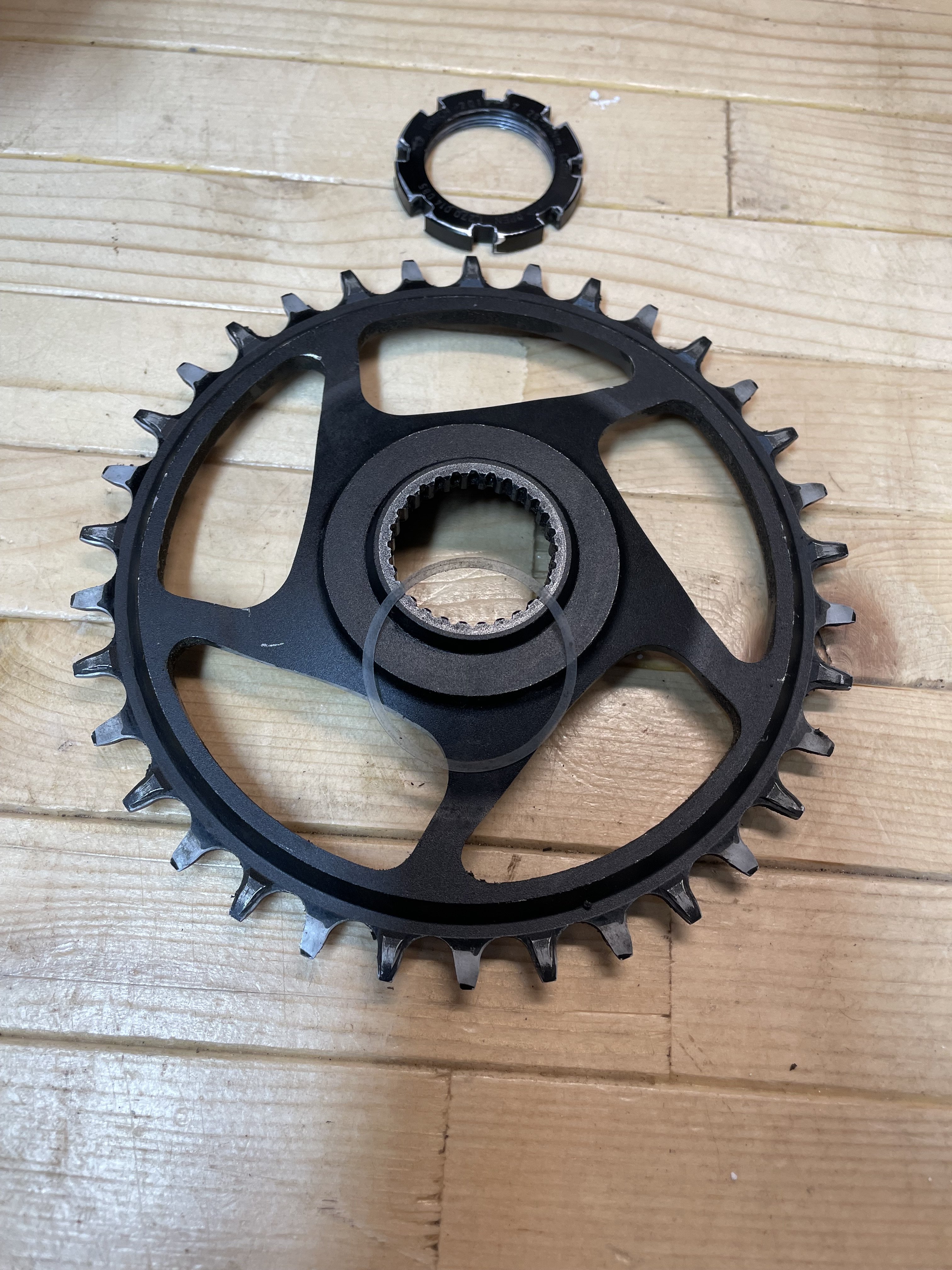

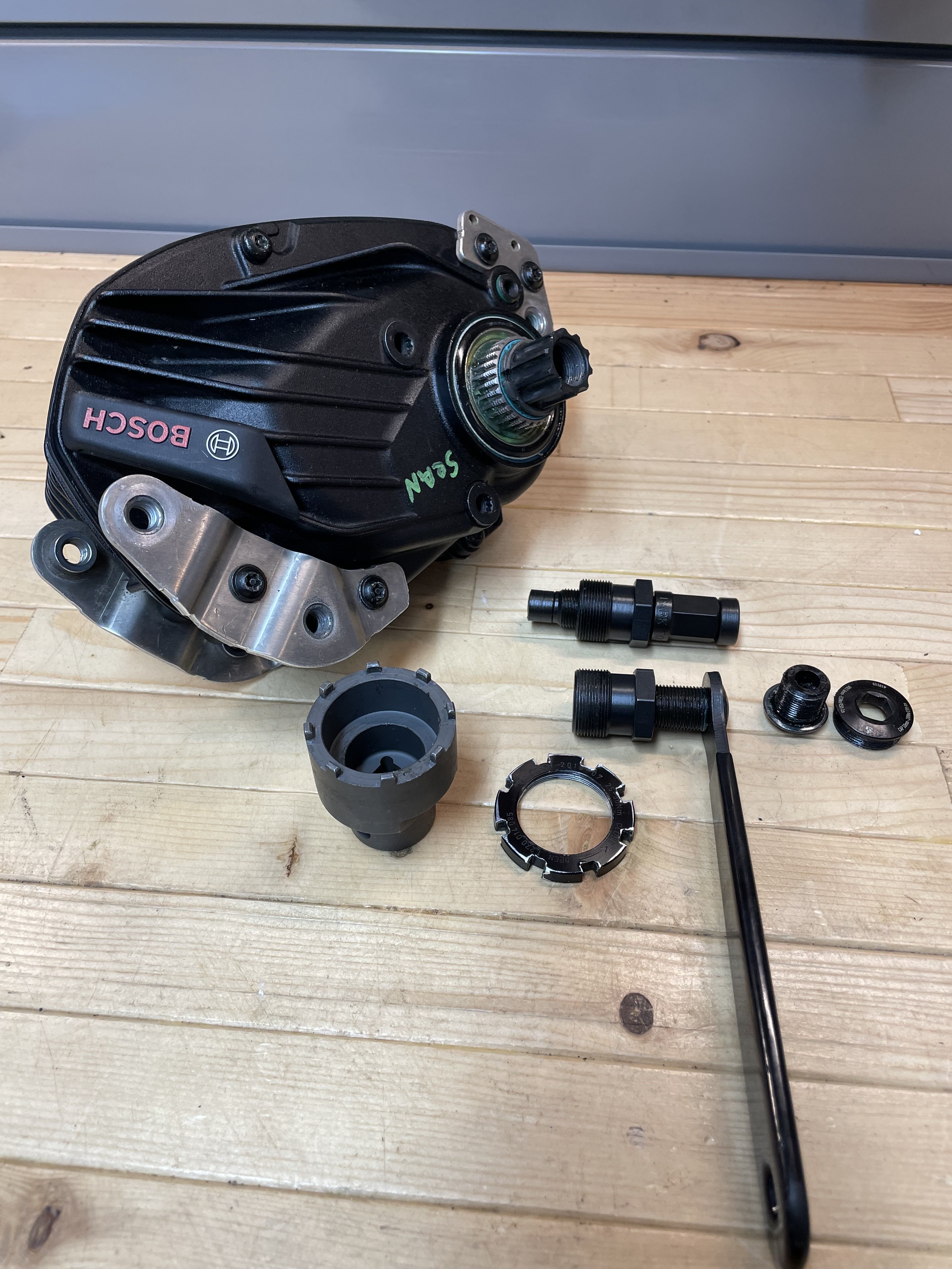

I always thought that the torque could be increased slightly for this nut. I’ve removed it several times on different bikes especially when replacing a chainring or bearing seal kit.
My first attempt was a little difficult because my bike was suspended and moved around. Besides the left-hand thread, the castle nut removal tool would slip. There is a tool available which insures proper and secure attachment, but it’s expensive.
A rubber “O” ring was not installed with the original nut. But a brass “O” ring was along with a thin plastic “O” ring. When I installed an ethirteen chainring the chain alignment was incorrect. I had to remove the brass “o” ring and only use the thin plastic one. The ethirteen has an integrated spacer, or “o” ring.
I added a small amount of blue lock-tight to the castle nut threads and torque to the correct setting. That worked fine for the life of the chainring.
After removing the castle nut several times, this aluminum nut became slightly damaged. It’s very easy to accidentally cross-thread. The threads on the castle nut may have been stretched after repeated torquing. (After all, it’s only aluminum).
I’ve ordered two castle nuts. One as a spare and one as a replacement.
When I removed this chainring I discovered that the castle nut was loose. IMO the old castle nut is toast. No damage or noise occurred that would peak my attention. But this will become part of my regular preventative maintenance. I’ll watch this more often.
