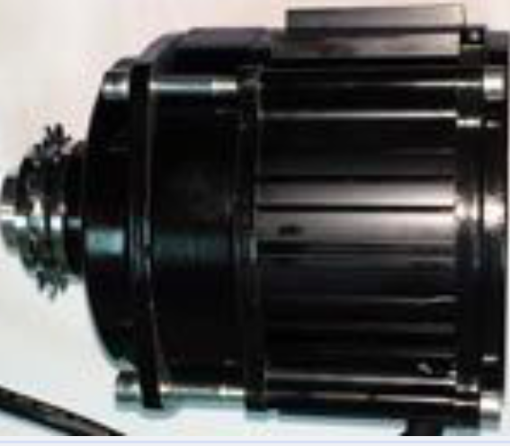

What motor is it? It seems different with the double chain setup.
Looks like the same type used with the Cyclone kits that however use a freewheeling crankset and feed into the drivetrain which as 1500-3000w can eat drives in a hurry.
The above has a 6:1 reduction and is a brushless motor. It is interesting that this bike uses a separate chain line and that is actually a good way to contain the torque but you might not want to over oil the chain and have it spit on to your rear rotor.
When I first saw it I was suspicious of it actually having a PAS but obviously it does somehow which is a good thing. It does have a throttle also however and that is not a bad option either as long as it has a decent PAS which watching the video is seems to.
The red flag though is the size of the battery. It looks about on par with the 500wh ones or perhaps a bit larger and pulling that many watts with that much power the Amp demand will be significant so I wouldn't expect it to have much range? The battery is small enough to carry along another but still wouldn't expect a long day in the saddle to be possible. But it will be interesting to see how the OP's bike gets along.
