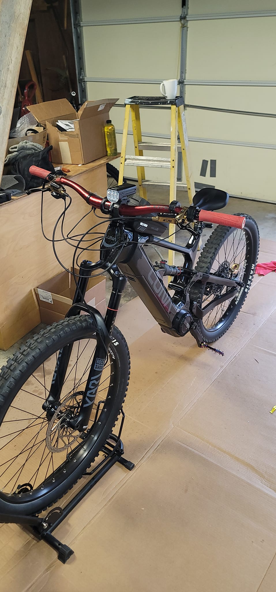

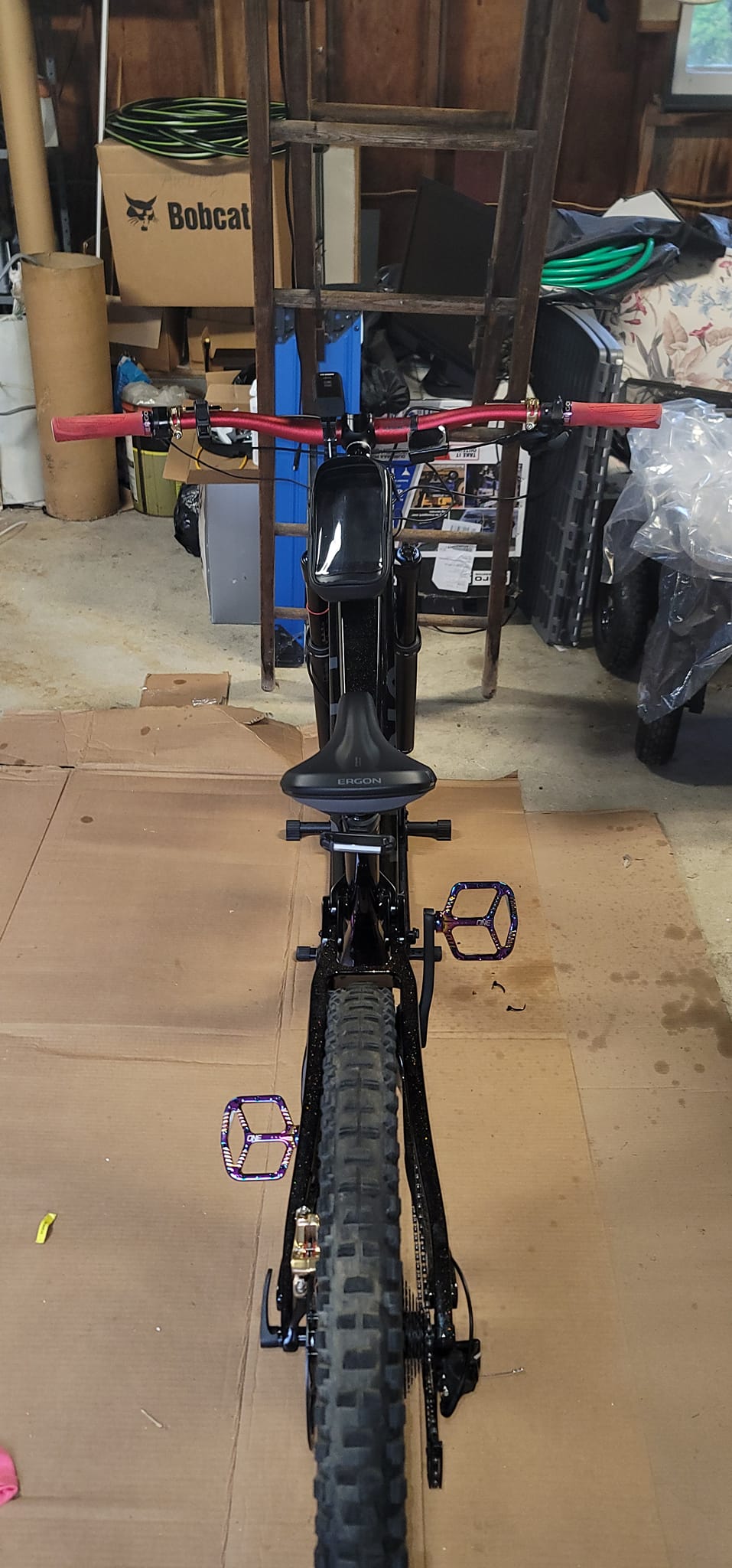

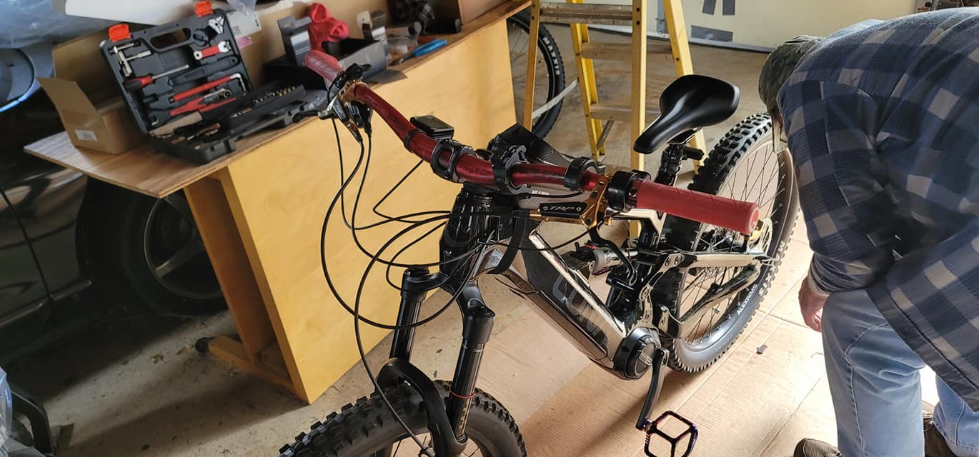

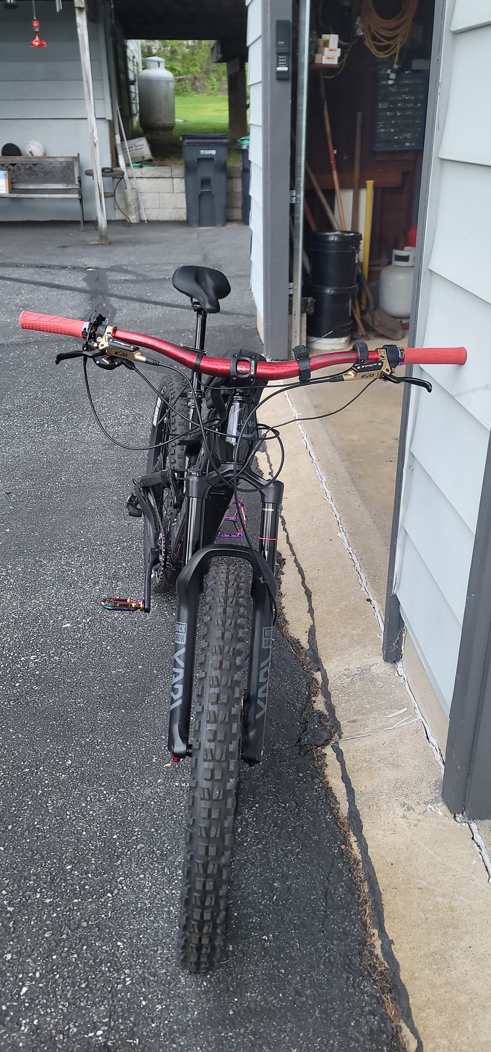

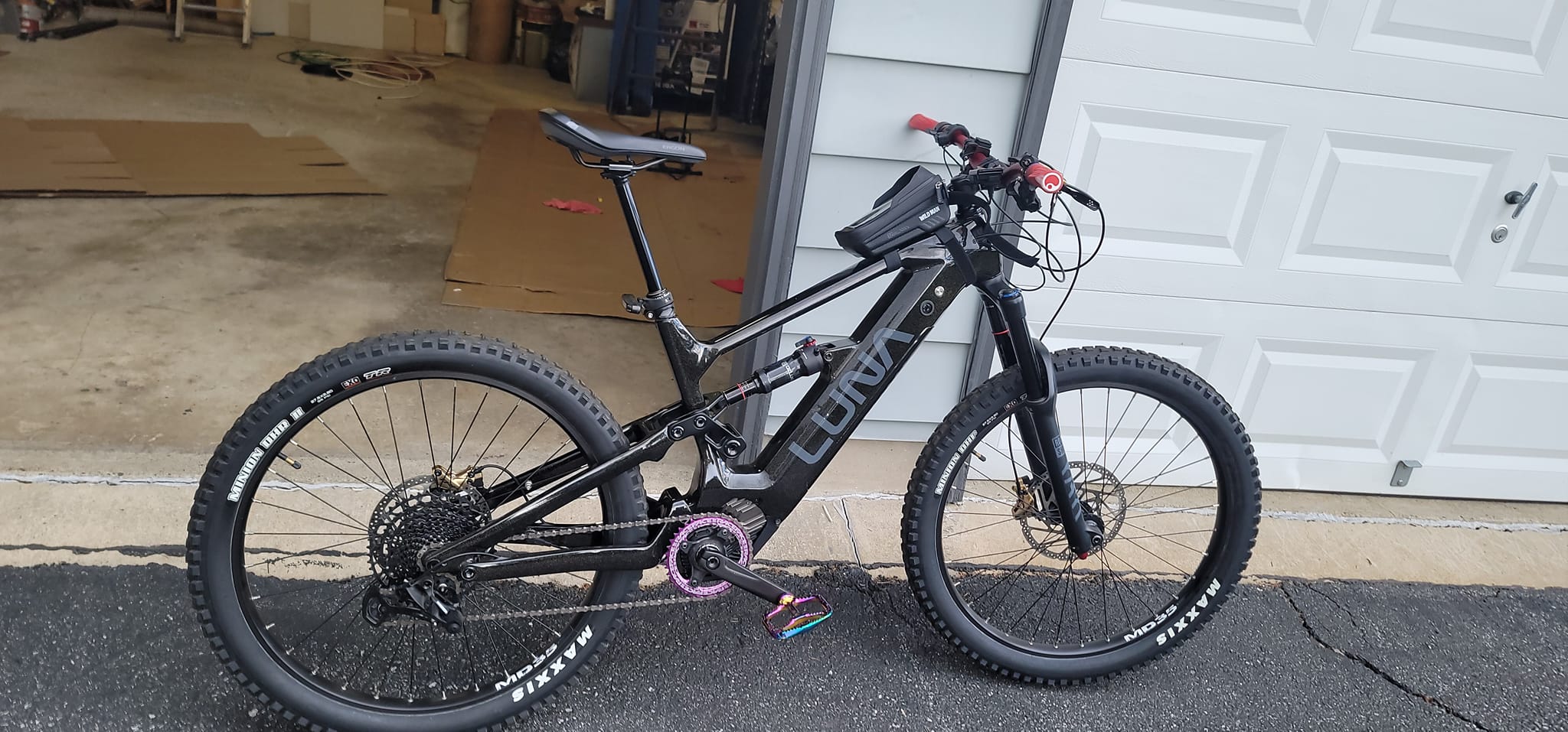

Beware who you listen to, I recommend doing what I did and calling each Hub Manufacturer & if no phone number e-mail Technical Support & sales. I have a Luna Cycles X2 V2 Ludicrous, which is a tuned M600 engine that I normally run between 250watts-1250watts but has a peak of 2000watts(will nearly overheat in about 5miles on throttle only during steep climbs.) at anything over 1250watts) But even ONYX with their SPRAG clutch won't back their hub with my bike. I said what if I kept it at 250watts-1250watts PAS, & tune the throttle down so I have to peddle to 7mph before engaging it, & that Onyx said their classic could handle. But I'd have to upgrade the Steel Race to Ceramic as well. I9, Hope Pro E-bike, Chris King, Project 321, they all said they won't back their hubs with my M600 mid-drive. Spank was the only one who it sparked a lively discussion that took weeks for technical staff to say, their E-bike hub is better than what I have & if I keep the Throttle tuned as I say it is, I should have no problem. But they also said they plan to build an even more ROBUST e-bike Hub for bikes like my Enduro that has 1000 watts or more of power & has a throttle. I have health issues which made me sell my Kawasaki Z1000, & I had to buy Electric Mountain Bike to keep up with my friends on analog. The throttle is for if I have an episode & can't peddle. So Finding Hubs has been Such a hell. I haven't talked to BITEX, or ETHIRTEEN yet. But SPANK HEX J-Type seem to be where I am leaning. The only company to guarantee their hubs with High powered & even higher torqued bikes than mine was DTSwiss. But I want =>100POE. AS you can see I have upgraded a lot but still have a long way to go. But the Raceface sprocket is meant for a bike running a 250 watt Shimano or Bosch motor, not an E-bike. But it's holding up very well. Which makes me believe there may be some high-end hubs besides Onyx that could handle the power & torque of my EMTB at its max. But Onyx won't warranty them on my bike. A guy at FANATIK bike builds, told me to take my wheel off and put it on another regular bike if the Onyx rear hub fails to keep their warranty. But that is dishonest & goes against my beliefs. It's been hell finding quality Hubs. If you find a bulletproof hub besides the 54t DTSWISS(a low POE), looking for 100POE+ please let me know. This hub situation is holding everything up for me. MY Buddy running Norco E-bike runs E-thirteen E*spec hubs. If that helps.
LUNA X2 new Raceface Bar & From front outside5-11-23.jpg LUNA X2 new Raceface Bar & Stem Side View5-11-23.jpg LUNA X2 new Raceface Bar & Stem Upclose5-11-23.jpg LUNA X2 new Raceface Bar & Stem5-11-23  From behind.jpg LUNA X2 new Raceface Bar & Stem5-11-23.jpg
