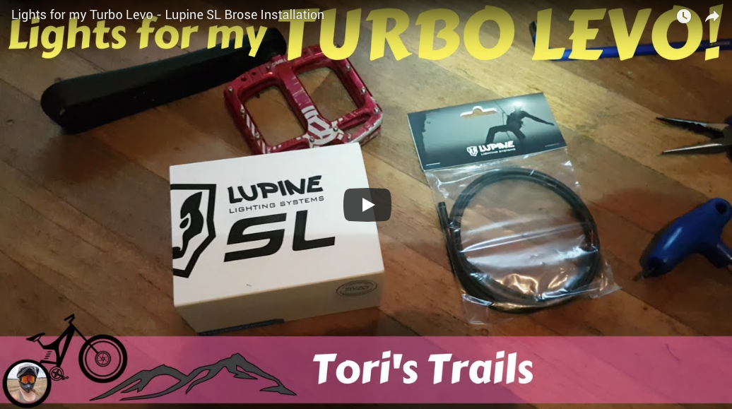

My light kit showed up this week; and I fitted it this afternoon. I've made a short video to hopefully assist anyone wanting to go down the same path:

Here is the PDF manual instructions : https://www.lupine.de/files/manuals/sl_s_bosch_purion_web-2.pdf
There is a switch, located on the bottom of the unit. It's possible to turn it completely off, or otherwise on Auto, Daytime Running, or Night mode.
The Auto works really well, outside it switches to daytime running, and if I put it in a dark room, it goes to night mode.
