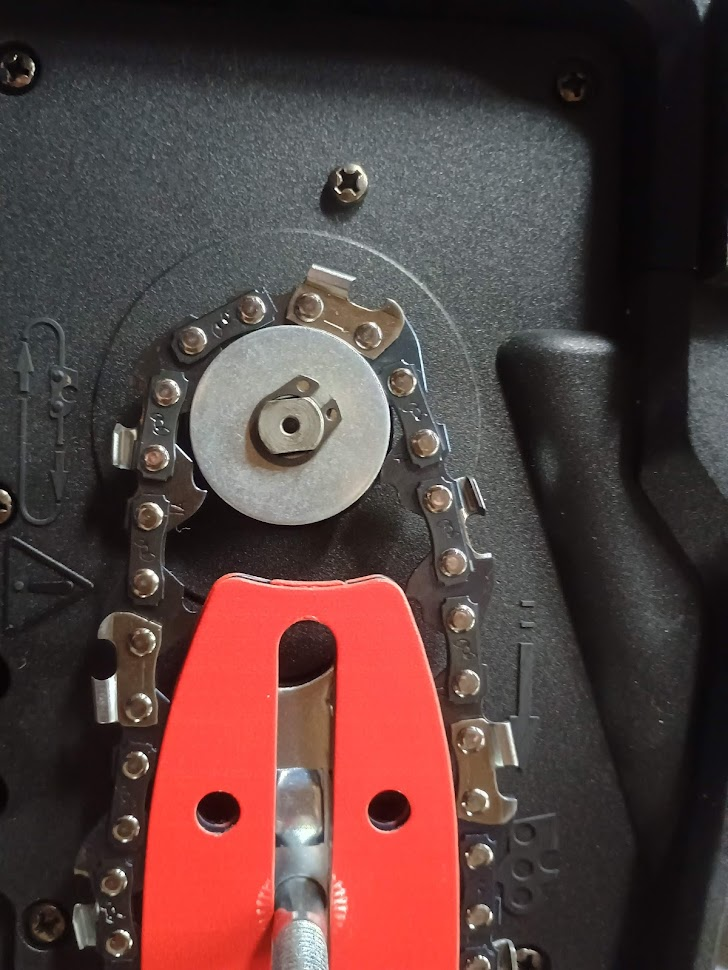

The main issue with the first gen LIDL's saws is that if the chain clamp is at all loose, the chain has a habit of running wide and deforming the washer at the end of the drive sprocket. Then the chain drops into gap and isn't driven. You can pratt about making/changing the washer, but I was hoping the washer would be thicker on the latest version as it's the saws main downfall.
Sadly, it isn't, but it does seem much tigher fitted to the circlip with zero movement, unlike the older ones - so hopefully that will ease the problem. Just remember to frequently check the clamp with these saws.

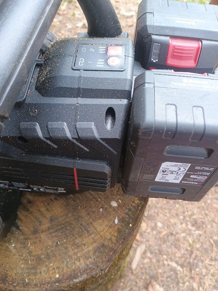

Increased casing protection bumps/anti slip on the front of the saw.
New felling/aiming line on the case :

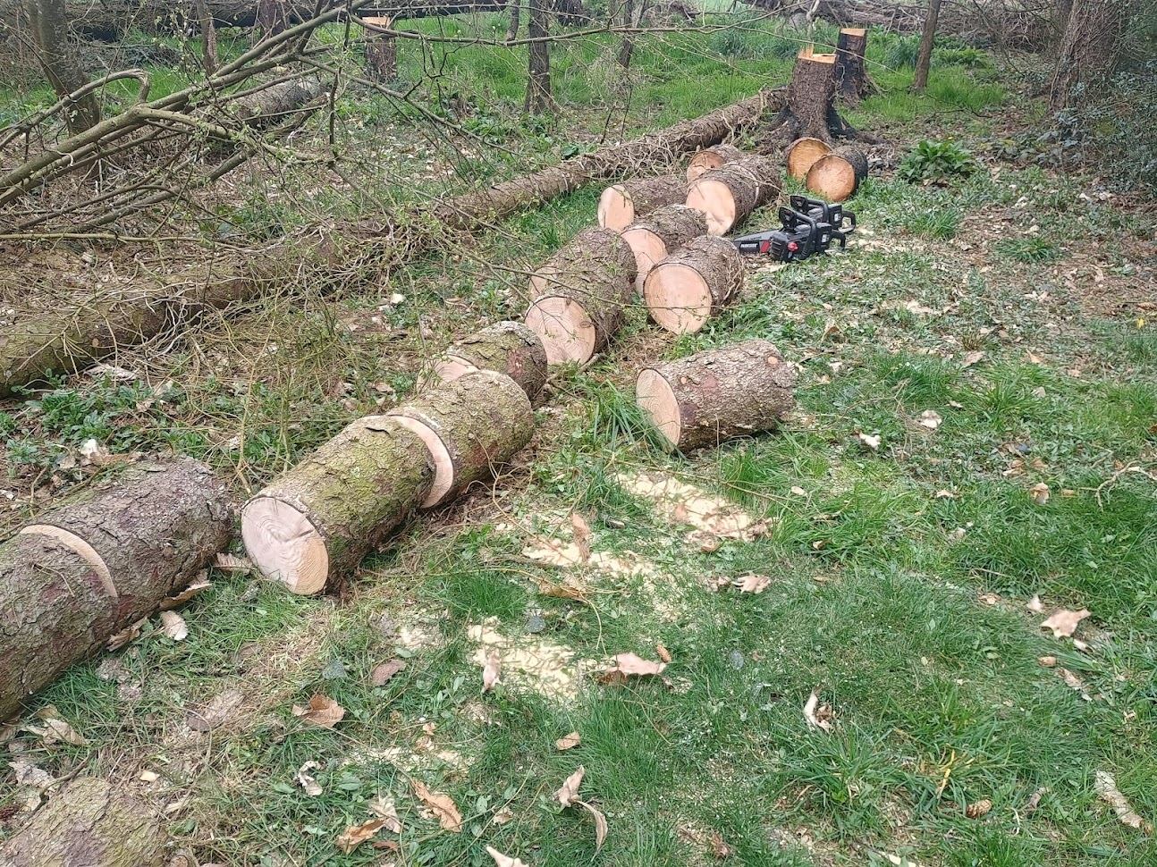

In a few minutes this afternoon alternate cutting with the two "performance" versions :
