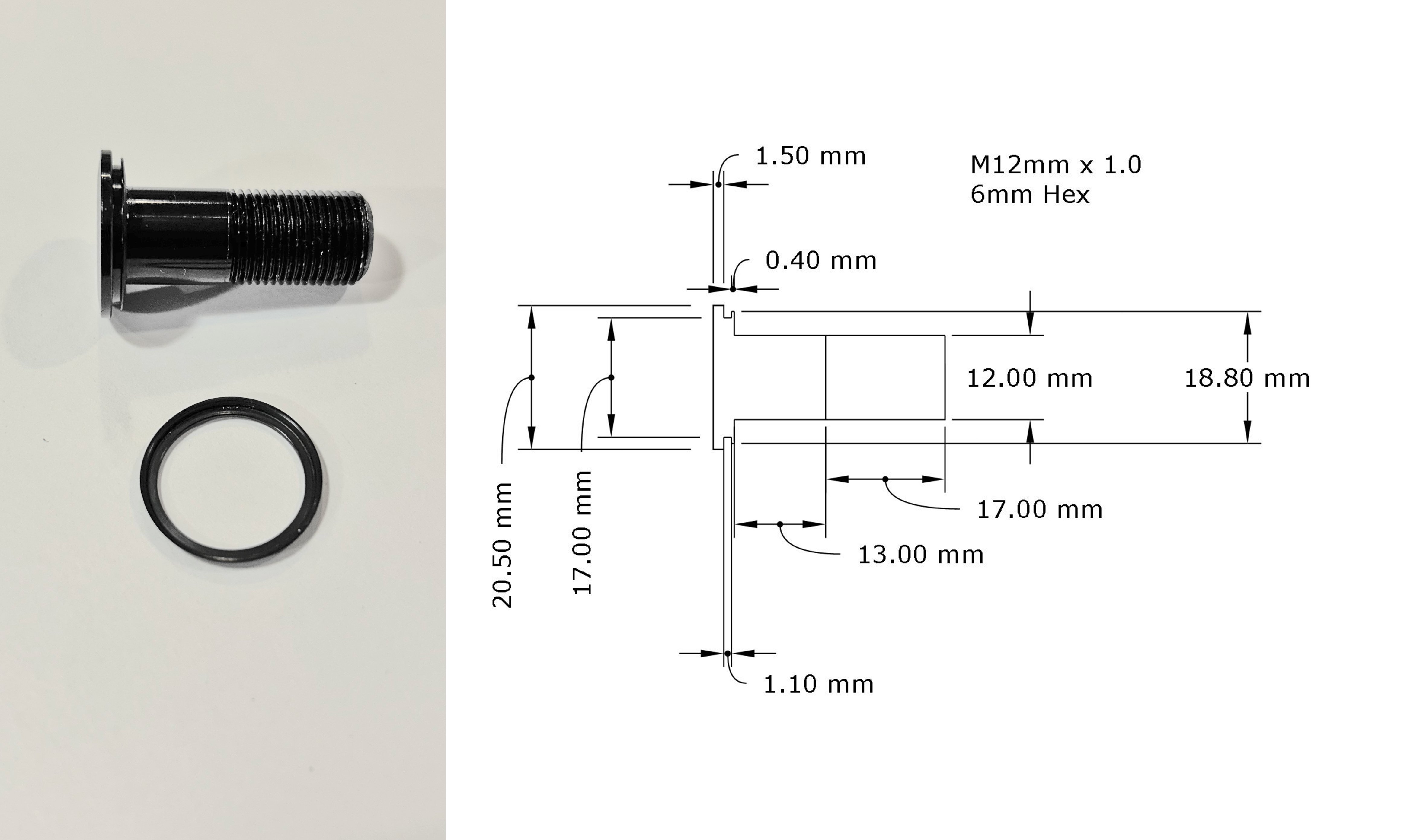

Bloody Specialized only seem to sell suspension bolts in a kit. I've "nearly" rounded of the shock link to seat-tube bolt, as identified in the picture.
The bolt and size is:
  • Shock Link to Seat Tube Pivot Bolt: 12mm W x 24mm L - Alloy - Torque: 185 in-lbf (21 Nm)

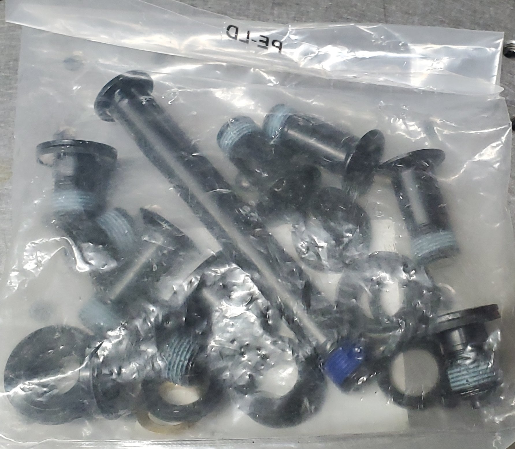

This won't be the answer you're looking for. I suggest getting the bolt kit unless that would mean having to not eat for a few days. AFAIK, all of the parts in the kit are Specialized proprietary, meaning that you won't find them at a bolt and washer store. Having the kit means that losing a washer or stripping a bolt won't mean no riding for a week or more.

I may have one from an older FSR.
Can you get it out and measure thread pitch and shoulder length? (Other side Would be same )

Thanks Weeksy (same as of the STW parish?), I’ll check measurements when I’m home Thursday.

I've emailed these guys about a single bolt, so I'll see if they come back.

Yeah back when i did it on an older FSR i needed a full kit as well. As you say Trek sell singles, as do Orbea, Rocky Mountain to name but a few.

Hi all,
Betterbolts have come back to me and said they will sell me a single bolt at $15, then there's shipping, tax, customs etc. on top of that.
I'm going to order two, if anyone wants a spare (in the UK) let me know and I'll add them to the order. When they arrive I'll amortise the full landed cost over the number of bolts and you can buy them from me.
I'm not looking to make a profit but if someone wants to add a spare then let me know.
