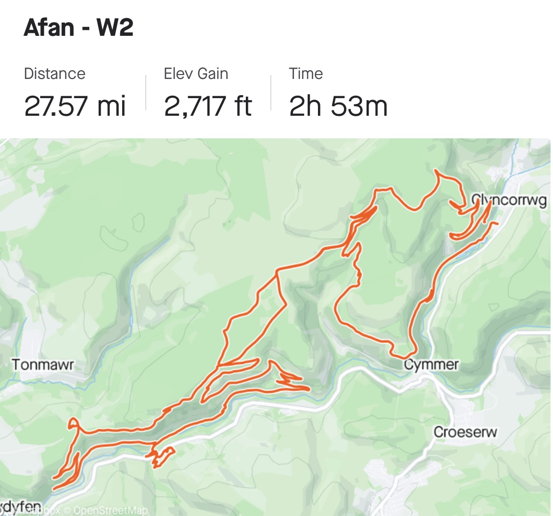

This is the route we done when we was there. As mentioned by @James_C above.
Other than looking at the trail map, no real prep or planning and zero knowledge about the route.
We just headed off and hoped for the best 😂
All on 700wh specialised and 625 Bosch bikes.
Well all got round, some nursed it back. Others were ok.
My battery was nearly done mainly riding on trail. Odd eco or turbo.
Can’t say how frugal you are with an SL but The above may help in terms of miles / elevation
