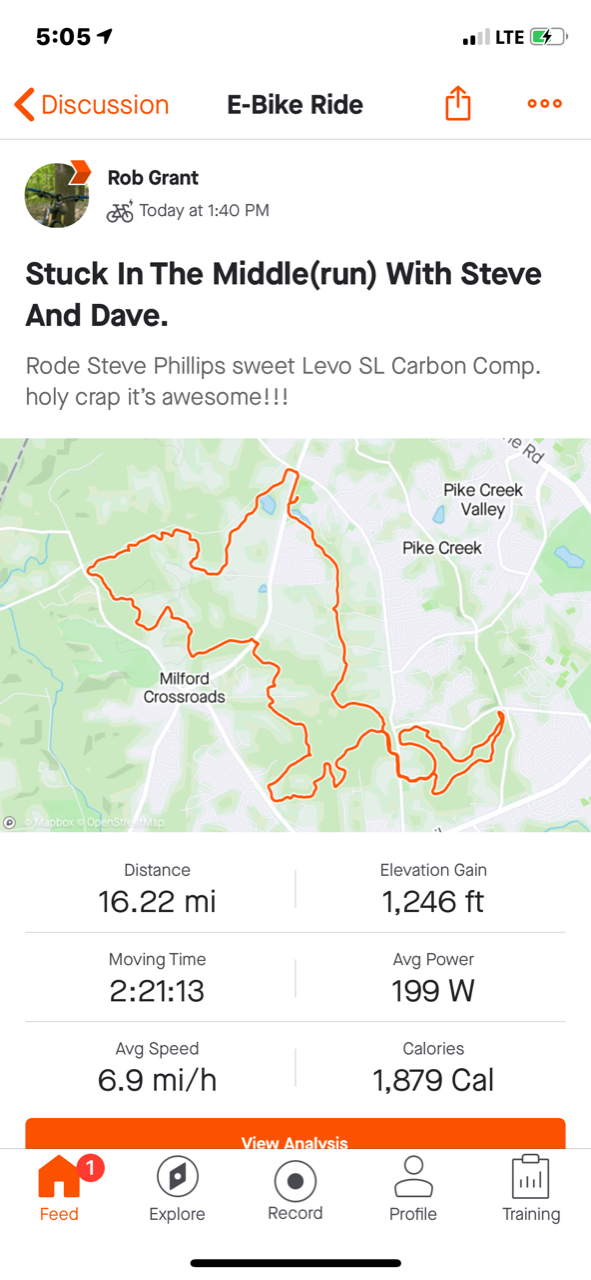

Rode 16 miles, climbing almost 1300 feet yesterday on a 2020 Expert Carbon SL. I'm 240 and was able to keep up with my buddy on his acoustic who I can NO WAY keep up with on my acoustic bike. I never used turbo, mostly ran in trail which was set at 50%. I used about half the battery. Super impressive. No external battery....

grantini
May 7, 2019
611
539
Delaware
I'm 240lb and found the SL OK power-wise, but sucked the battery way too fast.
I'm 240 and I banged out 16 miles with 1200 feet of climbing, pretty much all in trail and used about half of the battery.... I don't see myself ever riding much more than 20 or 21 miles, especially with that bike. I was pretty beat at the end of that ride!
grantini
May 7, 2019
611
539
Delaware
If you notice the speed on my Strava, I averaged about 7mph, which is in line with an acoustic ride at that location..... for a relatively fit rider. If I was on the levo I would be closer to 10mph. So it's much more of an acoustic experience

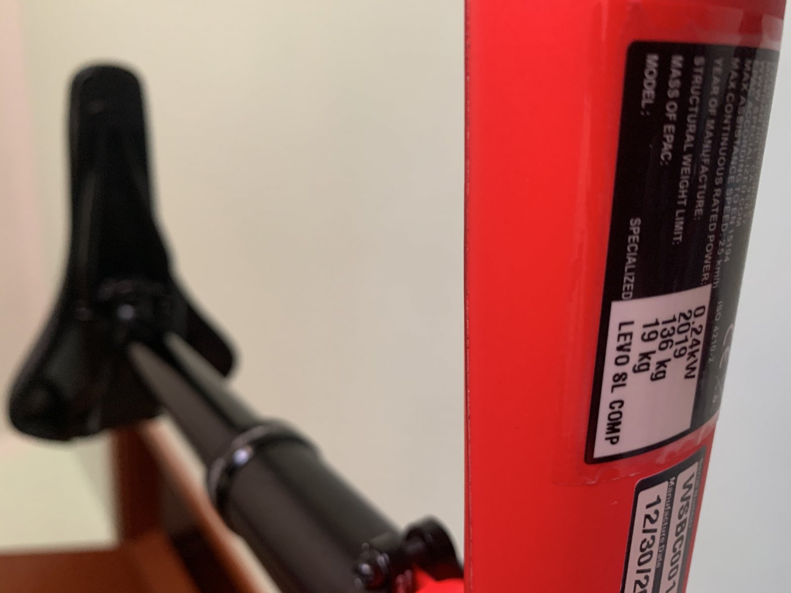

Hello guys ! I have just bought a brand new Levo SL comp MY 2021 , but as you can see from the sticker the year of manufacture is 2019 , and the weight limit is 136 kg. The size of the bike is Medium

Konanige
Feb 29, 2020
422
336
Mendips
Yeah the alloy bike has a higher weight limit than the carbon bike. I think Specialized put a 109 kg limit on anything that is carbon, ie: frames, wheels, seatposts, cranks, bars etc.
