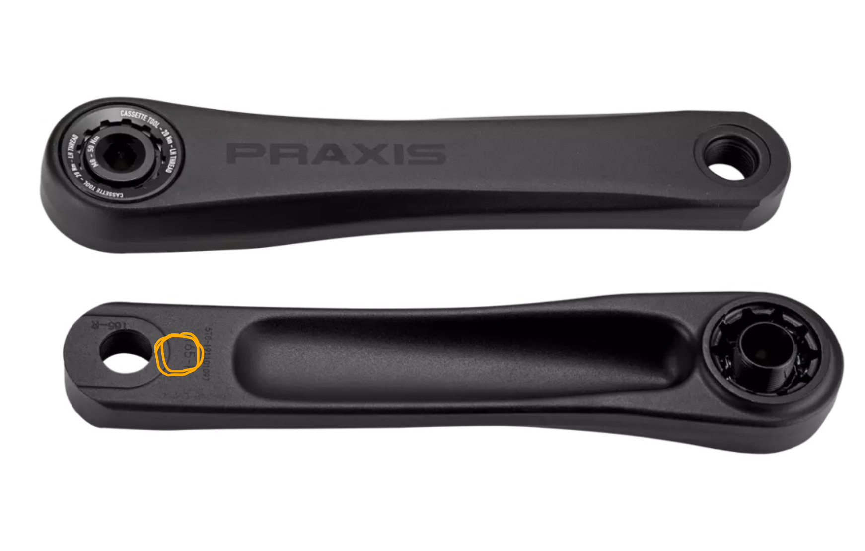

I don't think that would work, especially as the material towards the middle of the crank arm is way thinner, see picture.
And for it to work in theory, you would have to take the longest available crank arm so your new thread doesn't overlap with the original one, wouldn't you?

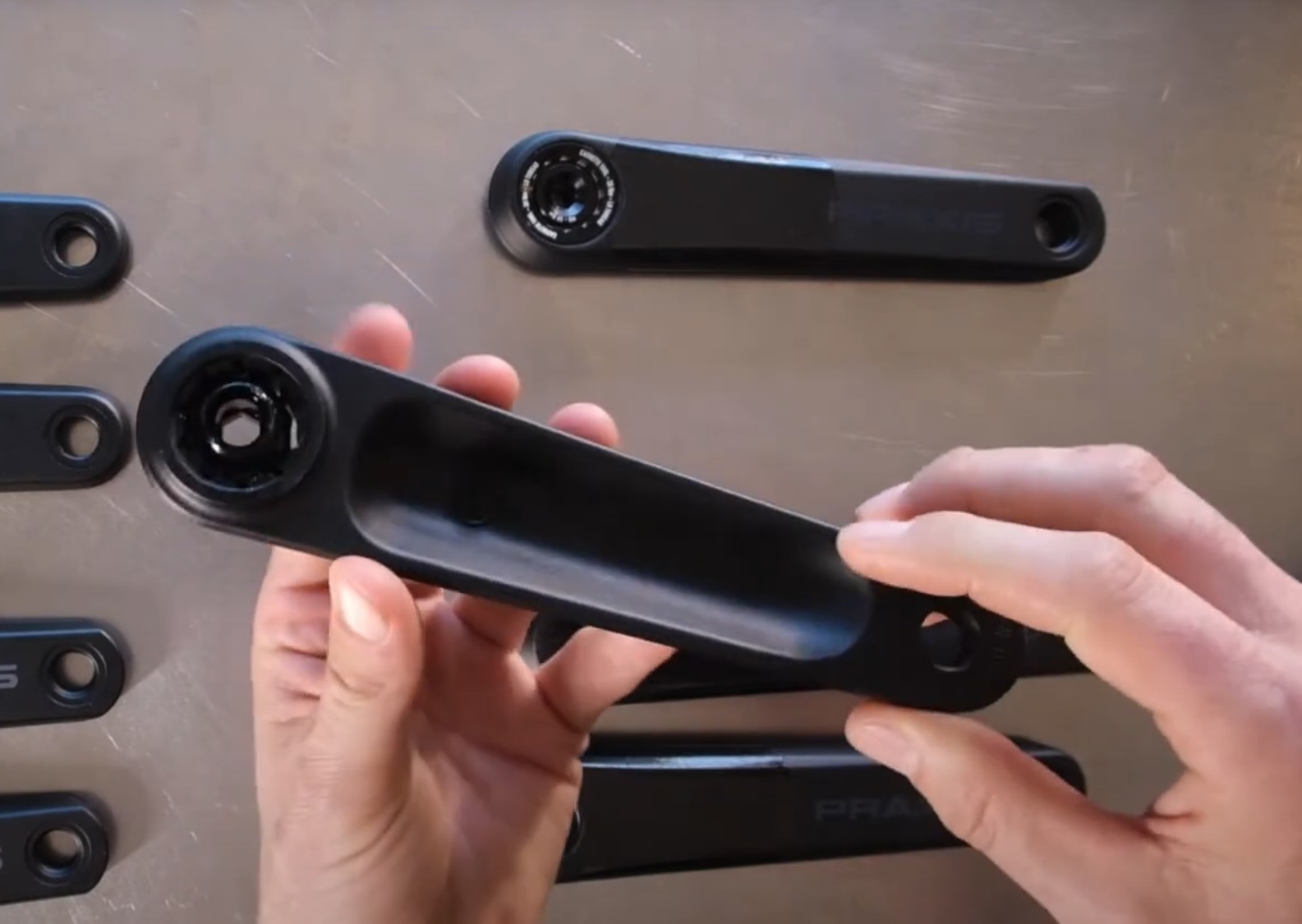

As long as they have used the same forging for all the lengths then this photo of a 165mm suggests that there should be enough material (since the existing pedal hole would be 10mm further out than in this shot). If they have used a different forging for the 175mm to save weight then it will be a bust.

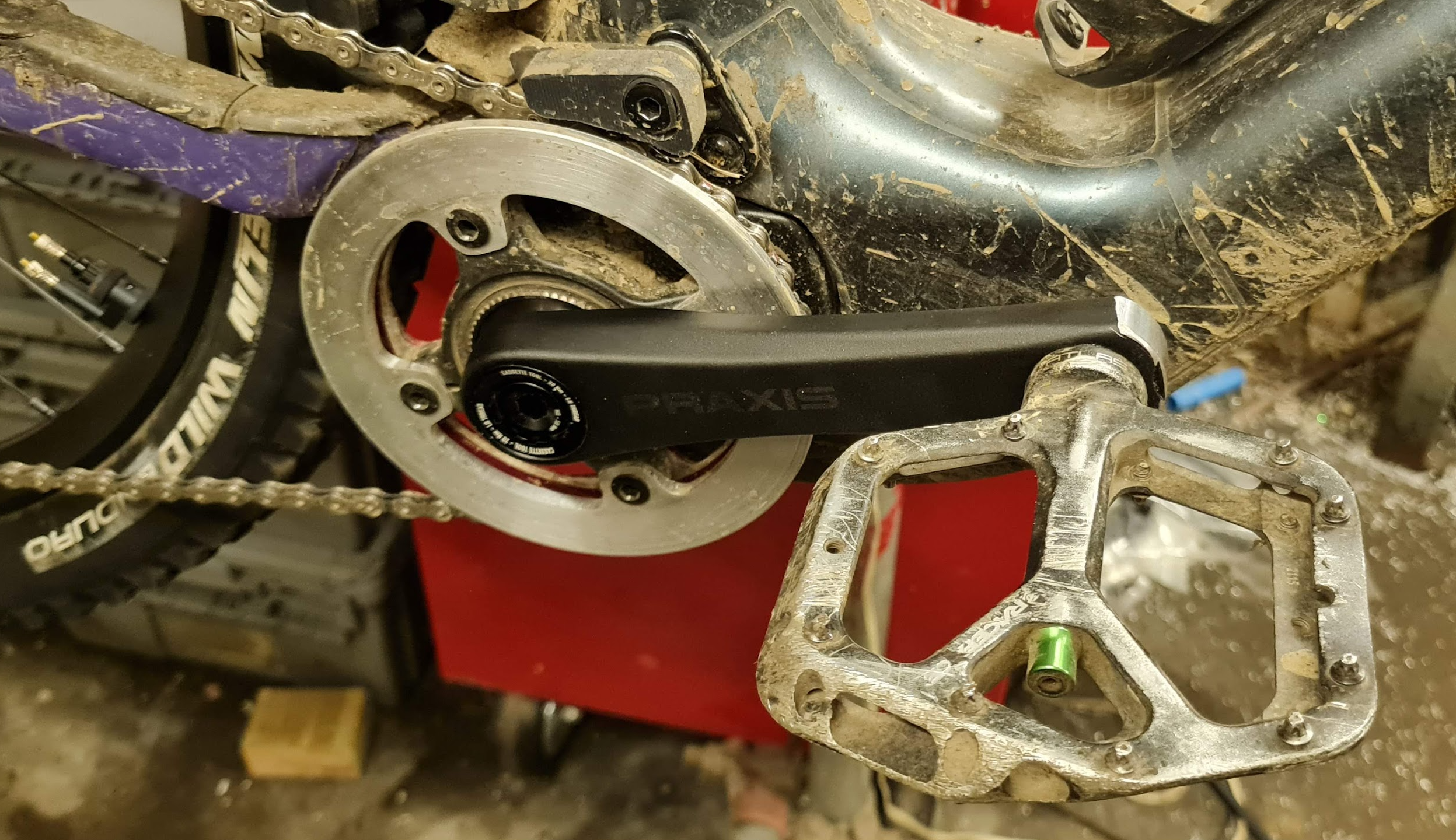

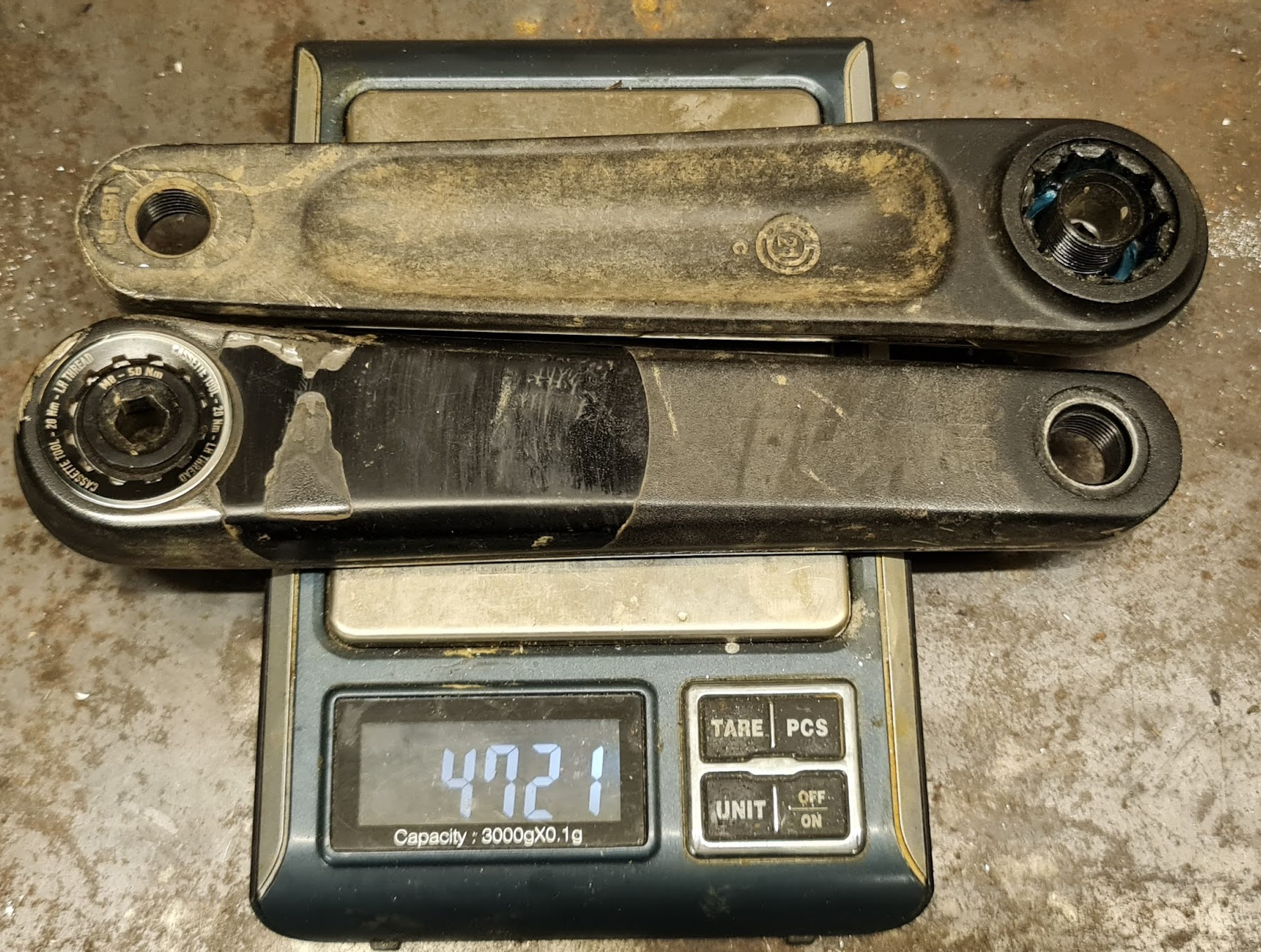

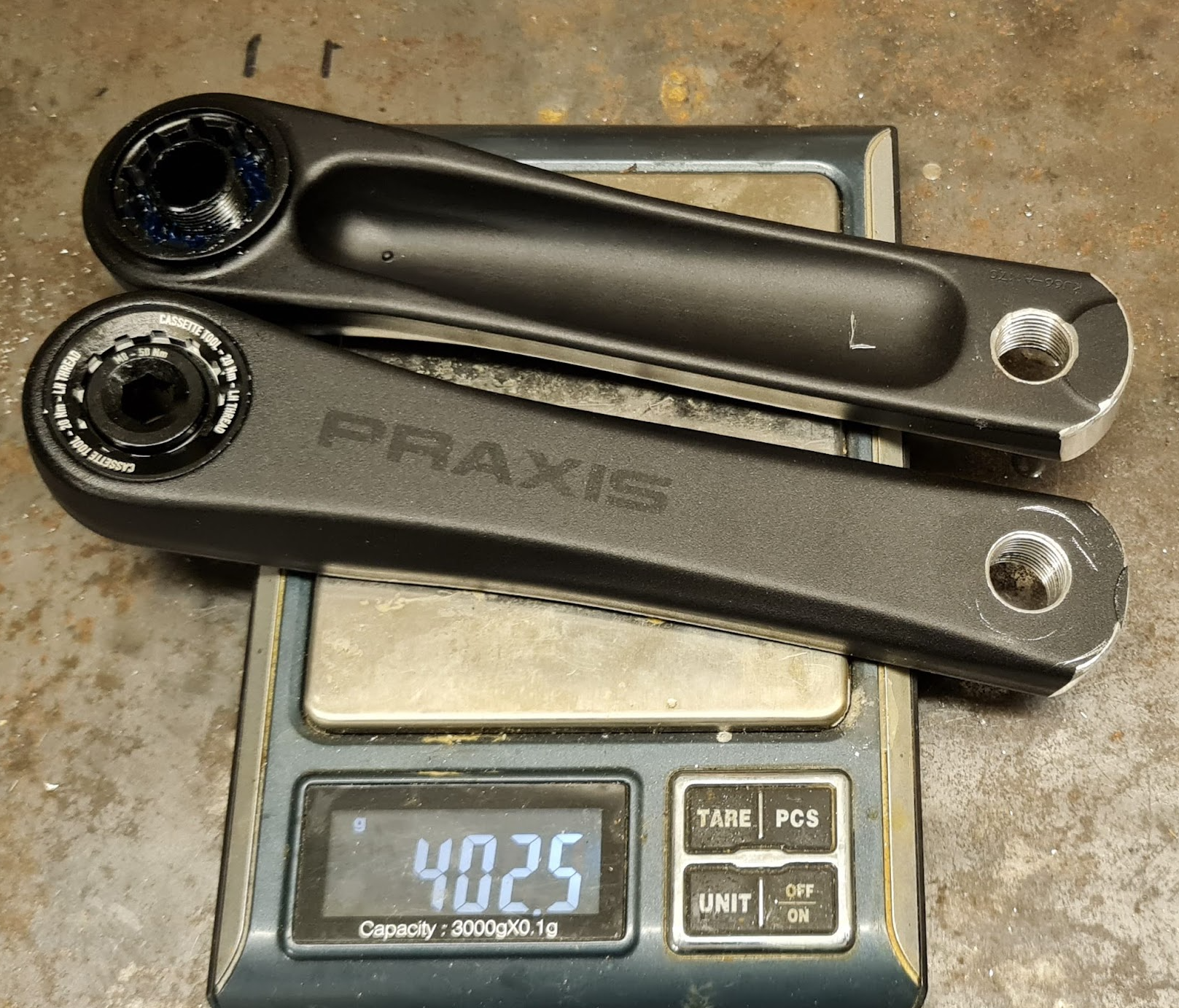

Cranks arrived, they looked good, plenty of space for adding a new pedal hole. Little bit lighter than the stock MTB 165mm ones but since shorter means less leverage (in some modes) I think they should be fine once shortened.
So went ahead and cut them down to 150mm.
Very happy with how they came out. Not ridden them properly yet but jibbing about on the bike they feel lovely, I'm very excited to try cranks proportional to my height (5'7" ish).
Probably could have saved a bit more weight off the end but I wasn't in this for the weight saving and the 70g just about balances s the new chain/bash-guard I made last week..

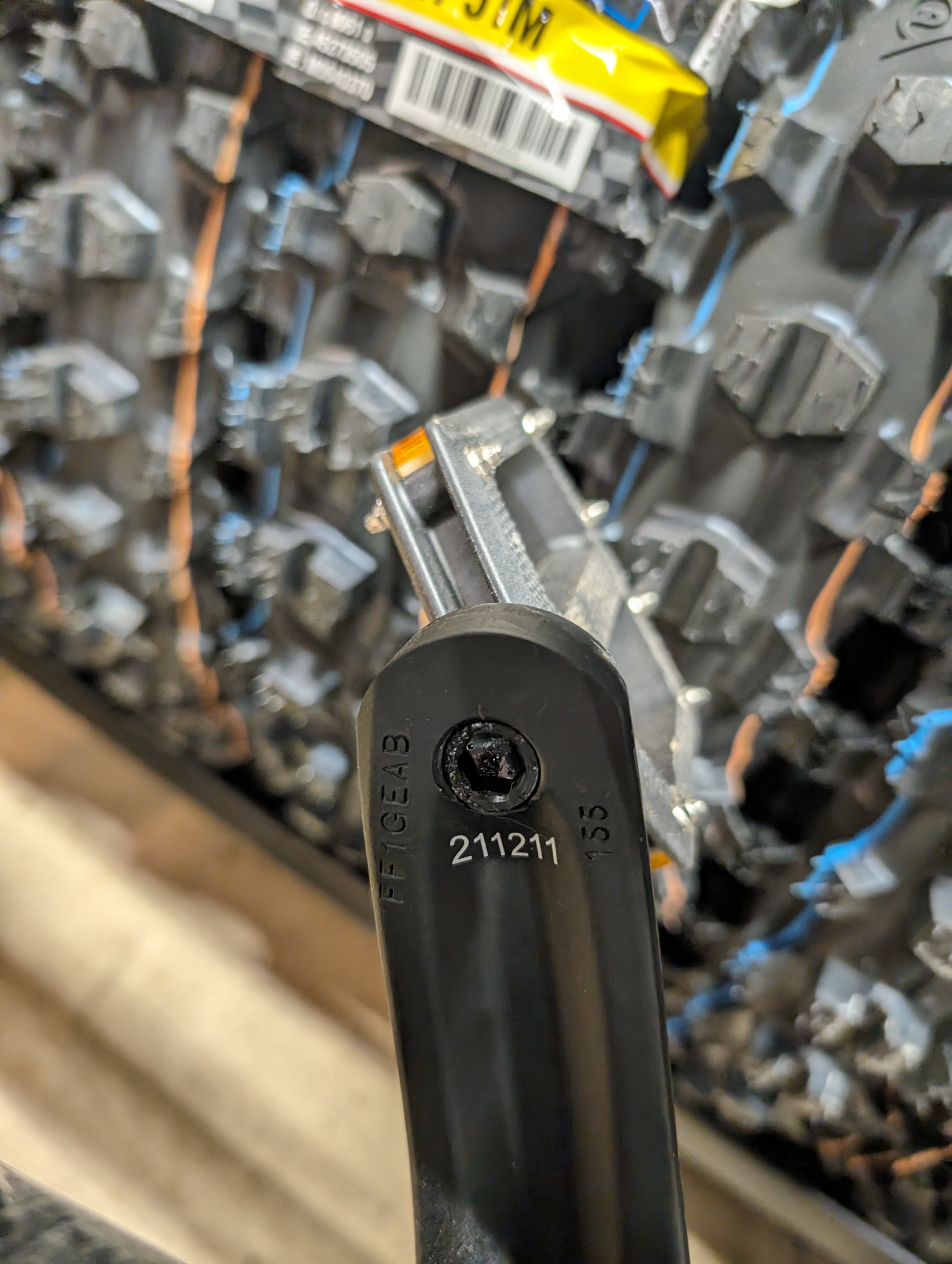

If you look at the photos above you can see that the original 165mm arms have an oval marking and the end of the crank arm comes quite close to it, the 175's have a similar oval but the pedal hole is at the outermost position. So my guess is that they have one forging for the MTB cranks and another for the road and then the only difference will be where they put the pedal hole and cut it down to.
I did 150mm and you can see in the photos that that is about as short as it is probably sensible to go for an adult, but 145mm would probably be OK for a lighter rider. If you are going 145mm then 170mm would probably be OK as a starter too as you would have shifted the hole the same amount so should be clear of the old hole. Just try to find a picture of the back before you buy them.

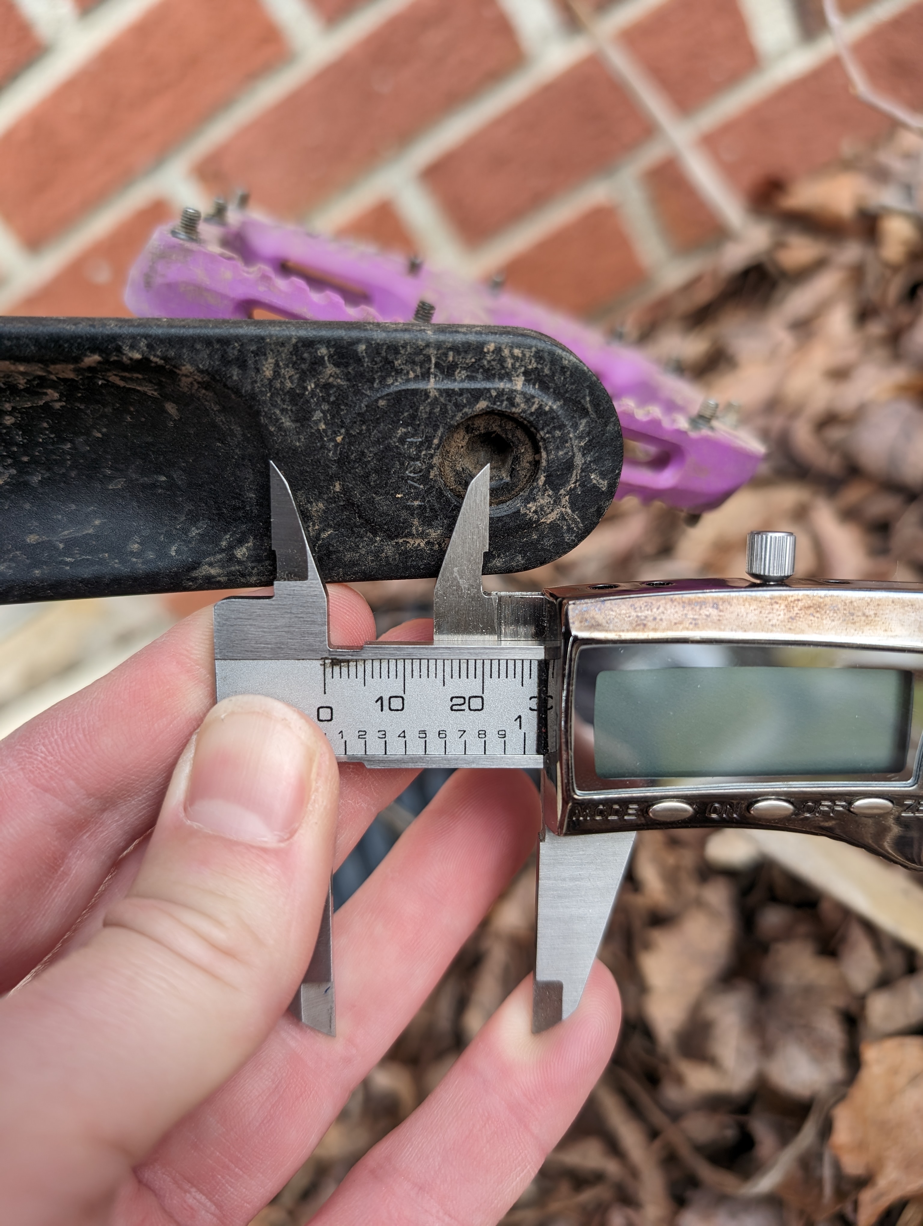

I would be comfortable putting 1/3 of the hole into the scallop. The crank arm on the SL kids are that way, specialized made them as short as possible without changing the forging. If I can get 5mm shorter with road vs MTB cranks that's worth it to me.
Looks like i can shorten my current MTB 170mm cranks about 25mm, that would give 145mm. But would still really like to be closer to 135 so hoping the road crank scallop is shorter.

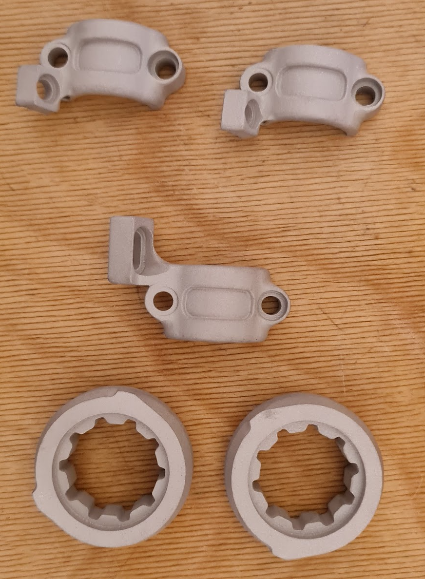

Designing bike parts is my job. Can't show the ones I did unfortunately, but picture of the test bosses I printed to check the spline fit are below.
I use Solidworks which is kind of the standard in the bike industry but the files I send to the 3d printers (in China, using online upload links) are STL's which most (if not all) CAD software can produce, so there are cheaper/free alternatives.
They claim pretty decent properties for the material but I would/do put a hefty safety margin of error in there, comparing to cast (not forged) material is pretty reasonable.
Because it is 3d printed you can put material exactly where you need it rather than where it would need to be to be manufacturable so you can get good strength at a lower weight. However you do need to consider where any internal cavities can vent the un-used material after printing.
Last lot of printing I had done was using In3dtec, came out pretty decent.
Printing small stuff is generally much more cost effective.
I did these Magura brake dropper perches and they were so light they worked out cheaper than the proper Magura ones with the advantage of putting the lever where I actually wanted it rather than at a really awkward angle.
Also worth remembering that you can't print the pedal threads or the threads for the removal cap at the motor end. Drilling the pedal hole to size and cutting the threads is no problem but the removal cap is a lot trickier. I opted to print some features on the crank to accept an alternative remover instead.
