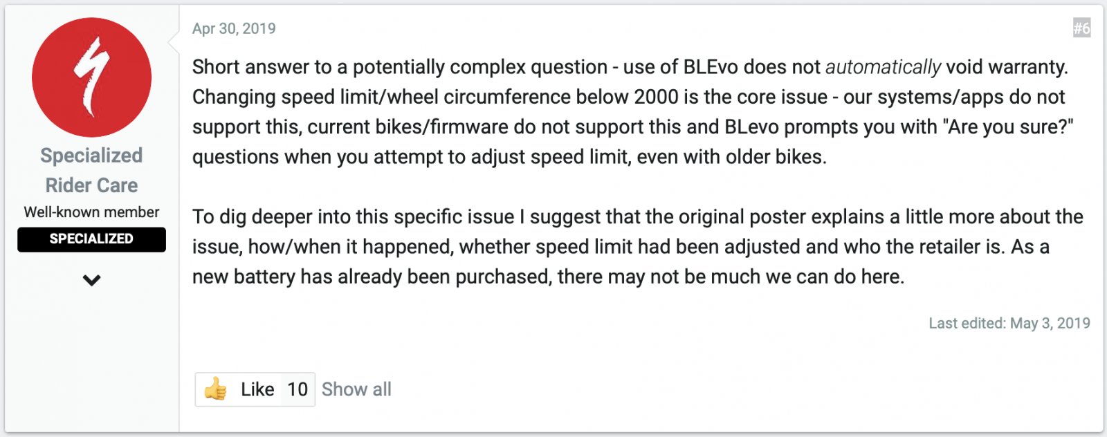

I can connect either old or new MC app to my 2019 Kenevo and have used old app to change wheel circumference to 2000. When I connect new MC it also shows my wheel circumference as 2000. I can't see this voids any warranty because I'm using a Specialized app to modify wheel circumference. I had my battery updated at my LBS recently and on old app it says that firmware is 10.231 (motor 5.04). The new MC app says Battery firmware is A.17.1!! (motor also 5.04) Odd. Also odd is that both apps report battery temperature as 8 degrees and the motor as 11 degrees. Bike has not been ridden today so there is no residual heat in motor.
If a future update of battery stops old app being able to connect or restores wheel circumference to default value I'd rather stick to the current firmware, especially as next tyre will probably be a 2.6 which has a smaller circumference than the current 2.8.
wepn
The Barking Owl ?
Jul 18, 2019
1,006
1,145
AU
Of course you're absolutely right as usual
