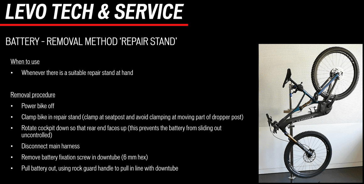

Clamp at seat post and avoid clamping at moving part of dropper post.
The seat post is strong and secure enough to hold even the heaviest rider, so it's more than capable of having the weight of the bike hanging off it. If there is not enough exposed seat post or outer (non-moving) part of dropper post, then clamp high up on seat tube where (you know after checking) the seat post inside will oppose crushing forces.

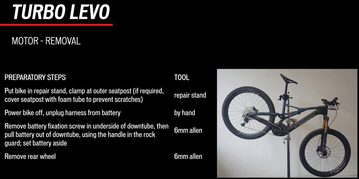

My LBS hooks them up that way as clamping a dropper post is not advisable. What they do is close the clamp then wind down the adjuster so it is just touching the top of the bar - that stops the bike getting knocked off accidentally.
Have been doing that myself for better than 10 years with various carbon bikes and never have issues.

Clamp at seat post and avoid clamping at moving part of dropper post. .............
If I have understood that correctly, isn't that the wrong way around? The moving part of the dropper post, which I take to be the bit that is fastened to the saddle, has no moving parts inside it. The rest of the dropper, the bit that slides into the seat tube, has delicate sliding components inside and definitely does not want to be squeezed too hard, not even by your seat post clamp. Which is why I use the Finish Line fibre grip assembly gel that allows a reduced clamping pressure.
