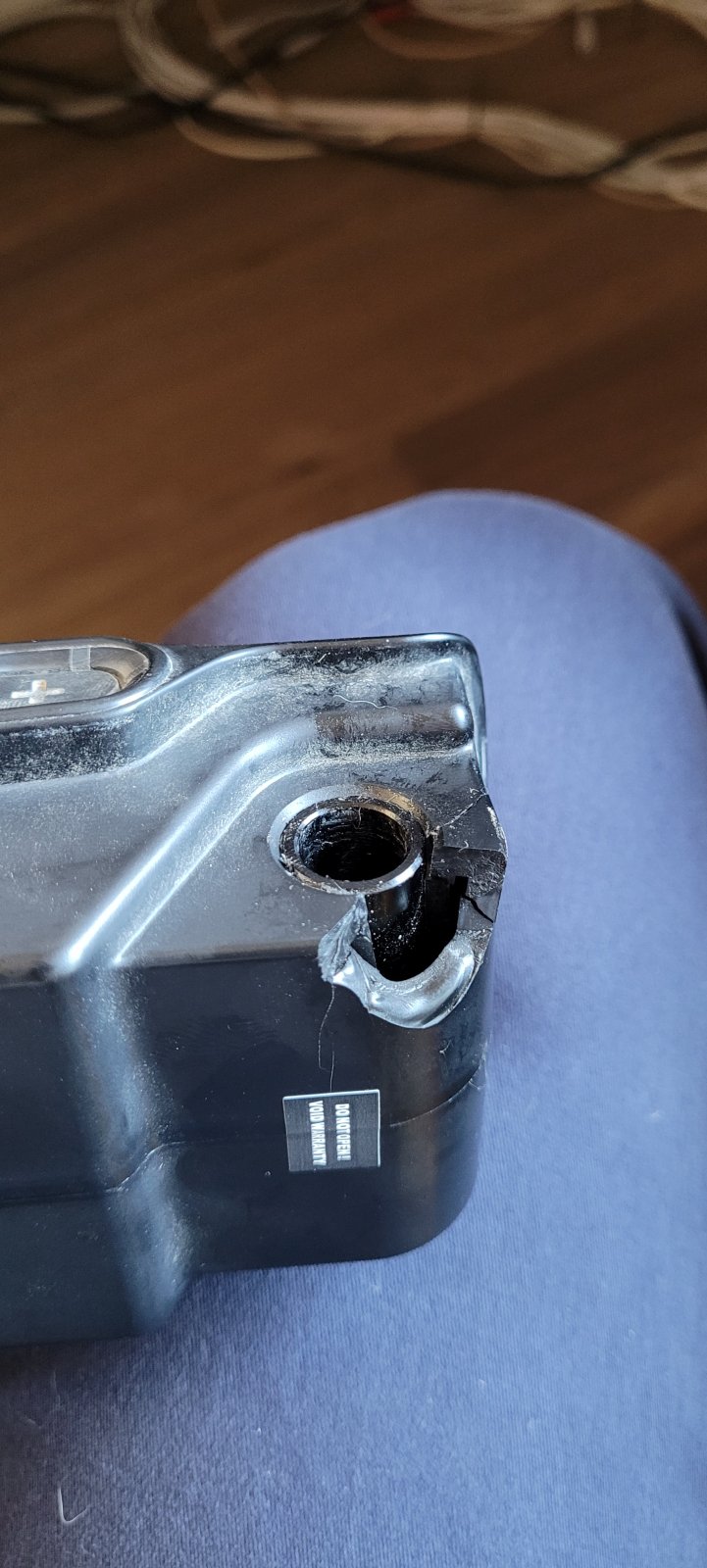

Hi
My Levo battery botom mount cracked. I believe its due to flex in the frame, but Specialized refuse to warrant it with the excuse that it's not a manufacturing fault. Have anybody experienced similar? I recommend that you inspect your battery's for hair cracks before the main crack occurs, this will clearly indicate that the frame are stressing the battery and they will then have to replace it.

I would look for several instances of this and then kick up a stink.
Personally I hate the drop-of-a-hat lawsuit mentality, but sometimes manufacturers get away with some real bogus shit. I had a Giant carbon frame failure and Giant basically said - you dropped it, tough shit. The problem is, I had only 3 falls and they were slow-speed BS falls where I didn't even unclip and the damage was on the underside of the top bar. A guy I know that does fibreglass repair has a brother that is a CF guy in a F1 team. He reckoned the issue was someone picked the frame up before it was top coated and did not wear gloves - he reckons fat or something from the guys lunch caused the top coat to fail to penetrate.
Took Giant to the small claims court and before the case was even heard they offered to replace my bike with a new 29er.

I have put out there to try and find more cases like this, havent had much feedback yet.

Holy shit, I have never seen that one before. But I have never seen a frame flex to such an extreme that it would cause that type of damage either. I have a few empty battery cases, maybe your local dealer has one

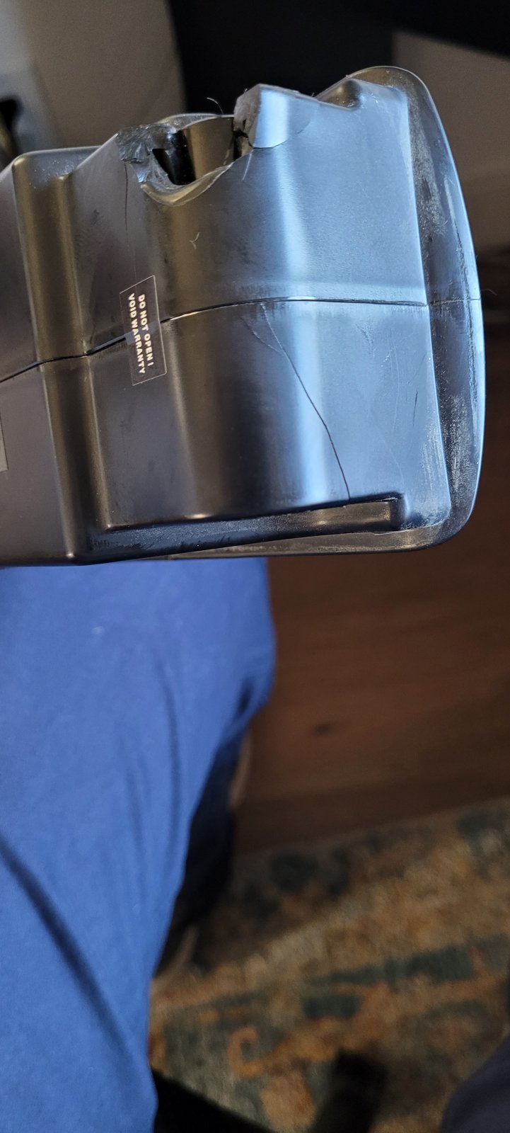

Just update. Another two of my battery's have cracks and one from a friend. Lost one battery because of water ingress via a crack I wasn't aware of.

I've had 2 go , just got back from today's ride, now 3rd one cracked all in the same place ( 5 months old ) crap design and materials

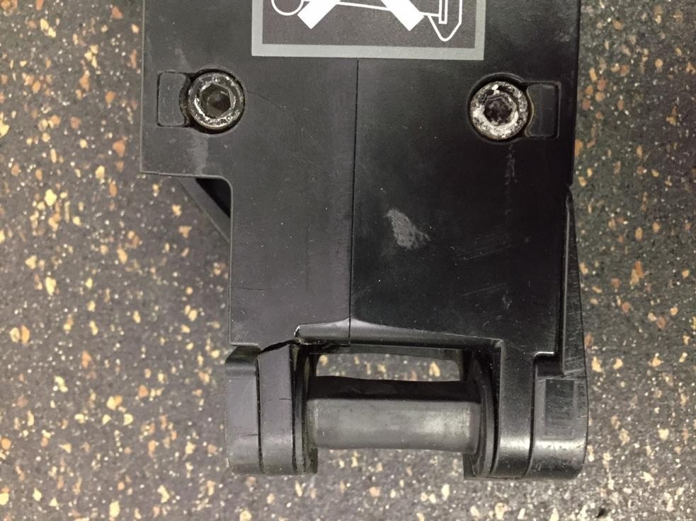

I have a 2019 Kenevo Expert and my just cracked at the top retaining bolt. No batteries in stock and my local shop I purchased it from has no idea when I will get it back. I also reached out to Specialized and they said the same thing. I've only been on a dozzen rides or so with it. I think the frame flexed and the battery cracked. Battery 1.jpg Battery 2.jpg Battery 3.jpg

Same here. Exacty the same cracks and fail. 2019 Levo.

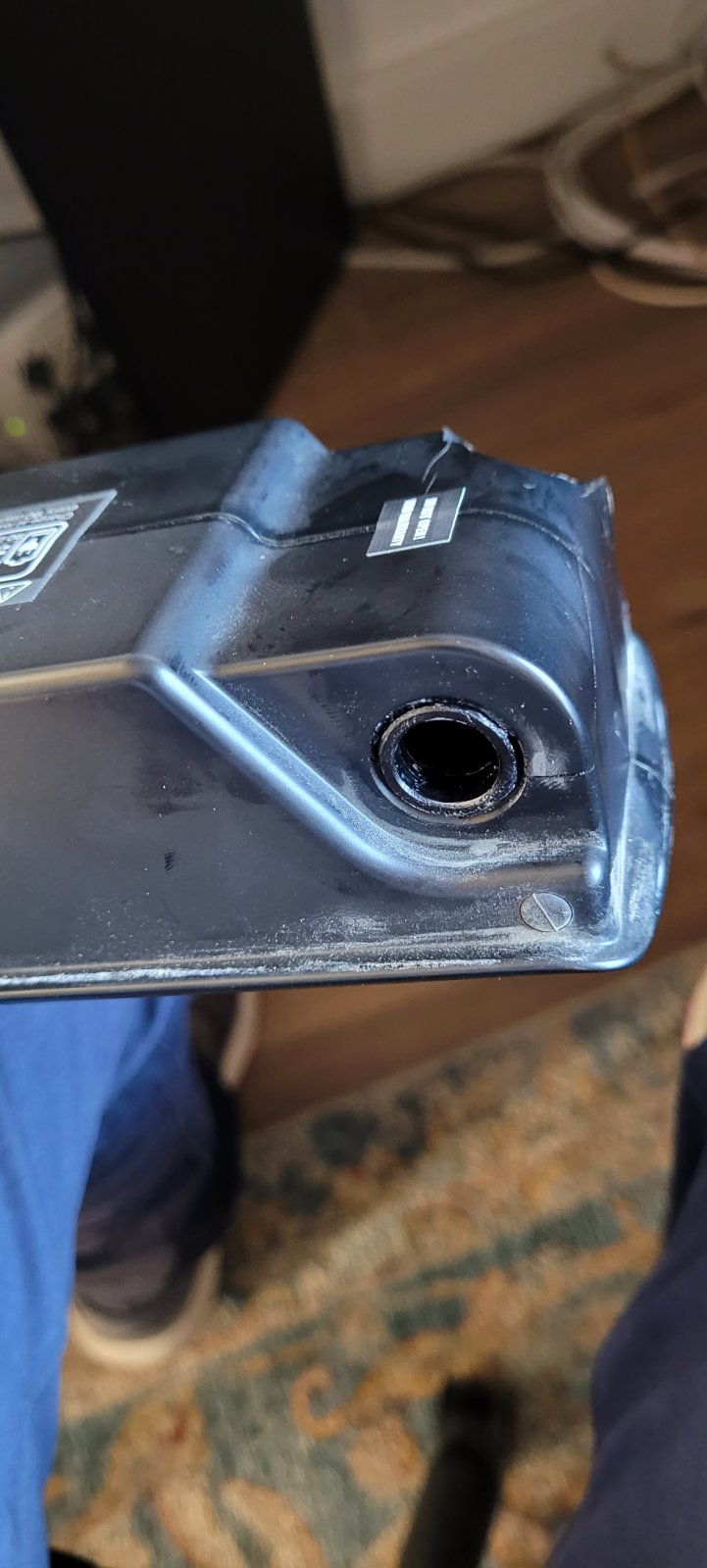

Exactly the same case, today I thoroughly cleaned and lubricated the bike and luckily I was unscrewing the battery and noticed that the lower bracket was broken. My bike is Turbo levo HT 2018. The warranty has expired, the new battery is too expensive, what have you done? It seems that this is not just a small problem. It looks like bad plastic, or a flaw in the construction itself.
