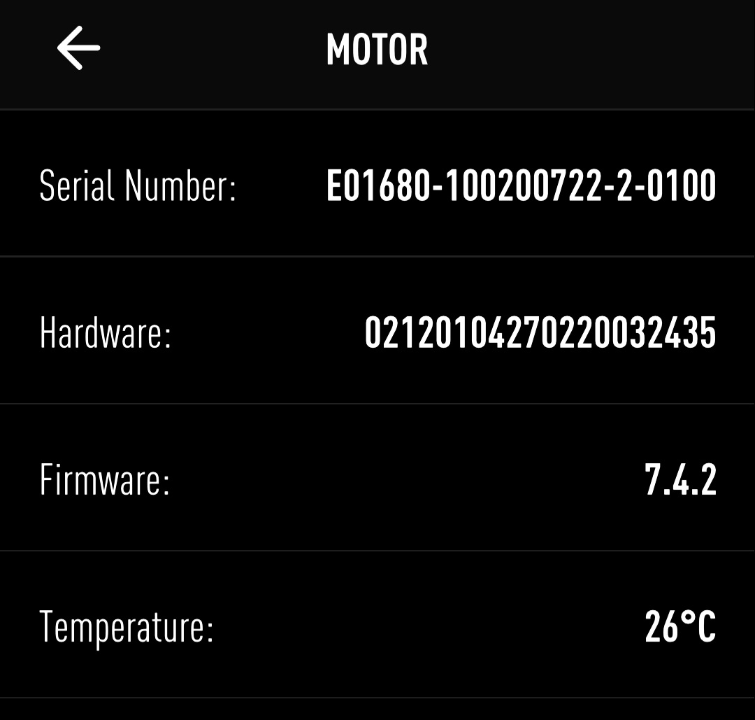

This is concerning/disappointing for a '21 Levo, which should've gotten the new belt. Can you share with the community the production date of your motor?

22nd July 2020 - so around the time we guess the change over happened - late July/Early August. But we don't know exactly. So could be old belt and could be new belt.
