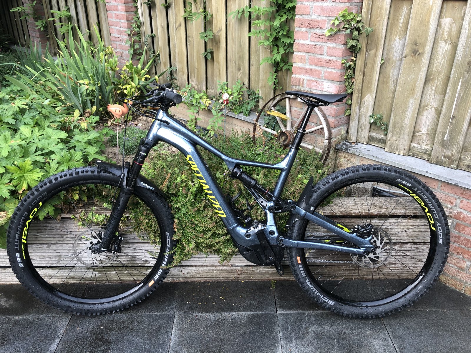

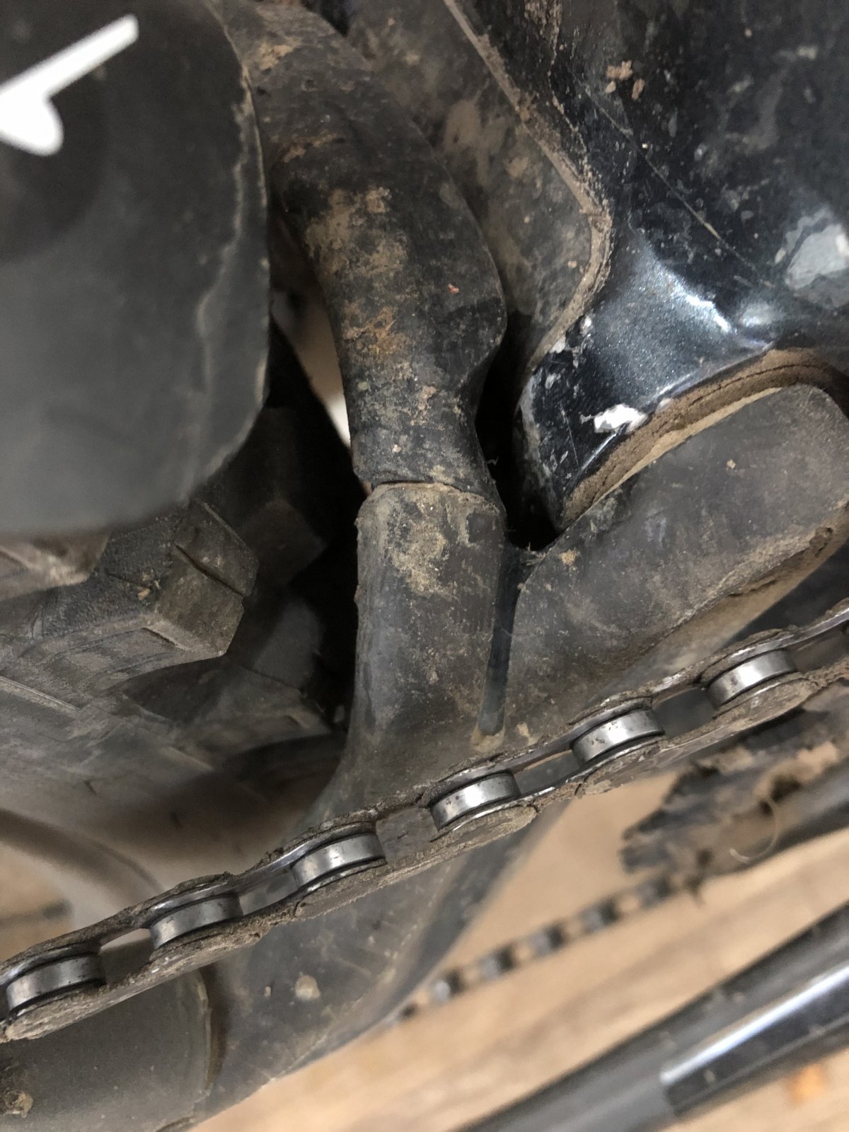

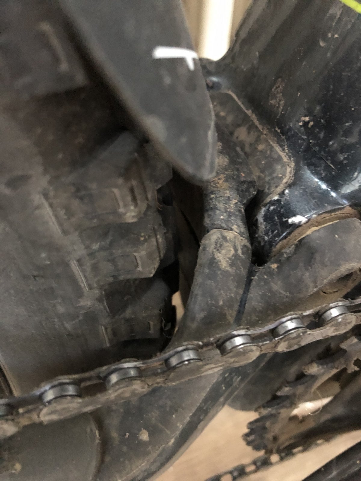

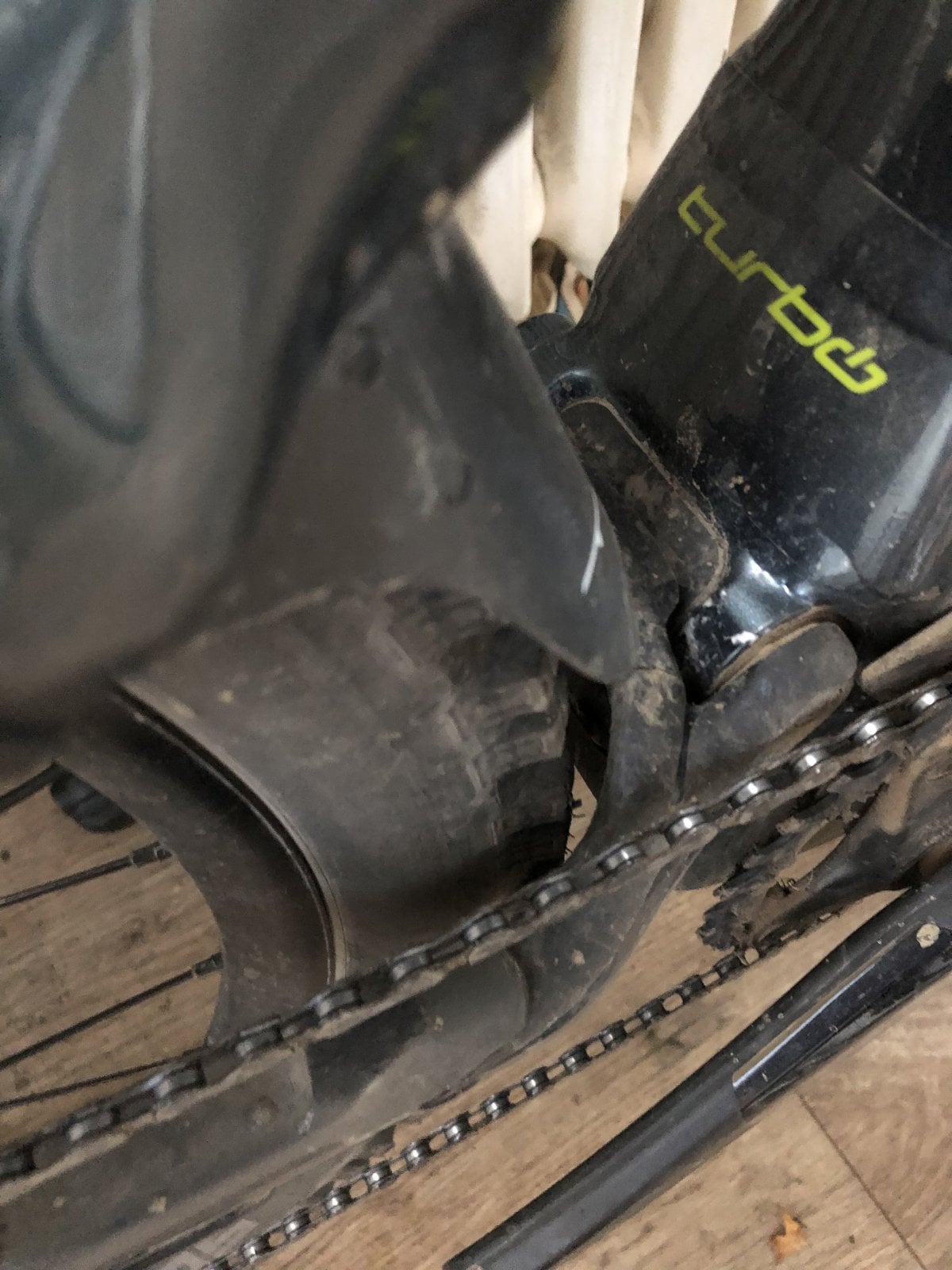

M
How well does the Eddy Current 2.6 clear in the rear? Any pics? I have one that I haven't yet mounted. Seeing as how tight the stock Butcher is, I was worried about the Current being even tighter. Wish they made a 2.4 rear of the Eddy Current
They are tight as a rear mudhugger didn’t fit anymore. However with a shorter fender it works. They ride great!
I will try to send you a picture tonight or tomorrow. Currently travelling for work.
Maastricht
Oct 3, 2018
646
655
M
I prefered a longer rear fender and bought a Mudhugger Front Race Long version. With the Butchers it should fit with the Eddy’s it does not. Tried to cut pieces of to avoid contact between the fender and tire but it didn’t work. If someone has a fender which does fot but which is longer than I am very interested.
