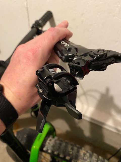

Is there a match maker lever adapter I'll need when installing MT5 brakes? Or will the on that came with my SL Comp work with the Magura levers? I can't find one online to order either...
I've been looking around on the forums and cannot find a definitive answer.
These are the new 2021 MT5 one finger lever to Sram GX shifter.
Thanks

Its the adapter that allows for mounting the shifter to the brake lever, they were invented during my 10 year hiatus from MTB. I did a poor job describing them.
I was torn between the MT5 and 7, wanted to stick with Sram but wanted a one finger lever. I found the new MT5's on pink bike from a shop in Colorado. I didn't hesitate and ordered them as stock is low here too but both the the old 5's and 7's can be found.

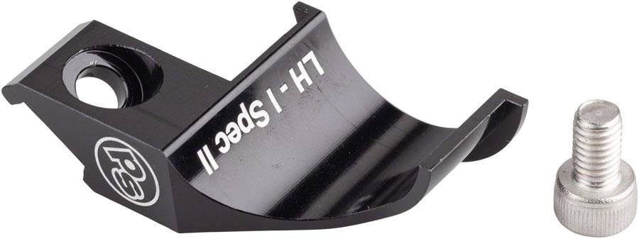

anybody try these? Look like they may work.
Problem Solvers MisMatch Adapter 1.2 - Shimano I-Spec II Brake to SRAM MatchMaker Shifter, Left Only

I have experience with that specific item, when used on Shimano I-Spec II brake lever with SRAM shifter and/or compatible dropper remote lever. This adaptor will NOT work for the Magura lever, as it's designed to replace the plastic shim removed from a Shimano I-Spec II lever.
After much research I I figured that out and ordered a couple bar clamps for the shifter and dropper. Looks like the Magura shiftmix 3 will be avail in a month or so...so I'm told
