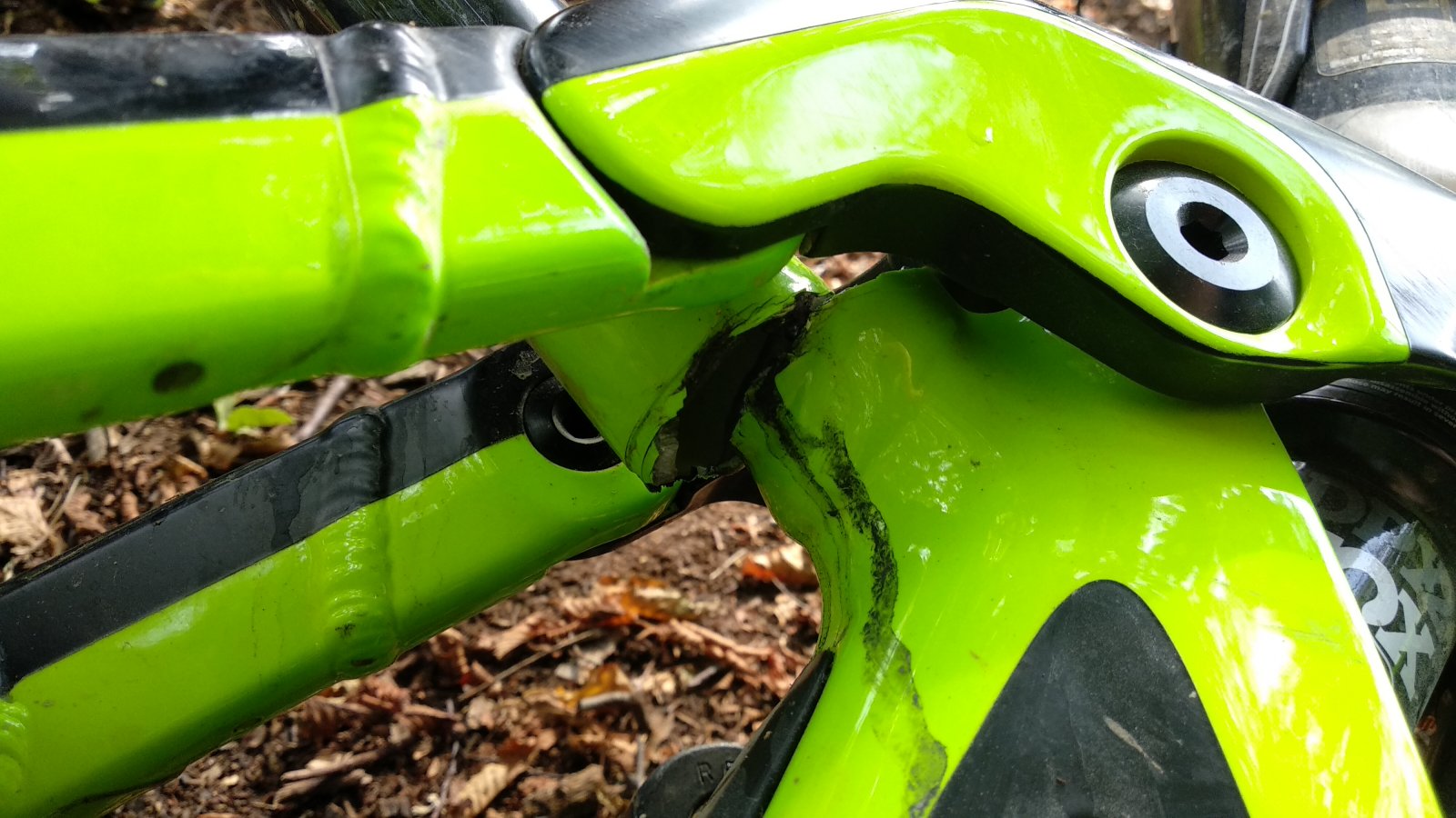

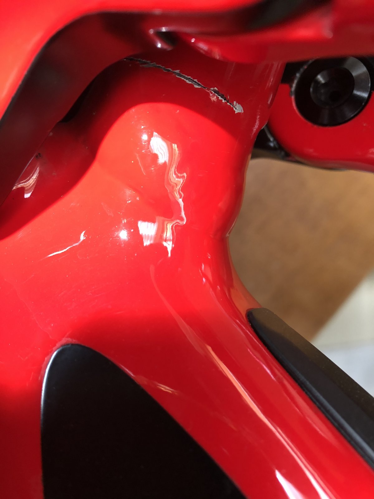

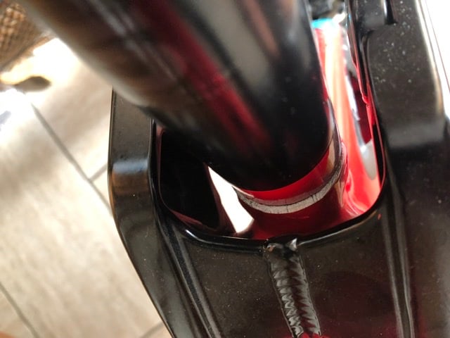

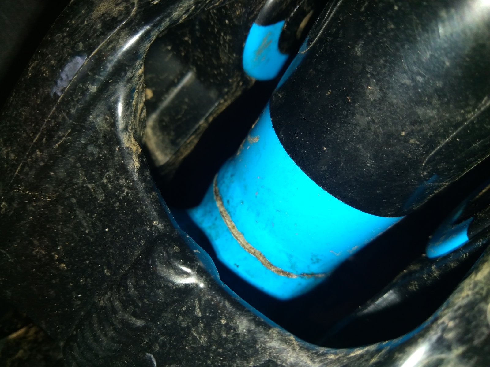

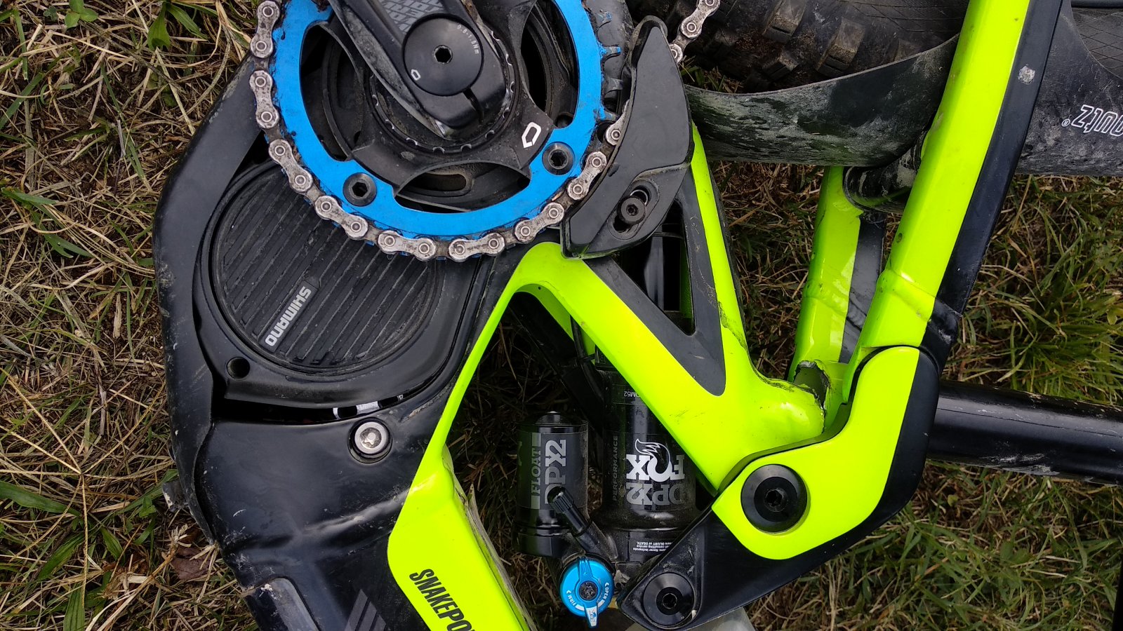

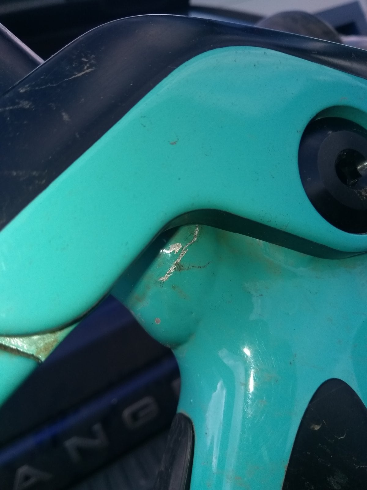

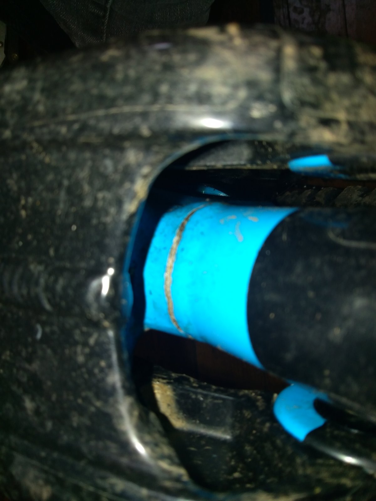

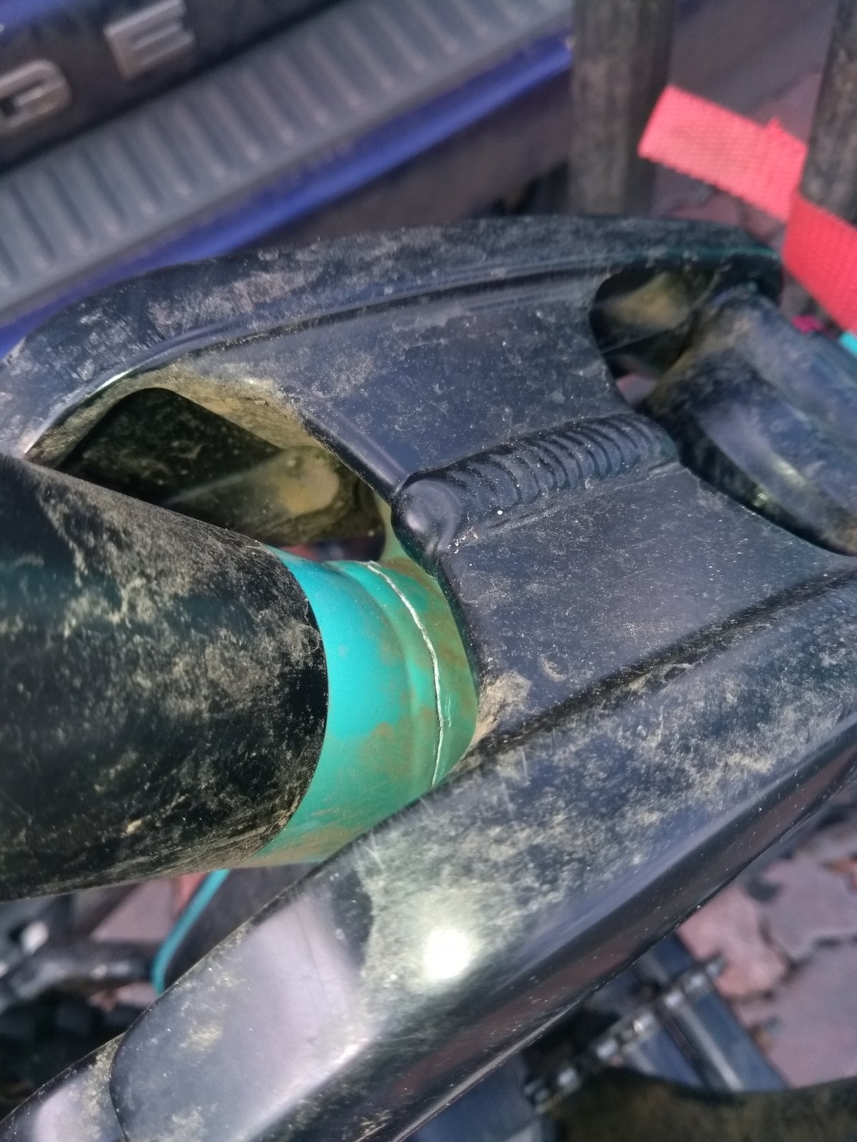

Folks, thought it best to inform you that there is potentially an issue with the 2019 Lapierre overvolt and the seat stay cracking. I have had 2 overvolts 727i and a 927i over the past 6 months both of which have been sent back to LP/Raleigh due to the frame cracking at the weld in the seatpost stay.
Raleigh have been very good and have replaced the bikes - 3rd one is on the way as we speak, they have attributed it down to a batch of dodgy frames. Anyhow the bike details are below -
Overvolt 727i - size large - months owned 3 - miles travelled 390 - big crack at the seatstay weld - Frame number LPS7A-LG-B AV18110651
Overvolt 929i - size large - months owned 2 - miles travelled 214 - big crack at the seatpost weld - Frame Number LPS7A-LG-C AV18702419
I know there are a couple of others on here that have had the same - @gfunkmc and @Rich_F21316, if you have had any issues then please post pictures of crack along with bike details, model, size, months owned and miles travelled and frame number if you have it .
Cheers @Cheekychops1111

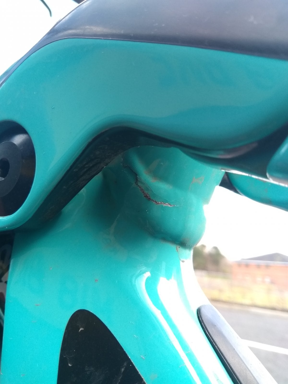

Hi guys, any updates on this? I have discovered a very small crack in the same place on my 527i , wondering what to do? Im also having motor issues. Its over a year old now.
I ended up getting a YT Decoy. Take yours back to where you purchased the bike they will get in touch with lapierre and they WILL accept it as a warranty and offer you a replacement bike or frame. However I’d recommend getting a refund or pick a different bike.

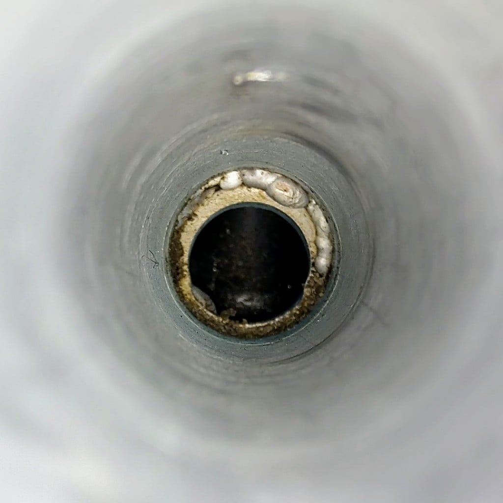

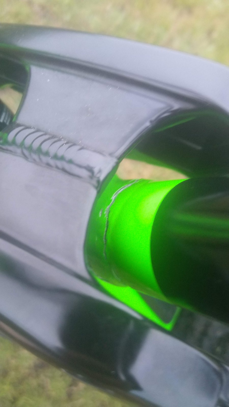

Hi just looking at the last picture this does not look like a design flaw - more like poor welding technique/set-up. If you look closely you can see there is no weld penetration to the frame tube - the weld is just sitting on top of the tube. The weld is meant to fuse/melt the tubes together. There is no tearing/cracking of the tube material in this picture the weld looks like a bead of mastic on the surface of the tube. I just took delivery of a 927i - hope the welding issues have been sorted !!!

i think that just a dowel on which the outer tube slides over

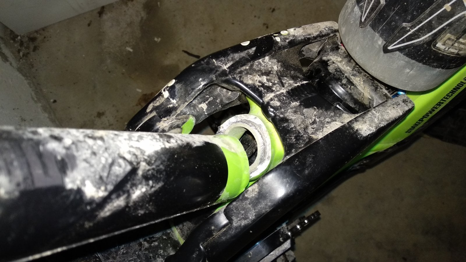

just thought I'd revisit this post to see if anyone else is having issues which it looks like they are!! anyway, my second frame is ok so far but the Seatpost was sticking Raliegh and Lapierre were hopeless in advising me how to service it so I took it out to fit a new cable. while the post was out, I took a pic of inside the seat tube. Does this look like quality workmanship to you?
Edit: just comparing my photo with the frames that cracked off completely, it looks like my fame had an offset washer shaped thing in there and not a collar?
