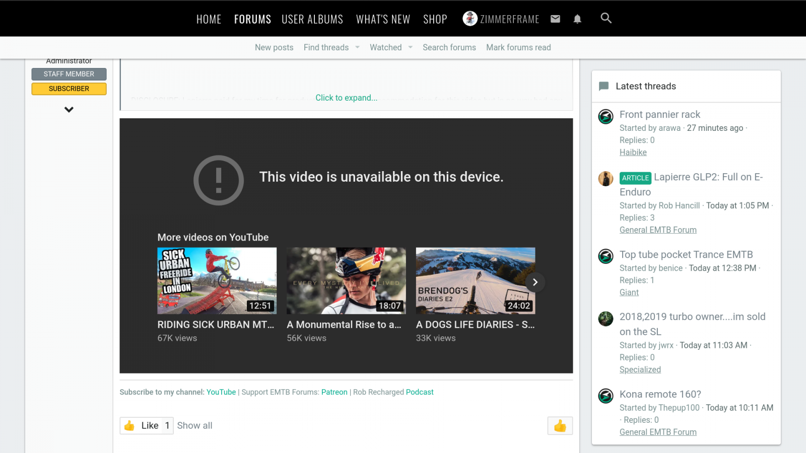

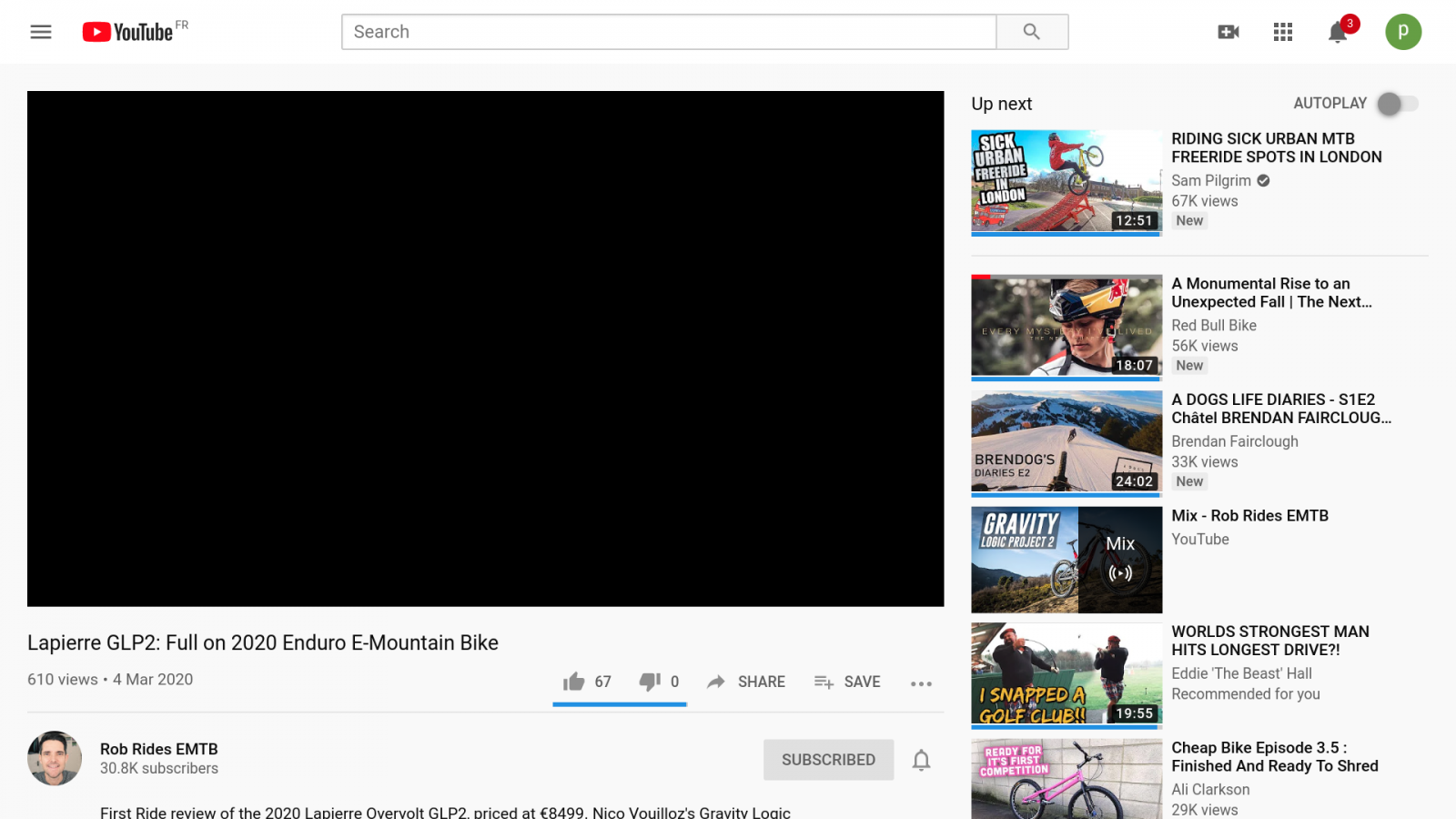

Not sure if there's an issue with some settings for your video @Rob Hancill
It played on my mobile earlier (in France).
But won't play either in the forum or in youtube on Windows 10 or Chrome OS.

Yep, the video plays on the iphone but will not on my smartTV.

There's a new YouTube update that is currently throwing up issues with many adblockers - could be related.
