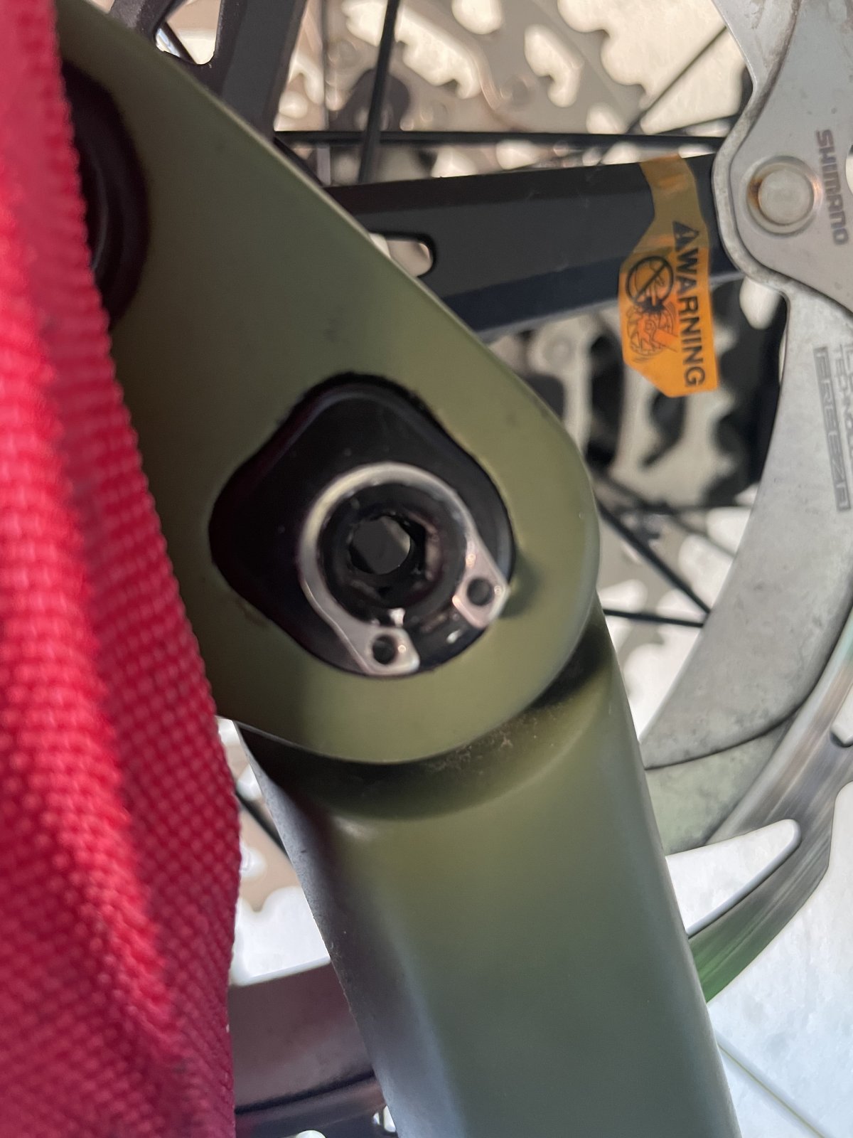

Hello. Sorry to jump in on this thread. If you have tightened the pivot points up do you know how to tighten the rear pivot point with the C Clip on it? I have some side to side play and the bike is only a couple of months old.
