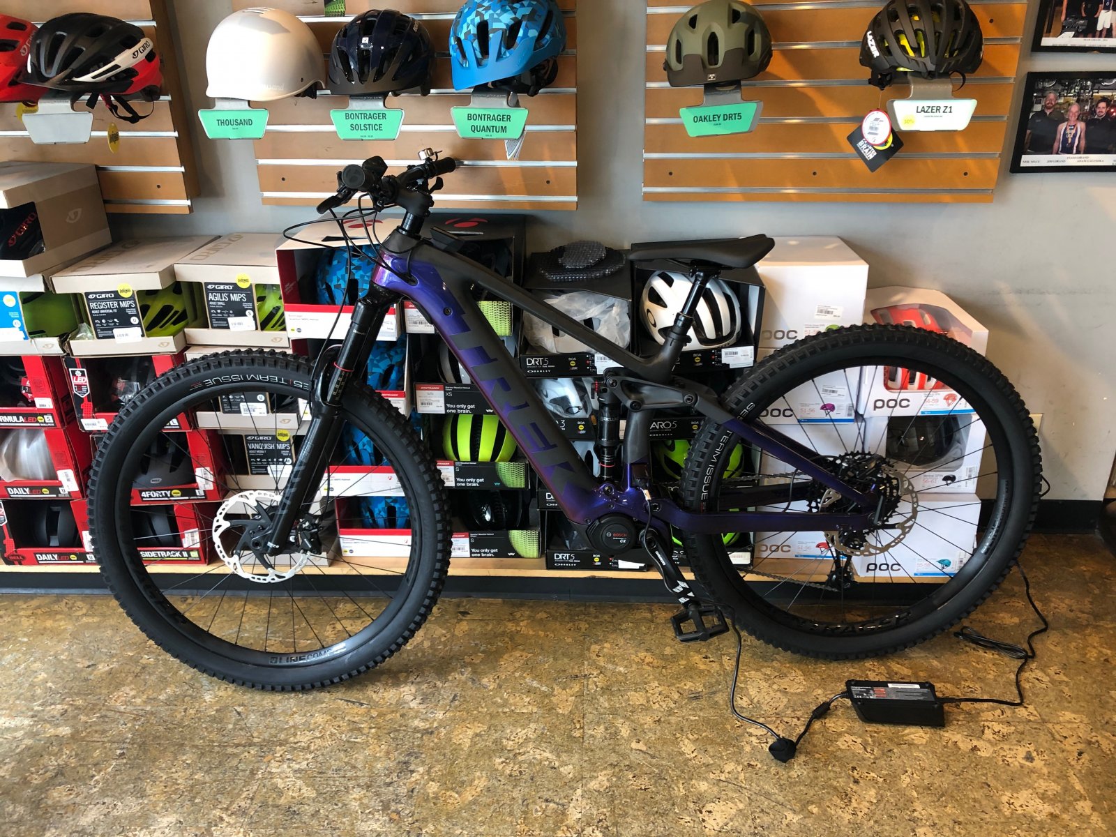

Wanted to follow up with a definite answer. I finally got pictures of my built bike (that I get to pick up on Saturday!!) and it definitely has a Kiox.

I ordered the end of July and my original expected date was end of August. If I didn’t live so far from the bike shop it would be sitting in my garage right now. I’m beyond excited!

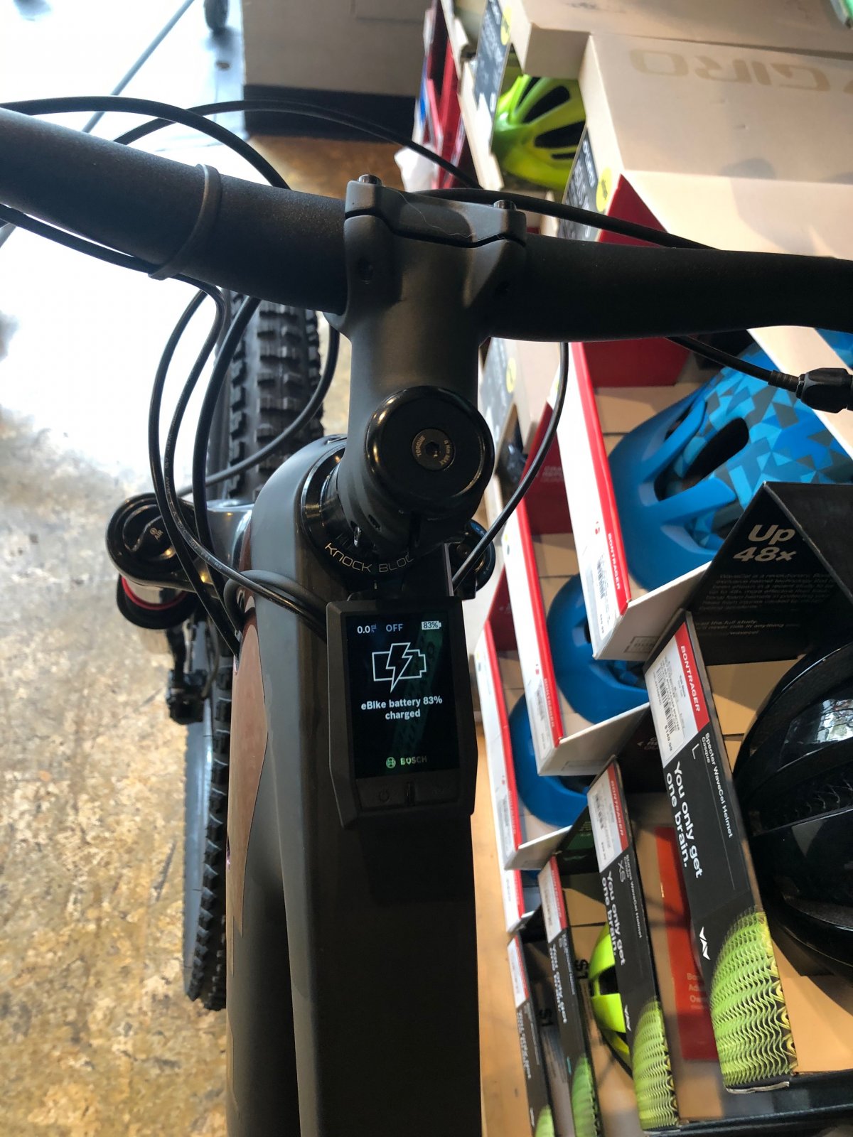

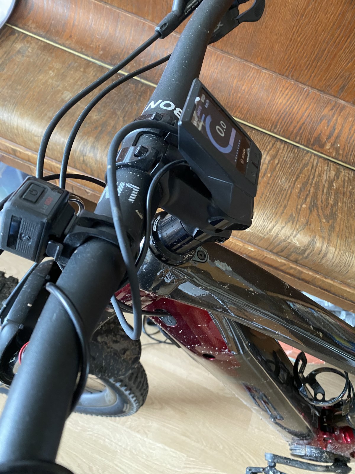

Nice. I use this position for kiox also. It is way better then on frame tube for seeing.
I have Rail 7. I bought the tube kiox mount by Trek also, but changed my mind and take the original Bosch mount.
I did the same thing, changed my mind. I can see the Kiox better on the stem.

I have a Rail 7 also and Kiox retrofit installed to the stem. It is optimal for viewing. I used the screw on the mount so it is not coming off. Kiox is much better compared to Purion. Nice to see my heart rate when paired with heart rate chest band.

I made my decision between the new Nyon and Kiox, and Kiox won for me - I like to ride action trails and dont want to have big box on stem or frame. If I would have a bike for trekking, the Nyon is the winner for that purpose.
And the decision about position - I bought the original Trek mount for frame, but after I had seen the bike of Tracy Moseley, I tried both positions and my neck told me use the stem. And It is safer for action ride. I also tried to flip the bike on handlebars, and it is possible without any problem (put off the kiox display, and I have upgraded handlebars to 35 by Trek)

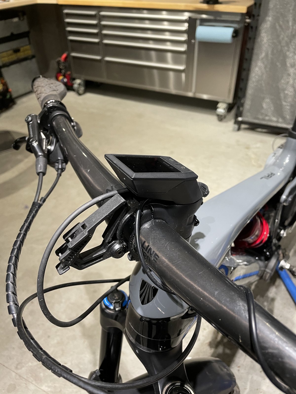

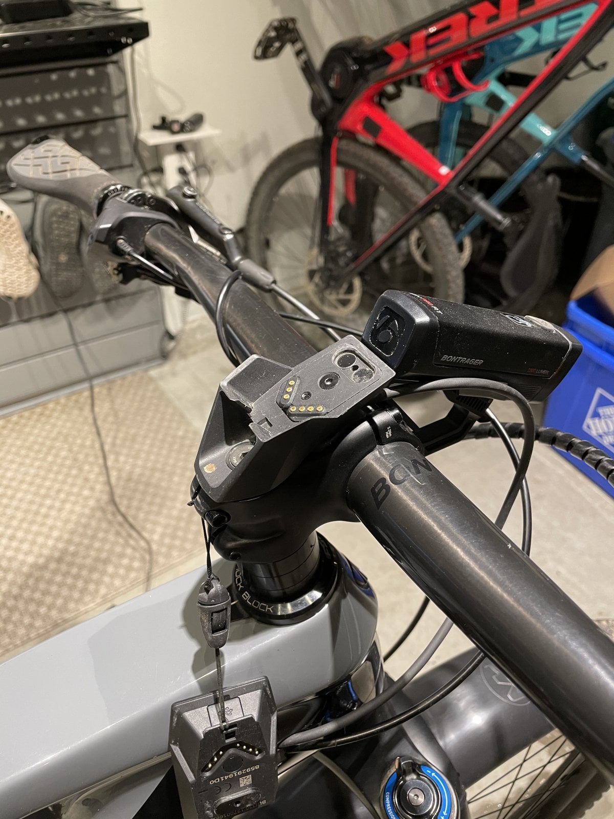

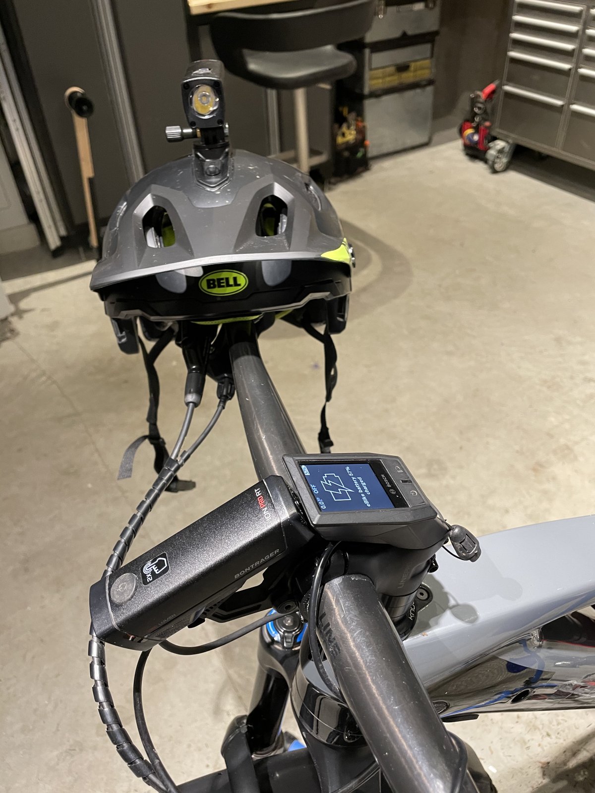

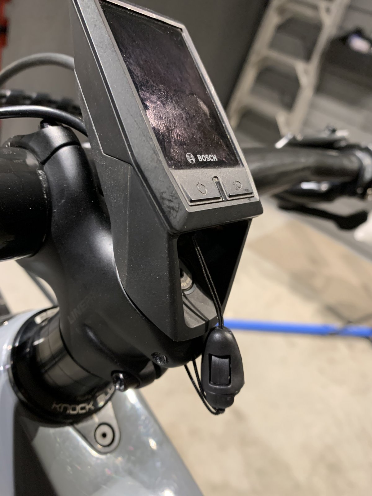

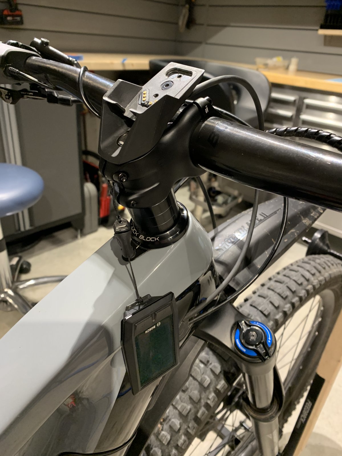

So here’s the evolution of upgrades with the Kiox mount, stem, light, bar and attachment.
I installed a 35mm carbon which needed a new stem (60mm). Replaced that with the 45mm blendr stem which accepted the universal GoPro/light mount. Got the light attachment (quick connection). The LBS thought I might have to reposition the Kiox to the lower bar so they ordered that mount for the Kiox. They figured the clearance between the light and the Kiox would be an issue.
Since I also ride at night, or when it’s dark out, I wanted sufficient lighting. I also wanted to see the display on the Kiox easily. Keeping the Kiox mounted on the stem made seeing the Kiox at a glance easier.
So it is possible to have lights, an optimum location for the Kiox and tether it.

@Stihldog love the tether, definitely something I need to change also, already dropped my Kiox twice (kicked it off with a odd leg movement), handlebar might be a bit better position because of that. Thanks for the ideas!
Stihldog
Handheld Power Tool
Jun 10, 2020
3,492
4,870
Coquitlam, BC
Some Kiox owners screw the Kiox to the mount. This might be ok if the Kiox was mounted on the lower bar. I like that the Kiox can magnetically disconnect …it did its job a few times. It’s never bounced off even though I smash up on some big marbles.
But that time when we had to search for the Kiox helped me come up with a solution. I like the stem mount location now that I use a small tether.
