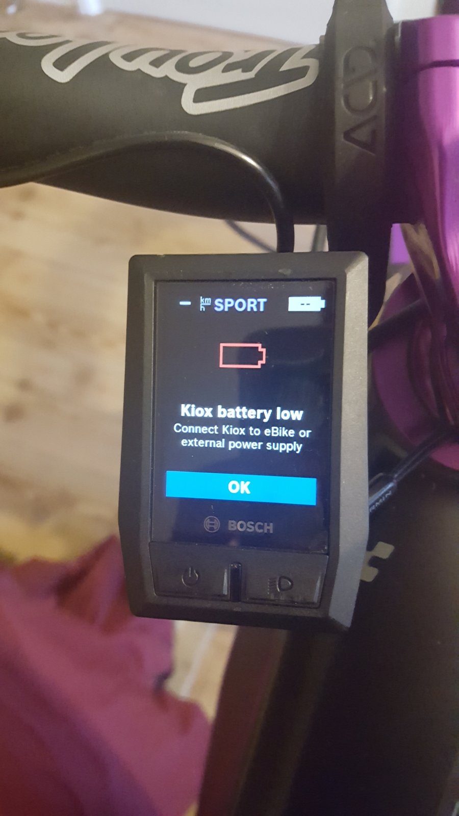

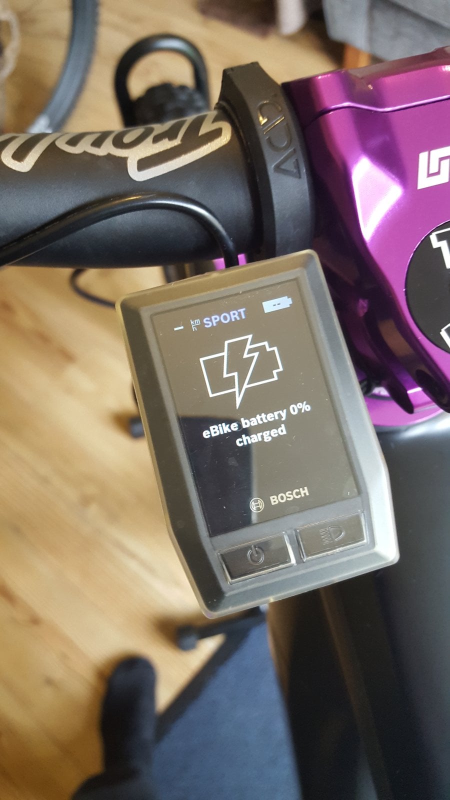

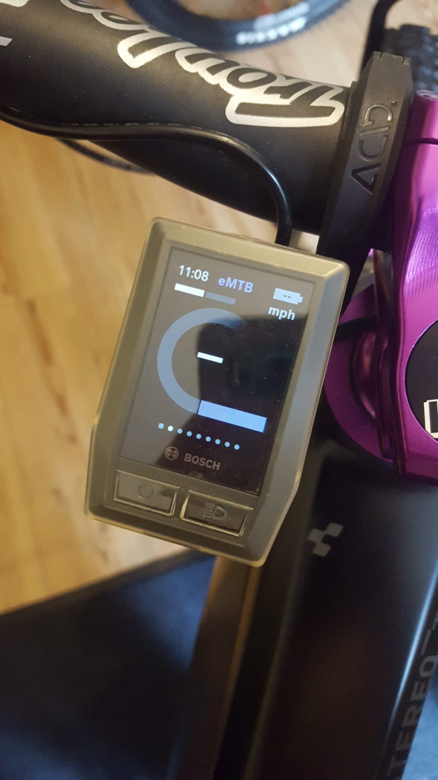

Hi there, not sure if im posting this in the correct thread... but...
I have a cube 160 TM and I was scrolling through my kiox earlier just getting familiar with it as i've never done so. Everything was fine. I went and put the kettle on and when i come back the battery % had gone and it was just showing a line (see picture) and all other info had disappeared. Ive tried everything i can think of... powered kiox on and off, battery in and out, battery on charge in and out of the bike... nothing, its still showing nothing and the motor is not working. Im really dont understand how just scrolling through the menus on the kiox would cause or trigger a malfunction?
Has anyone else experienced this? Reluctant to take it to the shop before ive exhausted all avenues as its a bit of a journey to take it back to them.
Really appriciate any help or advise.

That is what my Kiox looks like if switched on without a battery installed on the bike. I assume the Kiox is possibly not communicating with the battery or Drive unit. There is a reset to Factory settings available on one of the screens, may be worth trying that.
What happens when you switch the Kiox on with it removed from the bike, should cycle through various data screens.
Looks as if unit is still on old software, if you do have to take it back to dealer then have them update to latest version.

Thanks for your reply. I have already tried the factory reset via the options menu on the kiox, it reset because it now shows 'sport' instead of 'emtb' but unfortunately the problem still persists of not showing any battery % and the motor doesnt work. I fear there maybe a comms issue as when the issue started i plugged the charger into the bike with the battery installed and it was showing on the kiox that the battery was fully charged at 100%... now when i do it, its says the battery is on 0%
And yes i can confirm when the kiox is removed from housing and i turn it on it cycles through various data screens.

Ive tried all the options above and it does go into the storage mode as explained etc but nothing has changed from my issue earlier, still no % on kiox and the motor is still not working.
I fear you could be correct on your assumption here... as the kiox is now showing 'low battery' evan though its sitting in the cradle with a fully charged battery installed in the bike... 20210822_194444.jpg

Ok, so i tried this and nothing turns on apart from the green led lights on the actual battery itself indiacting its charged. They go out after about 5 seconds.
But... with everything powered off and the battery cover removed i turn the kiox on and as soon as the kiox powers on the green led lights on the battery come on and off intermittently the whole time the kiox is display is powered on. As soon as i turn the kiox off the green led lights on the battery turn off. So there must be comms between the kiox and power tube battery?

Gee rideordie that is some coincidence?
At about 6 months old my bike did have a blank screen one day when first turned on.
Taking the unit to the dealership saw a reboot and all was good.
Did they actually try another kiox display on your bike?
@Flyfisha yes, they told me they tried a different battery and a different kiox, but it made no change to the problem. Obviously gutted about it being a new motor as im now without my bike and have got trips/rides planned for the coming weekends... that ive had to now pull out from. One thing im 100% certain on... i wouldn't want to own an e-bike out of warrenty... this would be a costly failure if so.
rideordie
Nov 1, 2020
18
England
Hi all,
bike has had a new motor installed and is ready for collection! That was 10 days including the weekend with a bank holiday, Bosch... love em or hate em... that is great service!
Why it failed they dont know, should it of failed, HELL NO... but however you look at it the turn around time for a new motor is really impressive from Bosch.
Also I rang Bosch's customer helpline to ask few questions and they were fantastic! Offering loads of info on timeframes, warrenty extension, evan tracking numbers of my new motor?! They explained the whole process of the warrenty claim and gave me dates of when i should expect my new motor to arrive and if it hadn't arrived by certain time they encouraged me to chase it via the shop or evan through Bosch themselves.
One of the best customer services ive ever recieved tbh, just being helpful and understanding that the situation was not ideal ... and they evan apologised!?
I was always a Bosch fan tbh, but after these recent events that has just been cemented... yea, not great that the motor failed, but things go wrong, thats life... its how its been dealt with thats key.
Maybe other manufacturers need to take a leaf out of their book.

So my cube stereo has developed the exact same fault and symptoms. I took it in this morning, had a call this afternoon and it’s the motor, it’s 2 and half years old so out of warranty and quoting £720 for motor plus labour. The bikes only done about 1,000 miles not sure what to do at moment, don’t want to spend maybe a £1,000 and have it fail again in another couple of years .. I don’t use the bike that much and mainly firetrack stuff
Any advice greatly appreciated
