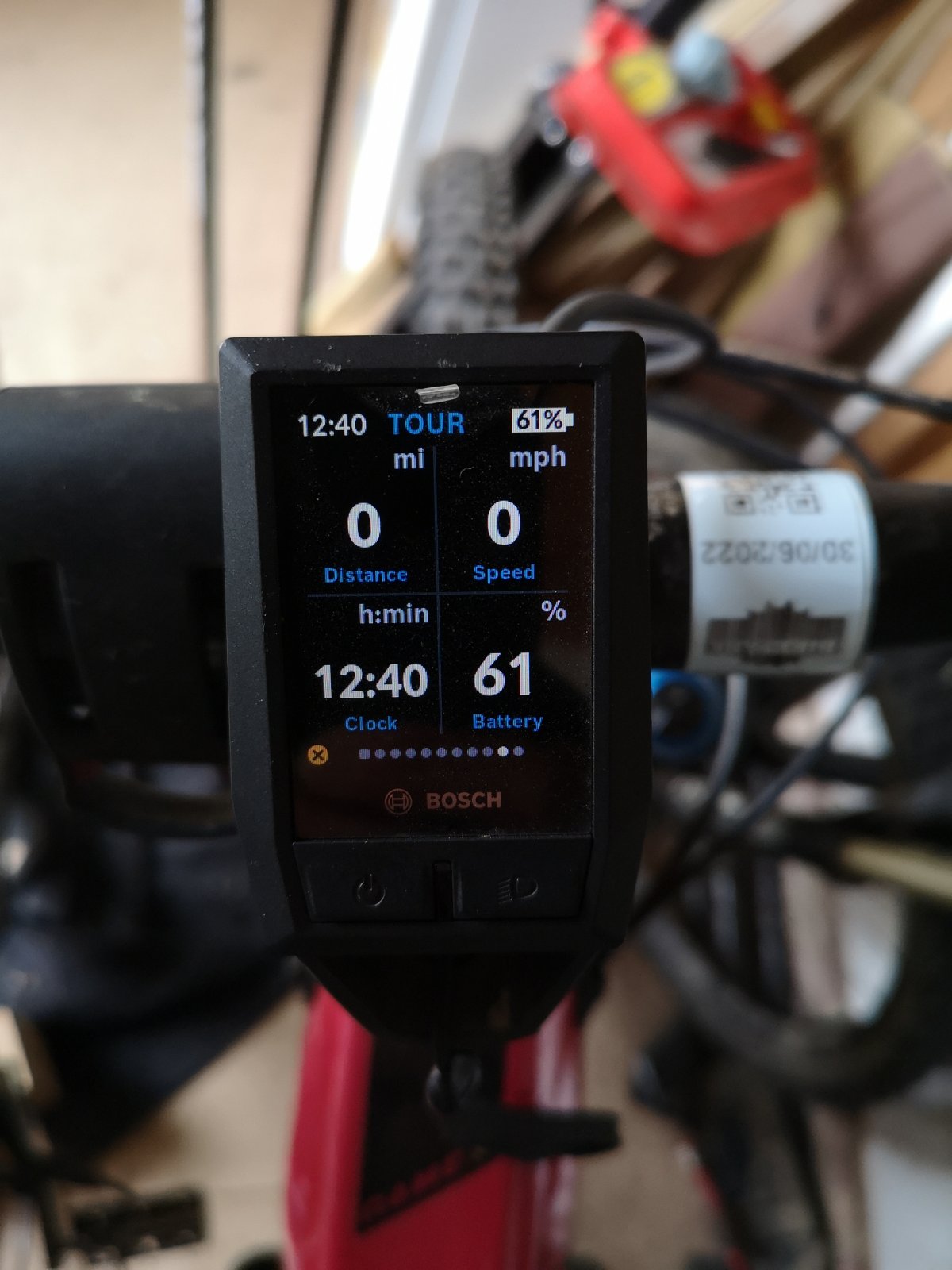

I've just altered the screen to show battery % instead of range now. 👍

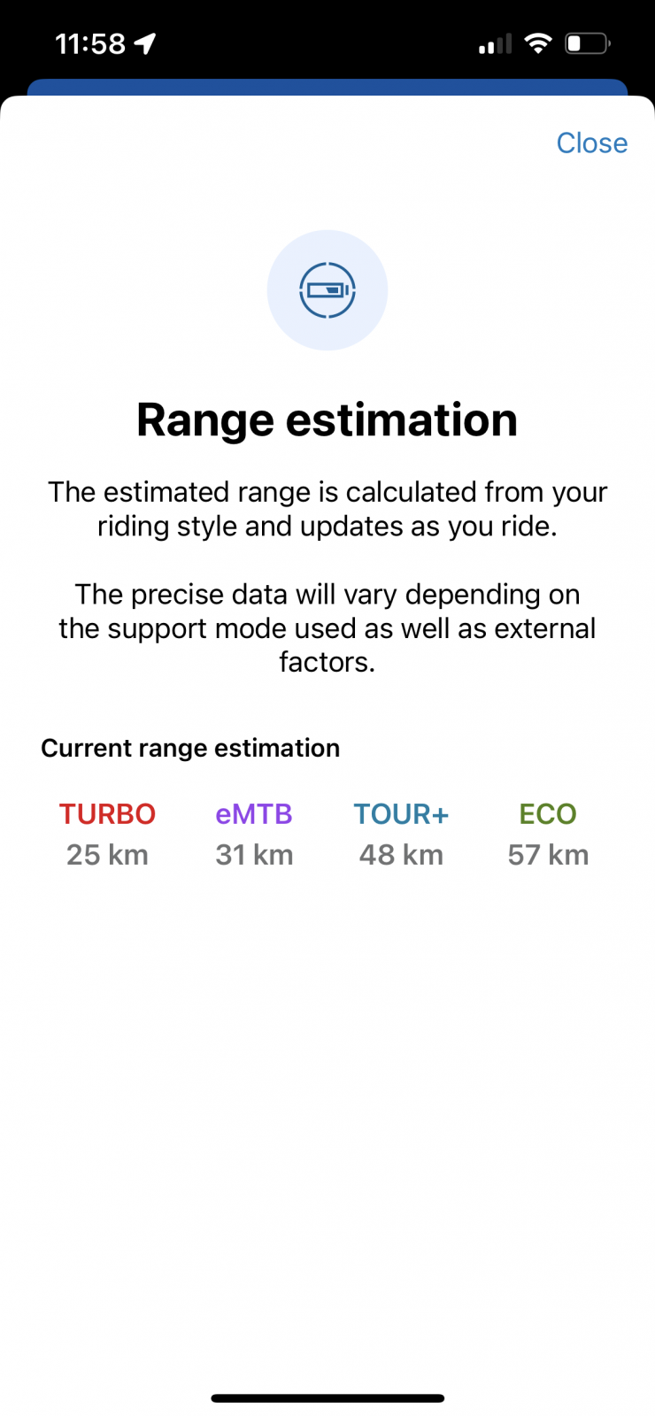

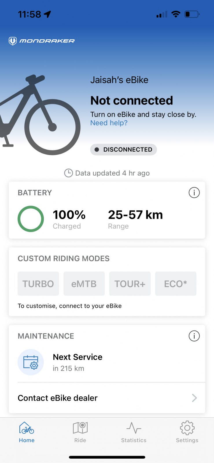

I’m having a similar issue with my Kiox 300 display. I did a 42km ride yesterday with about 750m of climbing all in Tour+ mode and at the start of the ride it estimated 46km range. At the end of the ride I still had 41% battery remaining so if you extrapolate that out it works out to about 71km range. I plugged my bike in today and charged it to 100% and it still estimates just 48km of range. It seems very conservative.

Its easily sorted by totally ignoring what the range says as it's too variable to be accurate.
Change your display to show battery percentage as that is the reading that matters.
Fair call but it would be nice if it just worked as intended. I have mine set up to show battery percentage in the top row and I usually use the screen that shows distance, time and speed on the display. I have the Kiox 300 so the display looks a bit different to yours. I’d still like the range to be more accurate because I often check the app when it’s charging and it’d be nice if that showed accurate estimates. Maybe it is just assuming that I am going to be riding on steeper terrain because yesterday was a pretty easy/flat ride compared to my regular rides.
