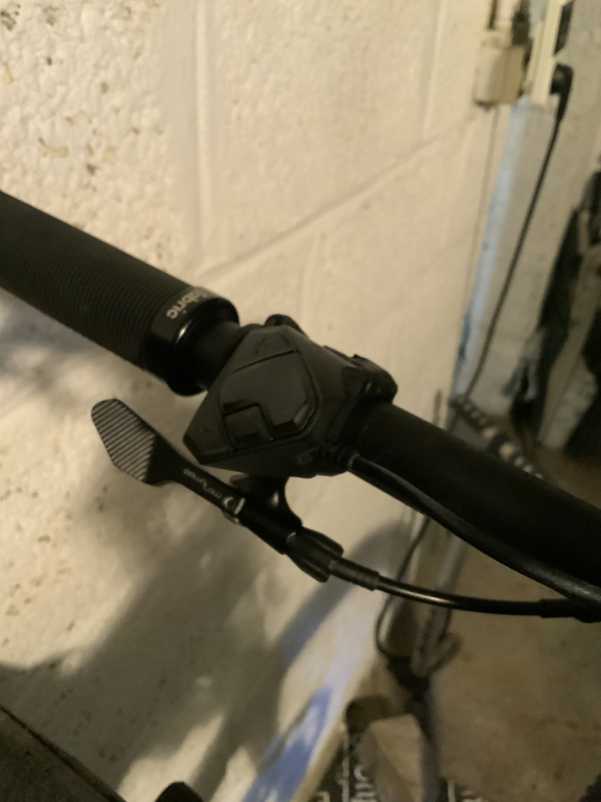

Hi,
Only my second ride out on my new bike and took a decent tumble over the handlebars. ??‍♂️
All good, but my Kiox Buttons strap has snapped?
Any solutions out there?
Thanks

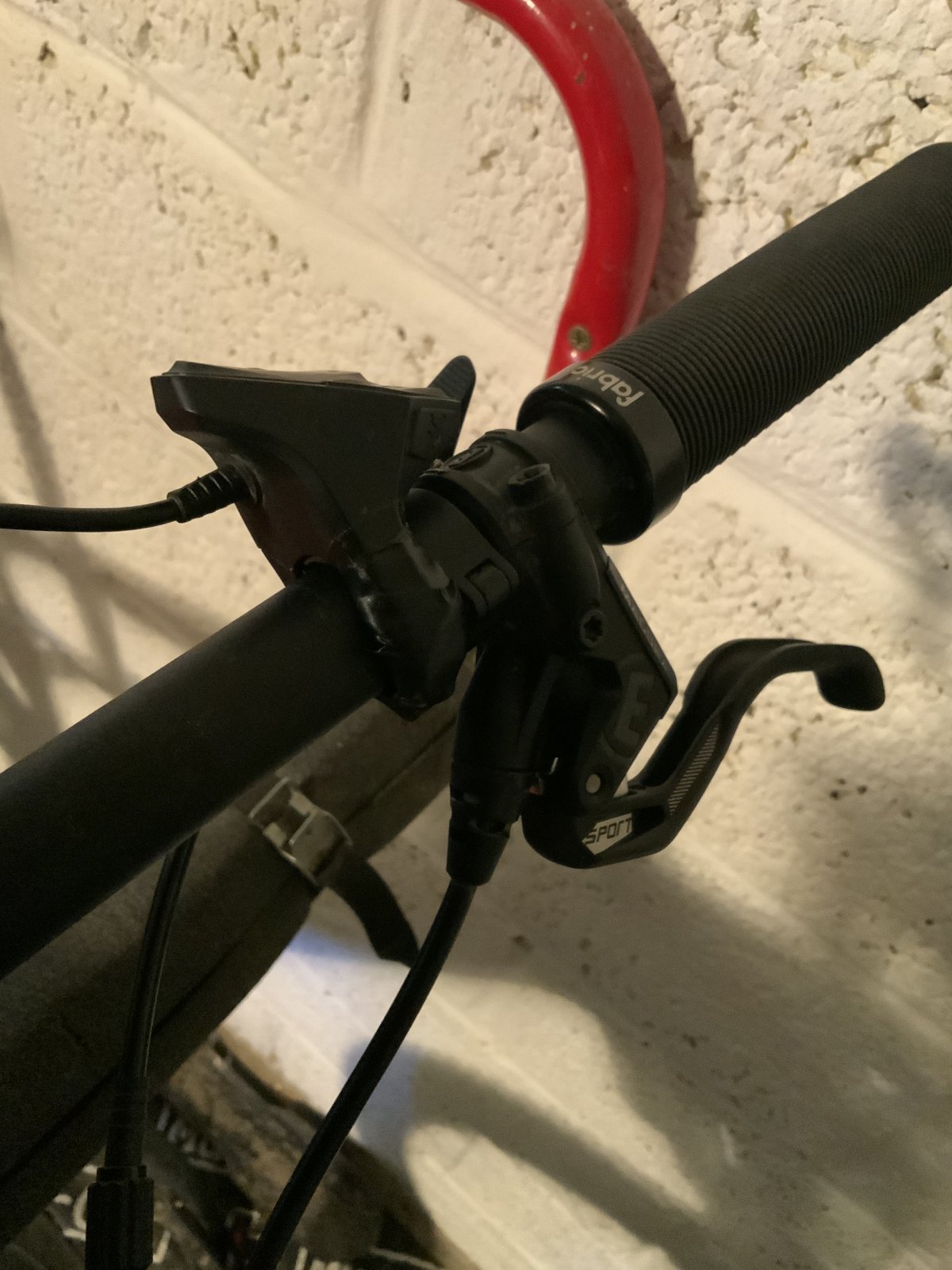

Ok, tried a araldite and no luck, I think the problem is there is such a small contact area at the break.
Any other suggestions? It’s really hard to clamp it together when glueing as it’s such an awkward shape.

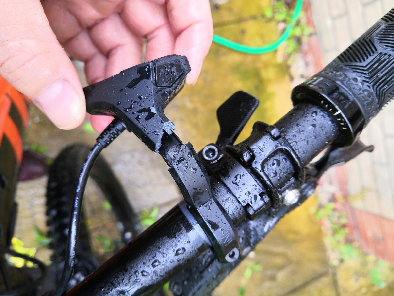

The same thing happened to me this week: one pedal was stuck in a rut and I felt on the Kiox buttons. They’re are still functioning but as on your picture the circle is broken and it is an integral part that cannot be replaced.
I am actually happy that my rib didn’t break as it the contact point is still painful. So the shock was not so light: the Kiox buttons do not seem so fragile.
I was considering to buy a replacement part (it can be found for 50€), as stupid as it may sound. I prepared myself but looking at some videos explaining how to mount the cable: there is event no need to wire things: the command comes with a cable terminated directly by the contacts for the Kiox screen. See
you just have to make sure you order the right cable length (290mm or 350mm).
but I tried first a repair.

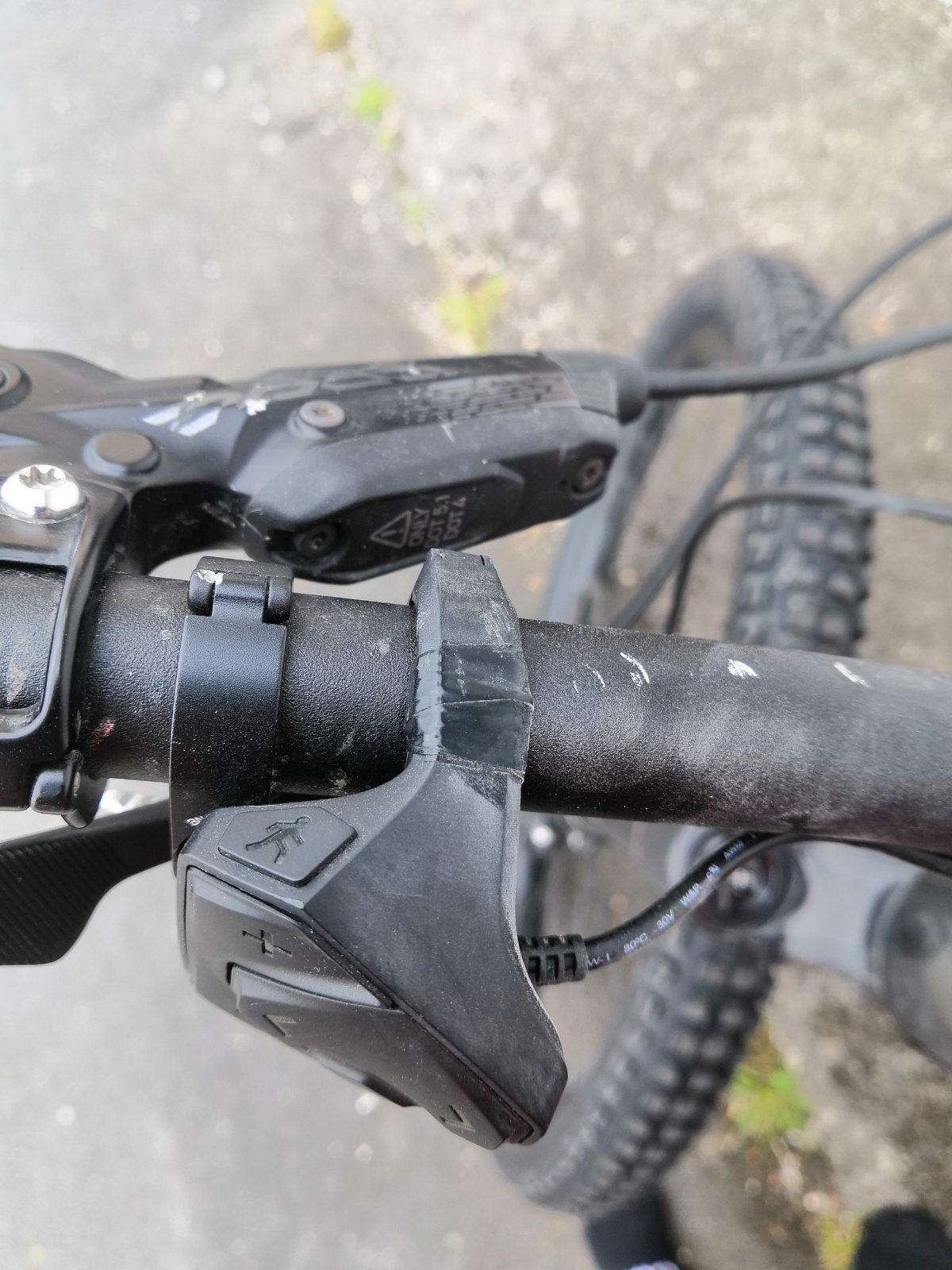

I doubt glue would be strong enough to repair, given the tension to pull the parts apart: although the underlying rubber has some relief that may help to reduce the tension on the plastic. I decided to rather use super strong tape doing about 6 turns perpendicular and around the Kiox broken ring. With the tape start-and end-cut positioned in a way that it would be compressed on the handlebarl. I used underneath first some “strong repair tape” and then some more pretty and more elastic all-weather black tape for finition of road bike handlebars.
To my surprise it works very well.I just have to avoid pressING super strongly the right button as that one is cantilevered.
Hence I postponed the replacement of the part indefinitely. I will eventually consider it is a last resort option.

That looks pretty good and seems a lot less fiddly than glue. I think I'll give that a try, thanks!

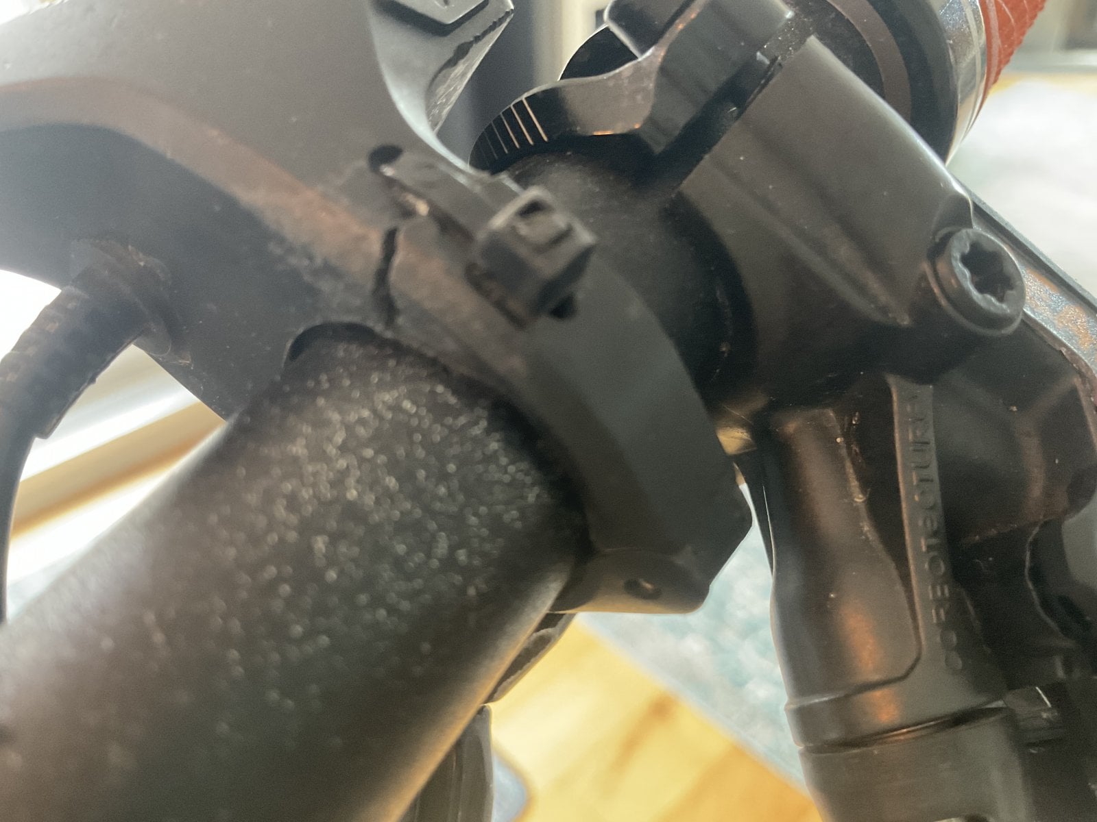

Same happened to me! Looks exactly the same
drill a small hole in both sides of the break (just big enough for nylon tie strap) strap it and glue it!
mine has held beautifully
mine has held beautifully View attachment 86362
I think your approach is much more resistant …but a bit more complicated and a bit less visually appealing than the glue+tighten black tape.
Note that the rubber part in contact with the handle bar has a kind of « notch » which I think already renforces the circular solidity if it is tightly fixed to the main plastics with the tape.
