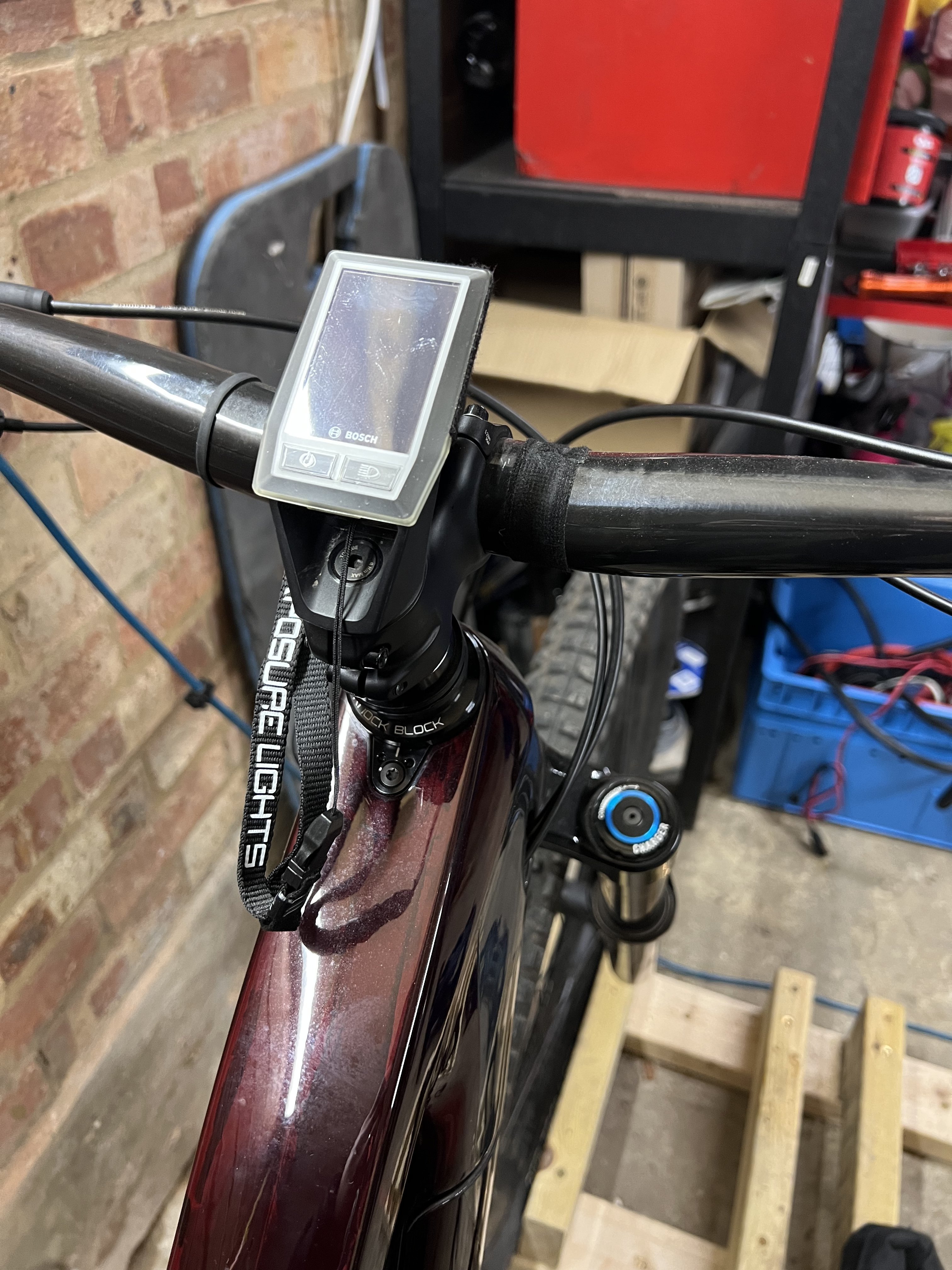

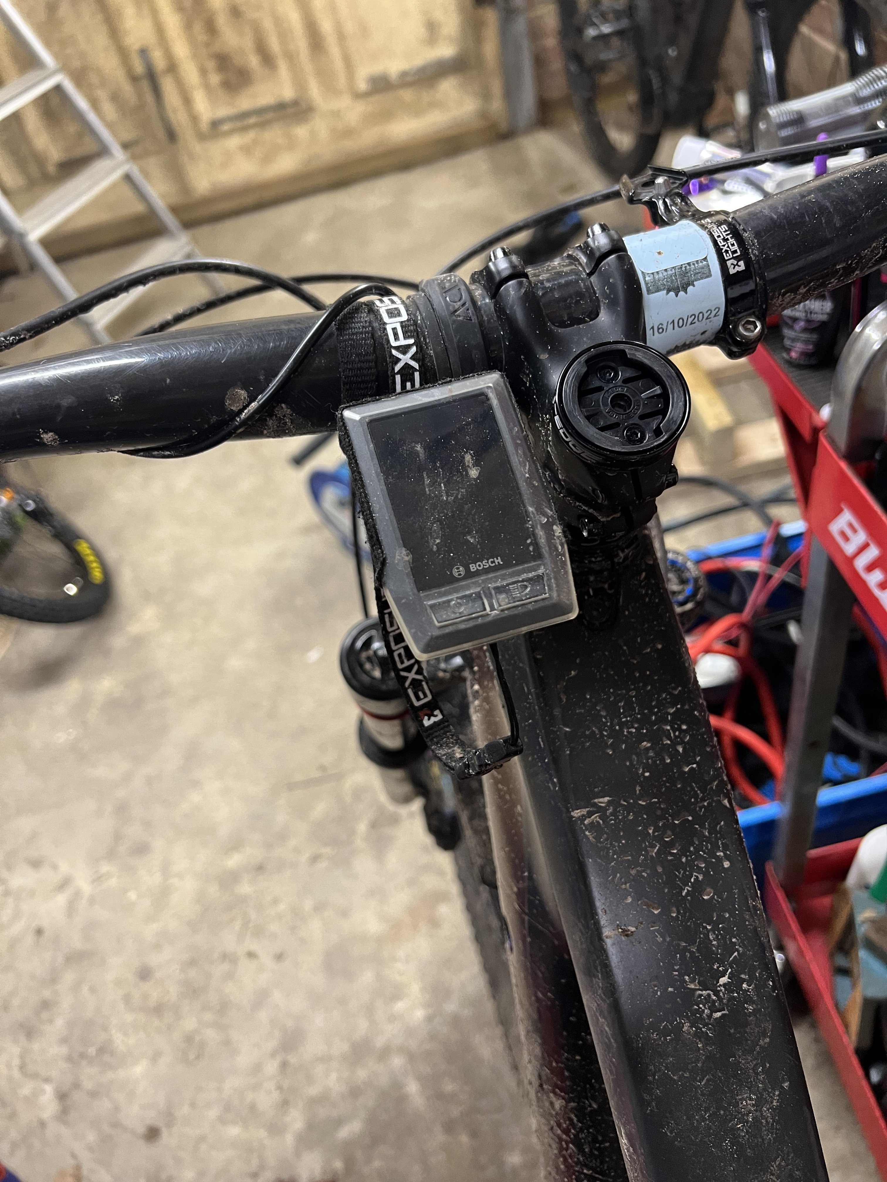

I have had both the shotgun pro seat and the Mac ride. I had to re-locate my kiox to the top cap and the handlebars (done it on both mine and the Mrs) and then you need a knock block specific spacer (they sell them on the shotgun website) before you can fit the washer required for the seat.
Hope that helps 👍

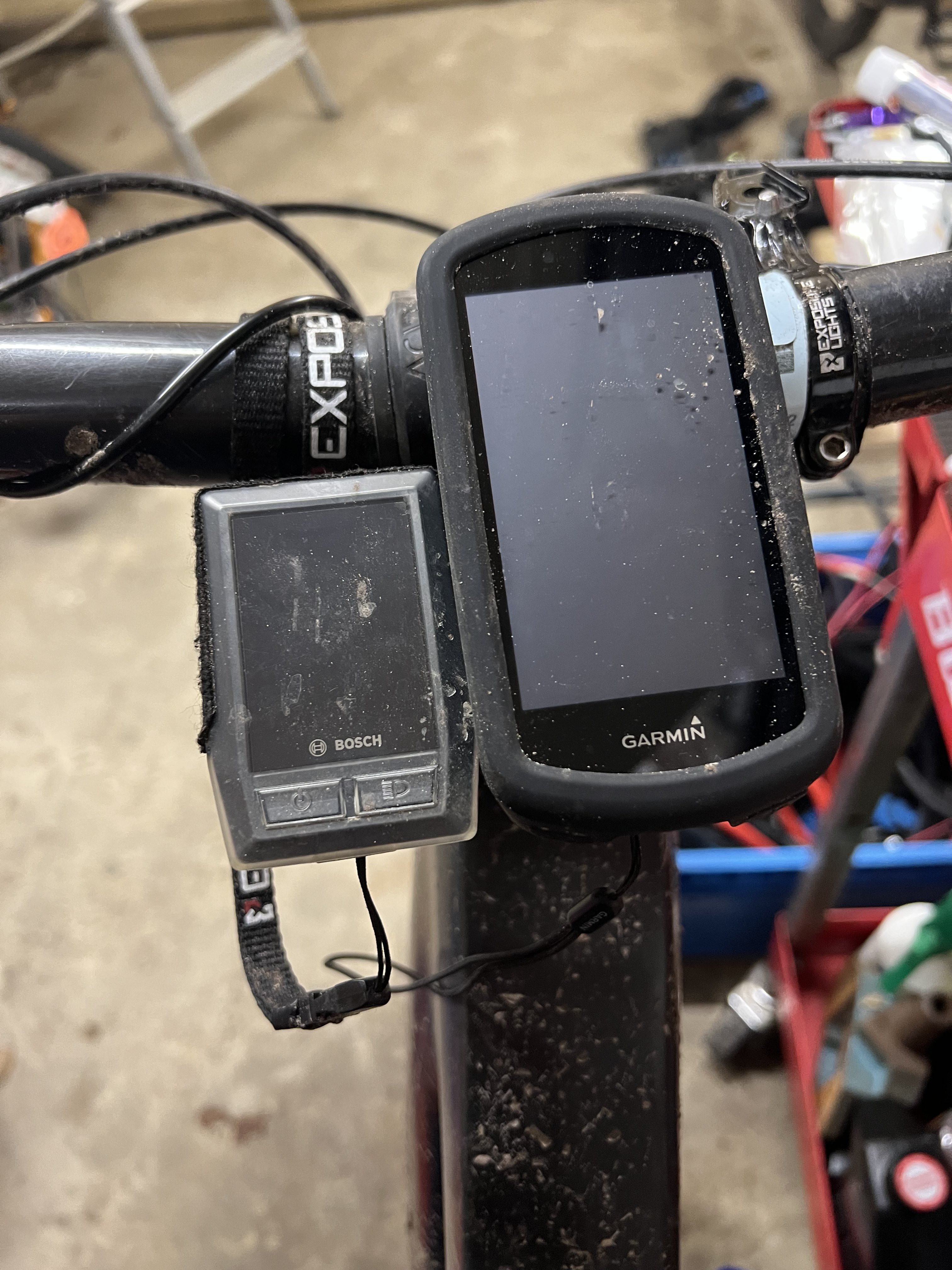

I used a acid mount for the bars and just a generic stem top cap plastic mount for the other one. Both work fine, reason I went with the bar mount one is because I have a k-edge garmin mount top cap on my rail.
Hope that helps 👍

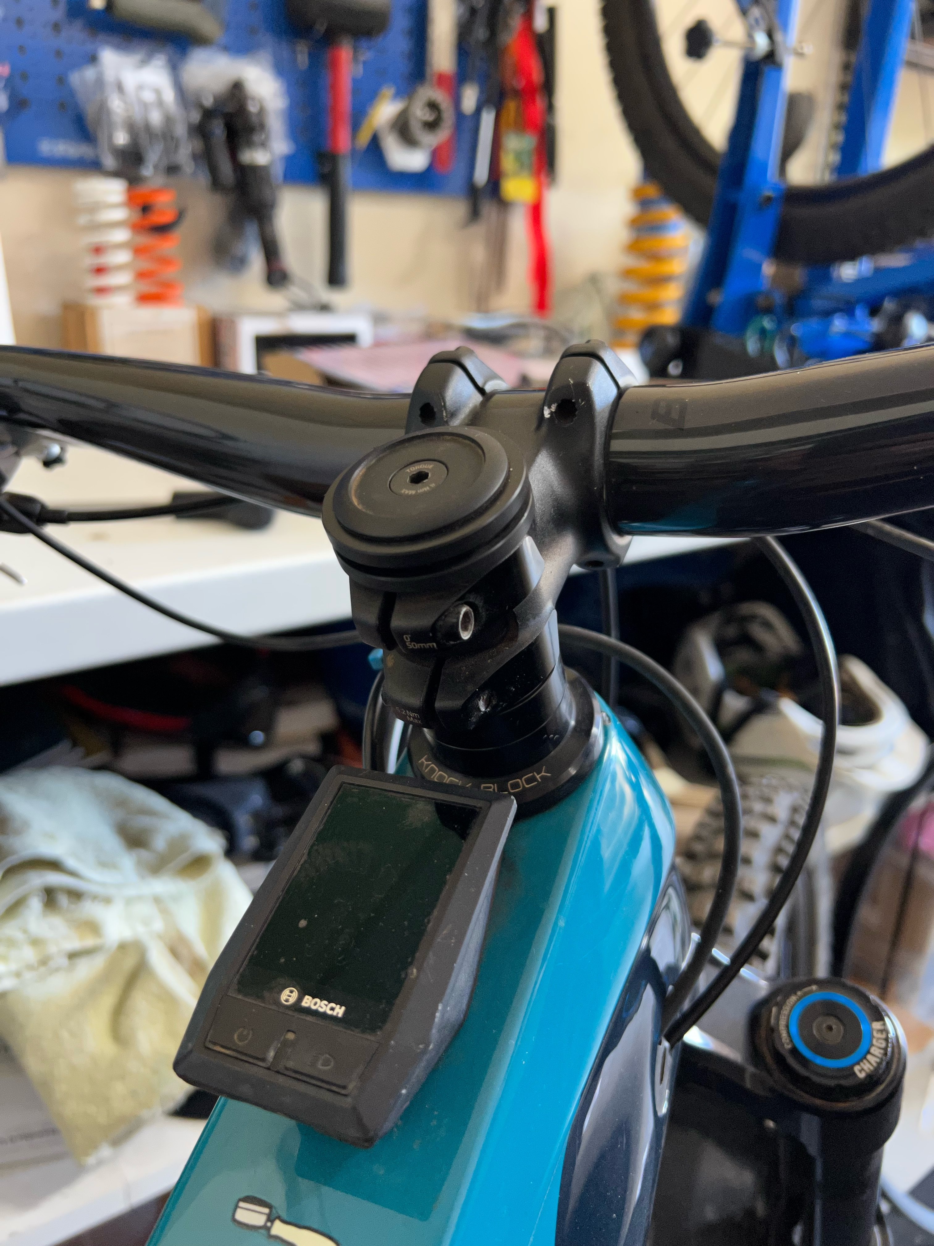

I installed the Kids Ride Shotgun Pro spacer above the stem. It raises the Shotgun high enough above the Kiox display. So I have two knock block spacers under my stem and the shotgun spacer above my stem held in place by the top cap. Keep an eye on the top cap bolt torque but I have had dozens of great rides with my kids this way.
Oh, I hadn’t even considered that but thank you for showing me that!
For the longest time, I was trying to figure out how to relocate the Kiox if I was using the shotgun handle bars as well since most relocation mounts mount on the handlebars right adjacent to the stem but the shotgun handlebars would take up that space.
One other thing. To stop the bolt that clamps the shotgun onto the stem from hitting the stem, I swapped the shotgun bolt for one with a smaller head. I have to use an Allen key to install it but that works for me.
