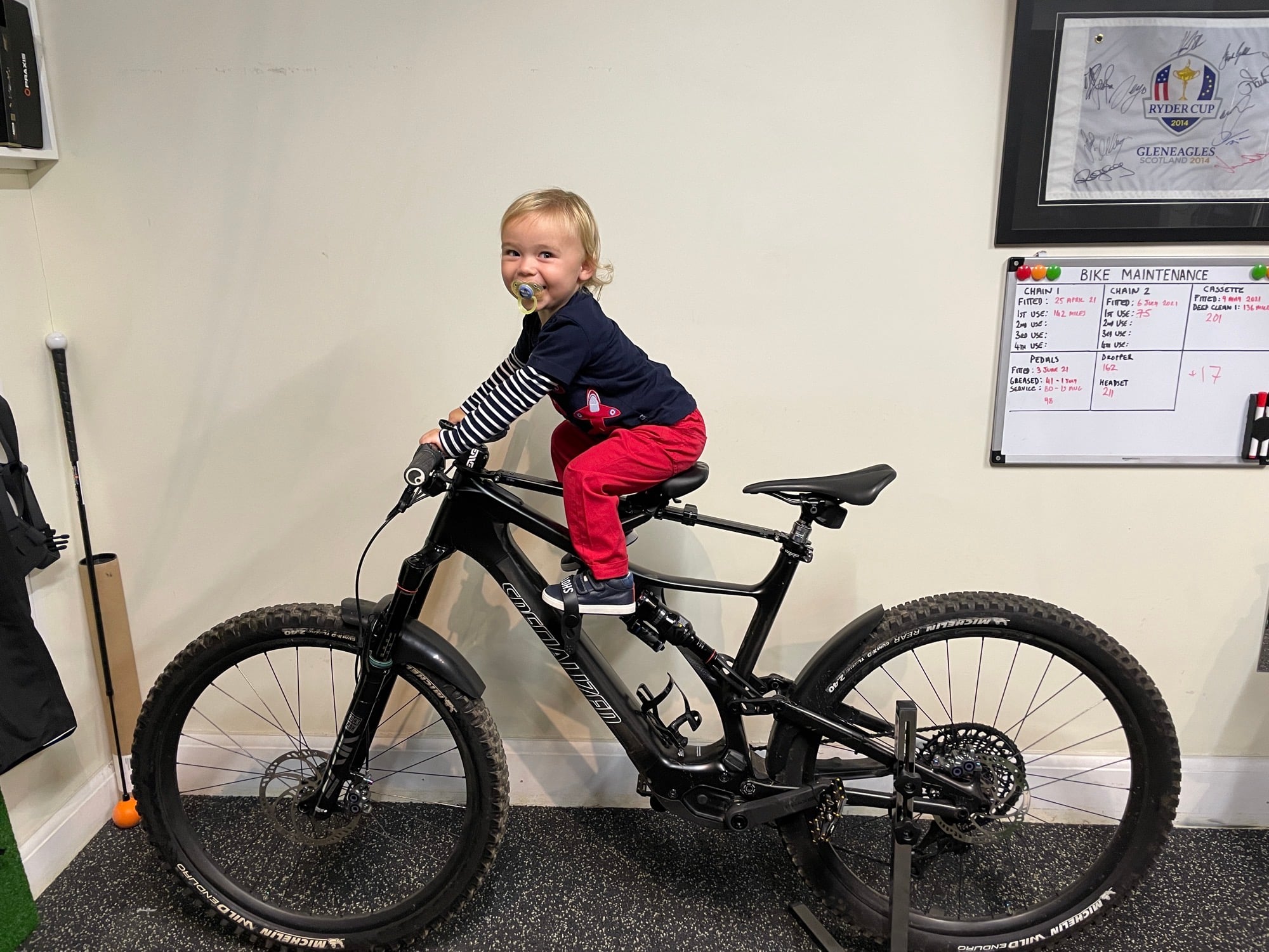

I pre-ordered the Pro when they announced it would work with eMTB's as it handled a wider frame. At that time, my boy wasn't even 2 - so I figured he'd enjoy going round the woods with dad. It arrived at the end of September - just as the UK gets cold and wet. I tried it once, but he complained about holding the bars with gloves on and how cold his hands were. Over the next few months, they announced their own handlebars, so I ordered them too. Used them once - but by the time they arrived, he was 3 and had got his own "big boy" bike for his 3rd birthday.
A few months later, he was on 2 wheels and had no desire to be stuck on my bike when he could ride his own!!
I sold it all on ebay in fantastic condition (used twice - and a couple of laps round the block for sizing!) and got a decent amount back for it. The timing was just unfortunate... if it had arrived at the start of spring and he was still 2, I'd have probably got some real use out of it. It's a really good well made piece of kit., and takes about 30 seconds to fit / remove once you have the stem adapter fitted.

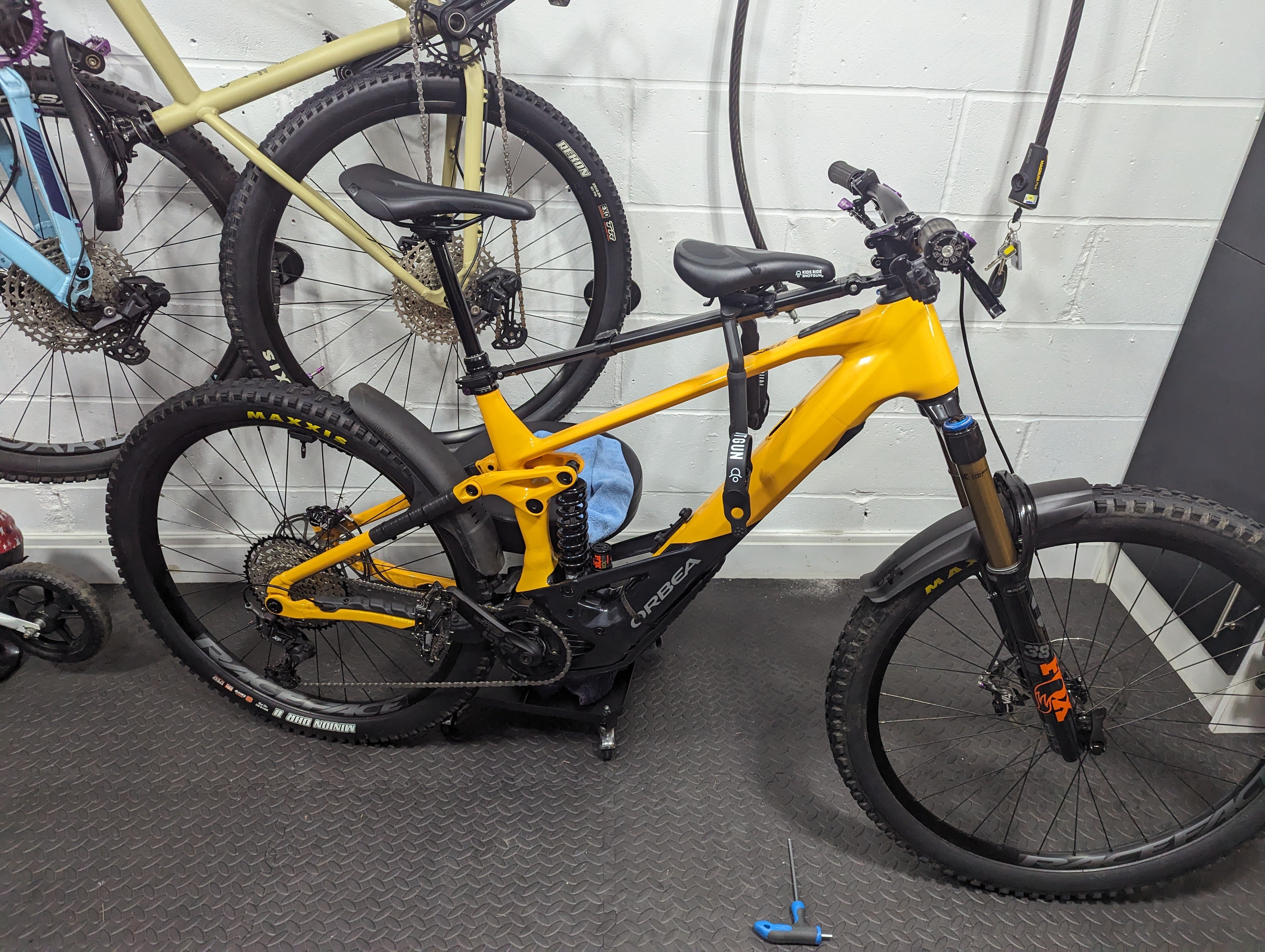

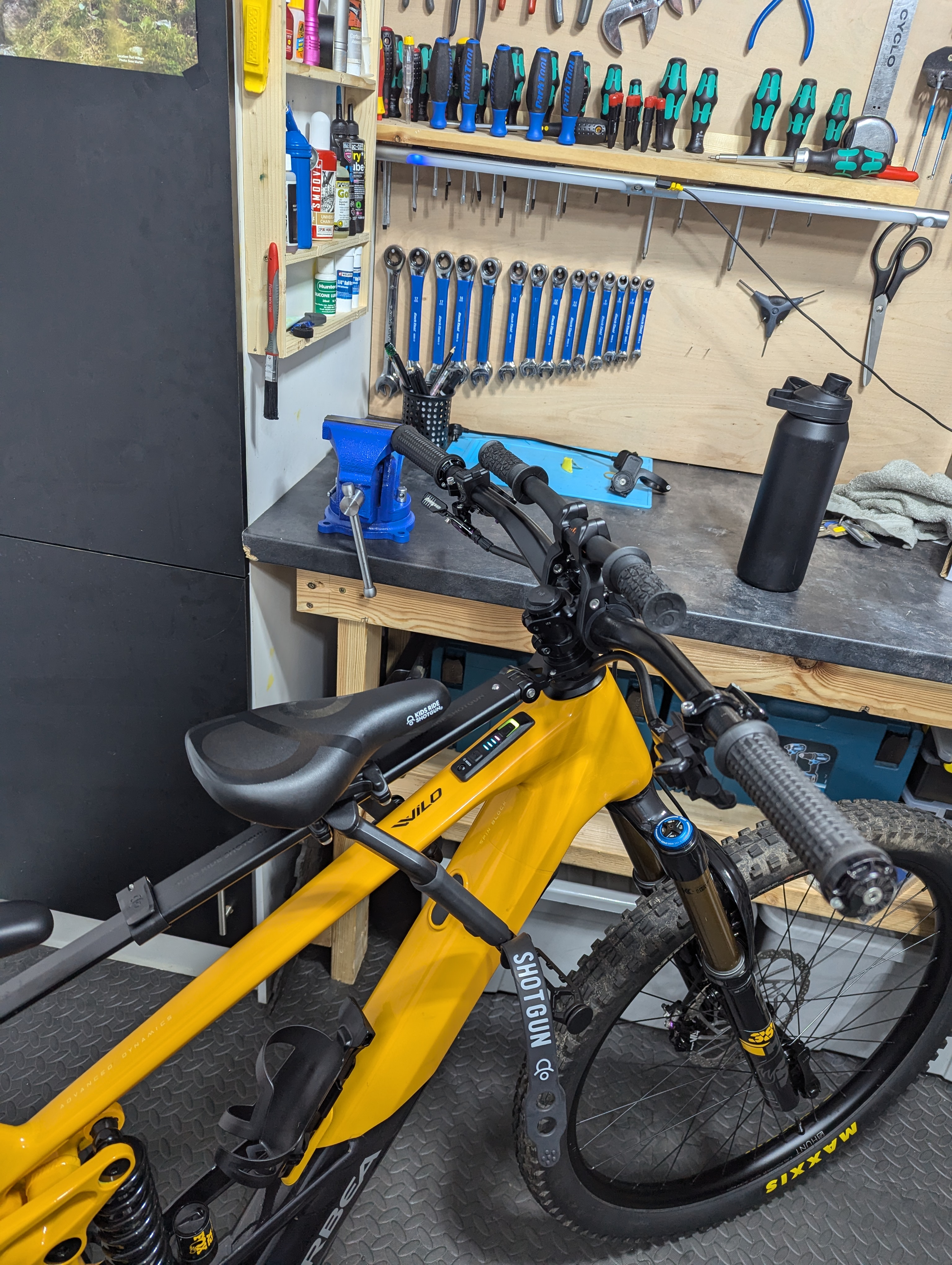

Hi
I am buying orbea wild and happy to see that kidsrideshotgun can be mounted on it. Here in Slovenia (Europe)dealer said that it is not possible. It was dealbreaker for me. @DrDexx is it possible to post a few additional pictures around stem, that i can see how it works and send it to dealer for purchase this part.
Thanks in advance
Regards
R
You need the SIC HS02-06 universal headset cable collector for HS02 internal cabling headset.
This allows you to use a normal stem and headset spacers, although this will allow the top of the Fork to hit the downtube if you have a smaller frame. Not an issue for me on a XL, but not sure about smaller sizes.
I've attached a picture with a different angle so hopefully you can get a better view. The headseat routed cables make it a little more of a faff than it should be, but still not an issue.
