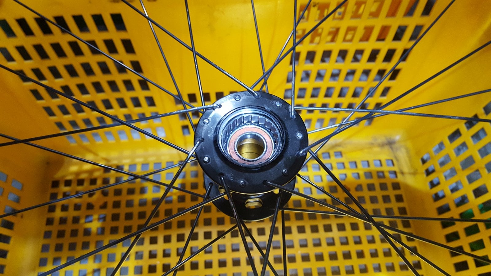

Hi Forum,
I'm can't seem to find any info on rear hub drive side bearing removal for a stock 2018 Kenevo. From what I have found I have a feeling I need a special tool to remove the (threaded?) pawls ring (not sure what the name of it is). I am pretty sure it doesn't hammer out the non-drive side. The axle does not have a lip on it either so I can't use the axle to pound it out. Has anyone removed this bearing? Can you give me some info?
Thanks!

I had my bearings replaced by my LBS. Getting them out was quite a job. They are supposed to tap out but mine were stuck fast. They had to heat the hub then really hammer them out. You don't need to/can't remove the ratchet ring.

TPP, thanks for the info. Do you know which way the drive side bearing punches out?
After examining it and rationalizing I figured there was no way the bearing could go out the non-drive side as it is pressed up against a lip in the hub. So does the bearing punch past the ratchet ring?

For anyone working on their 2018 Kenevo hub...
I can confirm that the drive side bearing punches out past the freehub ratchet ring. Holy moly it was in there tight though. Bearing is Enduro 6903. Drive and non-drive side.

Punched out with a socket extension bar.
Repalace with $10 Aud bearings. Bashed in with suitable size socket. Easy peasy

heat it up. it will pop out

Just heat it up. it pops right out.....

I’ve just changed my bearings in the rear wheel. First issue I had was that the largest bearing puller from the kit Iordered from Bearingprotools did not seem to fit properly and failed to remove the bearing. This was because I did not realise that the kit for my bike was just for the suspension linkages. Jim from bearingprotools has been very helpful and has since sent me the correct puller. In the meantime I managed to bash the bearings out with a drift once I had heated the hub with a hair dryer (good tip from this thread) and the press from bearingprotools worked well to press in the new bearings. However, second issue was that I ordered 6903 bearings but did not realise that 6903 bearings come in different sizes and mine had a 18mm internal diameter so when I put it all together the axle was slopping around in too large a hole! Back to square one, drift these bearings out, down to the LBS to get the correct bearings with 17mm internal diameter and press them in. Job done, eventually and some lessons learned!

No mate.....all 6903 bearings are 17/30/7.
The 18/30/7 bearing is called 18307......... but used to have the name 61903.

So what are these that I ordered? My LBS definitely said 6903 come in 2 different internal widths and the bearings that were sent are definitely 18mm and are marked 6903.

18307 which is as the order says is 18x30x7 rather than 17x30x7. You are better buying from a Bearing specialist who will also have a choice of bearing qualities and seal types. Bearing vary in terms of material used for the ball bearings and cage and the tolerance to which the ball bearings are manufactured ( e.g ABEC 3) as well as the type of seal used on each side . A decent version of this bearing can cost 3 to 4 as much as the cheapest. I change wheel bearings annually so go for a mid price range..........I use Enduro Bearings and for the rear hub I use 6903-2RS.
