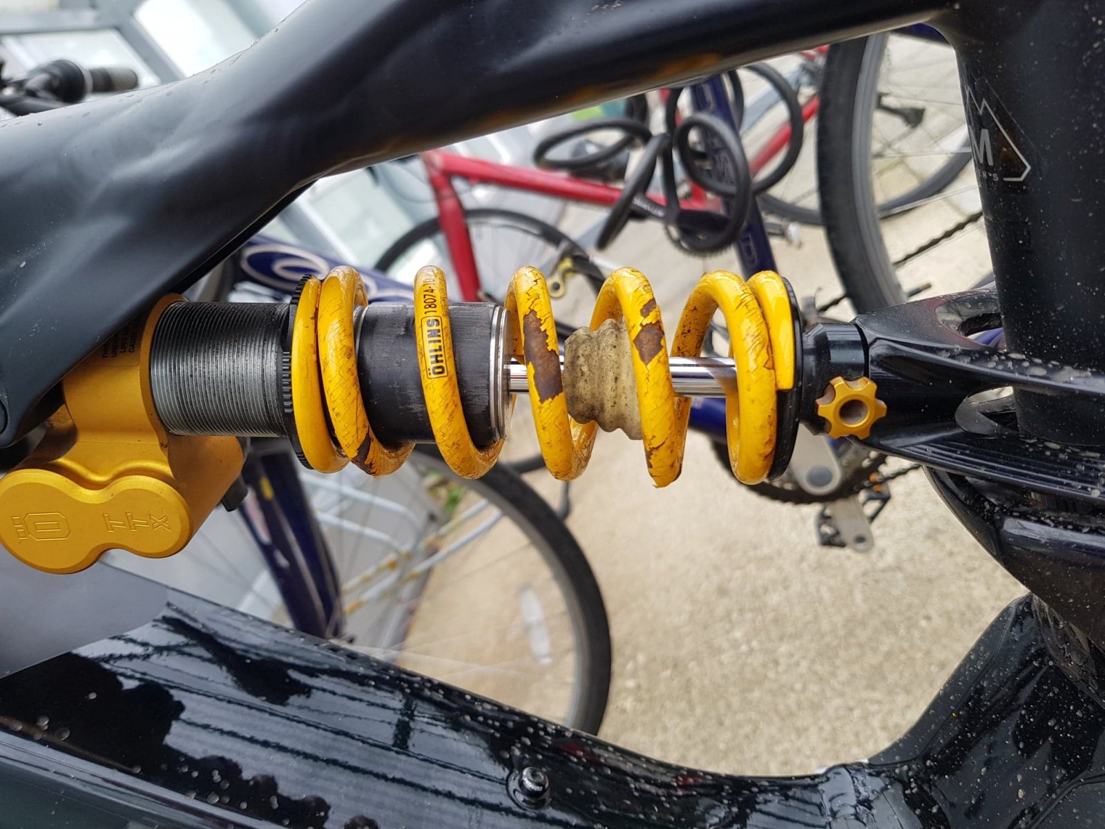

Hello,
I am looking for some help and advice please from anyone with previous experience on my issue. In short, owned my Kenevo since last October(ish) and noticed that the coating of my Ohlins coil is coming off and the coil is rusting!!! The word wtf left my mouth a few times... not like this is a bike from toys r us. ' Aware toys r us are no more ' .
I have never owned a full sus bike before so for all i know this is quite normal although i can't see how the product can be fit for purpose if within a few months i essentially need a new coil ( or do I ) i don't know it certainly doesn't look great though on a 5.5k bike!!
Anyhow i have been in contact with Tredz who in turn spoke with Specialized who both agreed that it was in fact quite normal ( i have asked them to review ) mainly because the bike has had no heavy use, it is used everyday but for commuting.
I suppose it would be good to get some ideas of what my options are, is this normal or should i get a replacement under warranty? It should last at least a year right?
Or should i just buy another coil - reluctantly? The bike is going to be sold in a a couple of months, will this coil last that long?
If this coil isn't defective why on earth do Ohlins or Specialized use these coils!!??
Really appreciate any help that can be given, any experience shared - thus far i know very little.
Many Thanks in advance
All the best
George

How many miles on it?
Hi R120,
The Mission control app says 1010.49km, probably seems pretty far although like I said the bike is my daily commute, no heavy riding ( I just wanted a really good bike :) )
Here is the email convo from the supplier. I am 65 kg's and wanted to go for a small but the shop assured me that the medium was the right bike for me.
Hi George,
Specialized have got back to us regarding your spring. Below is what they have told us.
Thanks for your email, I'm afraid this type of paint loss from the coil is something we have seen before and is a little but unavoidable as clearly the spring is a moving part and the paint is static so doesn't flex with the spring.
One thing that may exaggerate this wear would be if the coil is a little light for the rider's weight and they have to add preload causing the spring to be compressed for longer amounts of time. Would you be able to let me know the rider's weight and if they have ever changed the spring from the 457lb/in that is supplied on the medium Kenevo?
If you can let me know the above information I'm sure I'll be able to help further.
Kind regards,
Please could we have some information to be able to go to Specialized with further information should there be anything else that we can do to help on this issue.
I would say on this issue that we would agree with what has been said on this, however if there is anything further that you can give to us to prove otherwise, we are happy to put this forward for you.
Hi xxxxxxxxxx,
Thanks for the follow up email. All shock settings have been left as stock since the bike delivered to me mainly because everything felt sweet. I am 65kg and spent a lot of time debating between small and medium the lady on the phone assured me that medium was the right size for me. Fully appreciate the response I would add though that the bike is really only used for commuting and doesn't get any kind of heavy use - does seem a bit odd on that basis and for the age of the shock/cost etc.
Thanks again really hope something can be done
Cheers
George

I would be inclined to save myself the agro and just paint it myself rather than fuck about sending it back and having no bike for weeks on end.

Your coil spring should not look like that. Try dealing with Ohlins directly. This is what my spring looked like after 3000 miles of hard riding.

The only reason I could see that happening is if the paint had been badly chipped and water got under, other wise shouldn't happen.

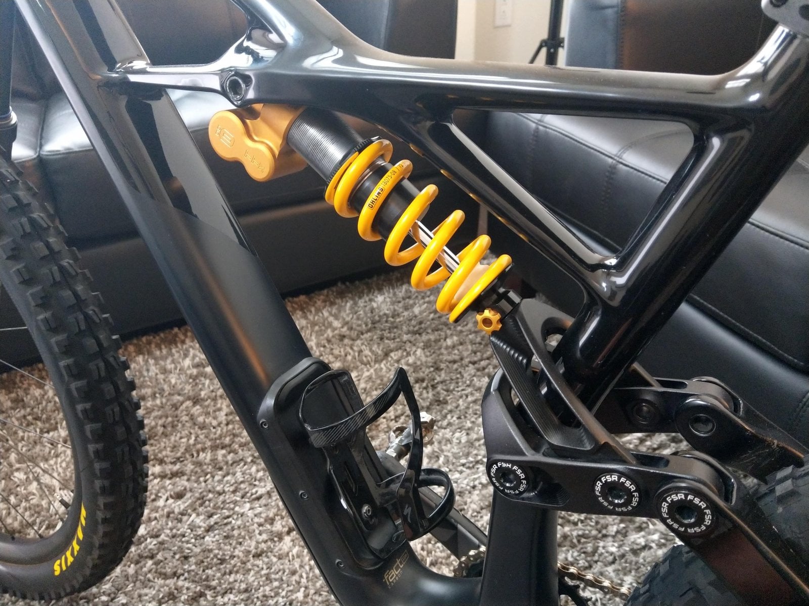

You must have an awesome commute if you need a kenevo. My spring looks like new after 6 months of abuse.
Dax, sadly it's on the flat and I never needed the Kenevo I just wanted one. I've always owned good push bikes. Was a dealer for lower end ebikes ( before the mid drive bikes came out ) was always frustrated with the cheap components on them so as soon as the opportunity came up to get an all singing all dancing ebike I jumped on it.....and here we are

i think they key thing is you use it for commuting, with all the salt and grit on roads i am not surprised to see it starting to rust, i use mine soley for MTBing and coverd a hard 2500miles on it now and the spring is fine but i am not introducing it to road salt etc..maybe that is why yours is rusting

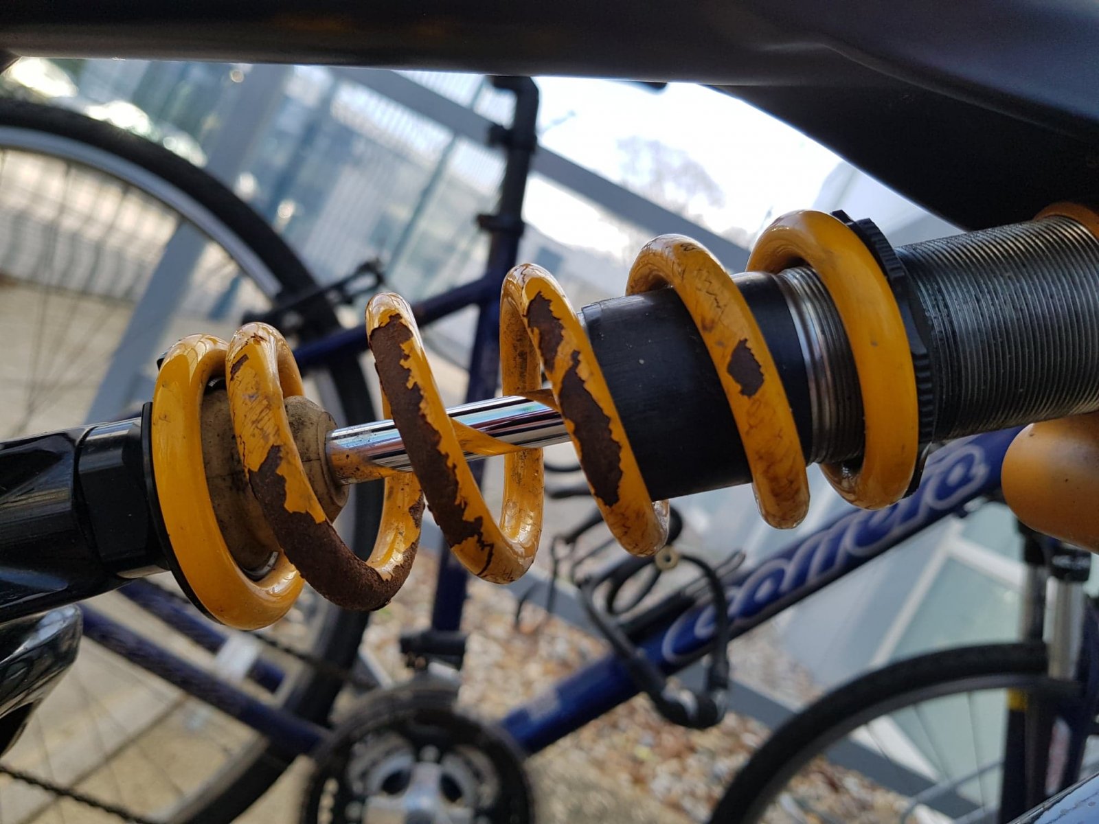

looks like you both have an awful lot of preload on your springs, not sure if you like to run it hard but if your 65kg and its wound up that tight then you probably are not utilising the spring to its potential. First thing I ordered was a replacement spring to be equal to my body weight, its due to arrive this week, i will have a stock spring from a size medicum that should be for sale if you want if you have no luch with a replacement.

hi there, the recommedned sag is about 20-30% depending on your riding style etc, you can google loads of videos how to adjust this online.
I live near loch lomond in scotland. New one is £55 so probs about £30 ish.

it is the amount of suspension used when sat gently on the bike. If the spring is not tight enough you might have a greater sag than the 20-30% and if its too tightly wound down then you the sag will be less and you wont be getting maximum travel or feel from the suspension. Yes, that bit is how you set the preload. there is a little rubber bit that slides on the piston to show how much of the travel has been used. work out the % compered with the piston length to get your sag value. It has the same effect as putting more or less air in an air spring. Given how much yours was wound down and how light you are there cant bne much movement in the rear suspension.

This issue I believe is down to a very poor paint job on the spring and possibly the ‘painter’ using the wrong type of paint?
It obviously has not been prepared properly before it was painted.
If there is rust underneath already I suspect it wasn’t cleaned, rust proof coated or a proper under coat used on it before the top coats went on....
I suggest you go direct to Ohlins as they need to pick this up as they clearly have a supplier that is not doing any quality control on their painting process/practices.

i certainly dontthink you will snap the spring, are you only 65 kg? what position do you have the little lever in on the other side. (it has 3 settlings?) its best to actually measure it then work out the sag.
Simon,
That's good to know, part of my worry was that i might be riding along and the spring gives way on me!! The adjuster is in the middle position. I'll do the measure test later on. In the meantime have dropped Ohlins a message.
