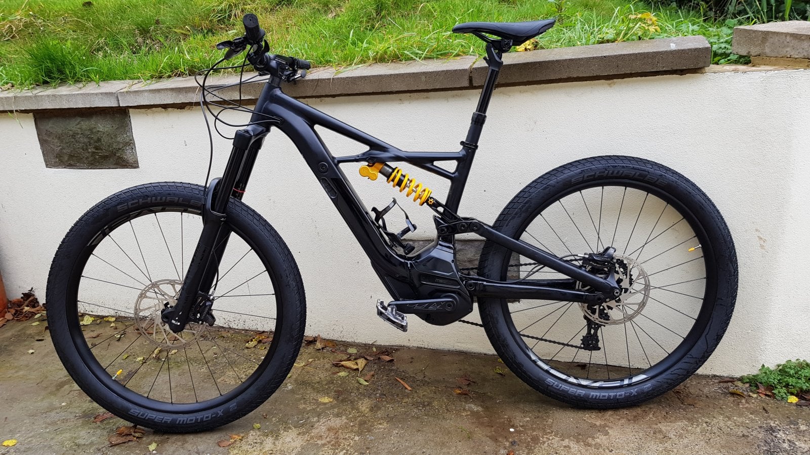

I even commute on mine a few times a week with my spare set of wheels sporting Schwalbe Supermotos...coolest commuter in town!

The Kenevo is a do anything bike and you will love it. Bike parks, DH, epic xcountry rides, View attachment 8198 I even commute on mine a few times a week with my spare set of wheels sporting Schwalbe Supermotos...coolest commuter in town!
