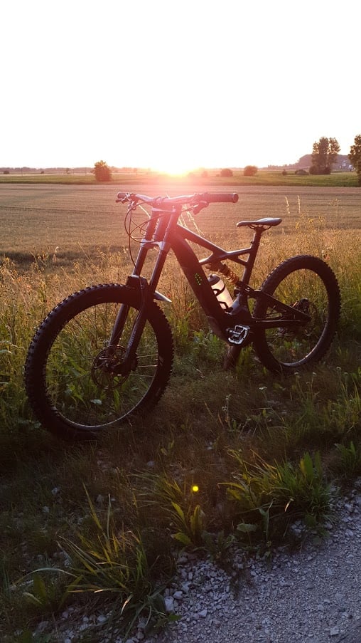

I am Chris from Germany and I found this post in this forum about upgrading a Kenevo with a DH boxxer.
Because I wanted to do the very same to my Kenevo, I wanted to ask you all about the things I need to buy for that, because I got a little scared by some blogs which made it look complicated or easy to get some things wrong.
I am currently riding 2.6" Magic Marry DH on the stock wheels front and rear and want to keep that. My hope is that I re-raise the BB a bit again with the DH fork. My plan is also to buy a new complete front wheel so I can go back to the Lyrik when I need/want to.
Would some of you guys do me a favour and create a kind of shopping list of things I need to get this to work? Cheers lads!
e.g. Stem, Headset Adapter (Cane Creek?).
Longlivenduro
Jun 27, 2019
20
17
Ok Thanks grayedout for this post! This is my shopping list for the DH fork conversion:
1x Rock Shox BoXXer World Cup DebonAir 29" black 2019: 999 Euro
1x DT Swiss FR 1950 Classic 27.5" Boost Frontwheel (no adapter needed, it is 20x110): 329 Euro
1x CANE CREEK crown race 40er series EC/ZS/IS52 | 1 1/2" reducer to 1 1/8" steel 9,50 EUR
1x SYNTACE Spacer SET 1 1/8" Universal: 4,50 Euro
1x TRUVATIV Stem Descendant 35 mm Direct Mount: 57,50 Euro
1x RACE FACE Handle Bar Atlas 35 20 mm Riser 35 x 820 mm colored stealth: 77,50 Euro
I hope I didn't forget anything. If so, please let me know.
FYI: I ran and will run Magic Marry 2.6 DH Addix super soft front and rear. Cheap, full of traction and could'nt yet get it to have a flat.
Longlivenduro
Jun 27, 2019
20
17
Semms your list is Ok, the only diference is that mi mechanic rather prefeer using a 15x110 Hub plus adaptors, this is because the breake disc alignement.
Cheers Andrés, hmm didn't check the brake position honestly. It just works very good. I should re-check though. What should I look after?, i.e. what might be wrong with disc brake alignment?
Longlivenduro
Jun 27, 2019
20
17
SWEEEEEEEET!!!!!!!!!!!!!!!!!!!!!!!!!!!!!!!!!!!
Cheers!
