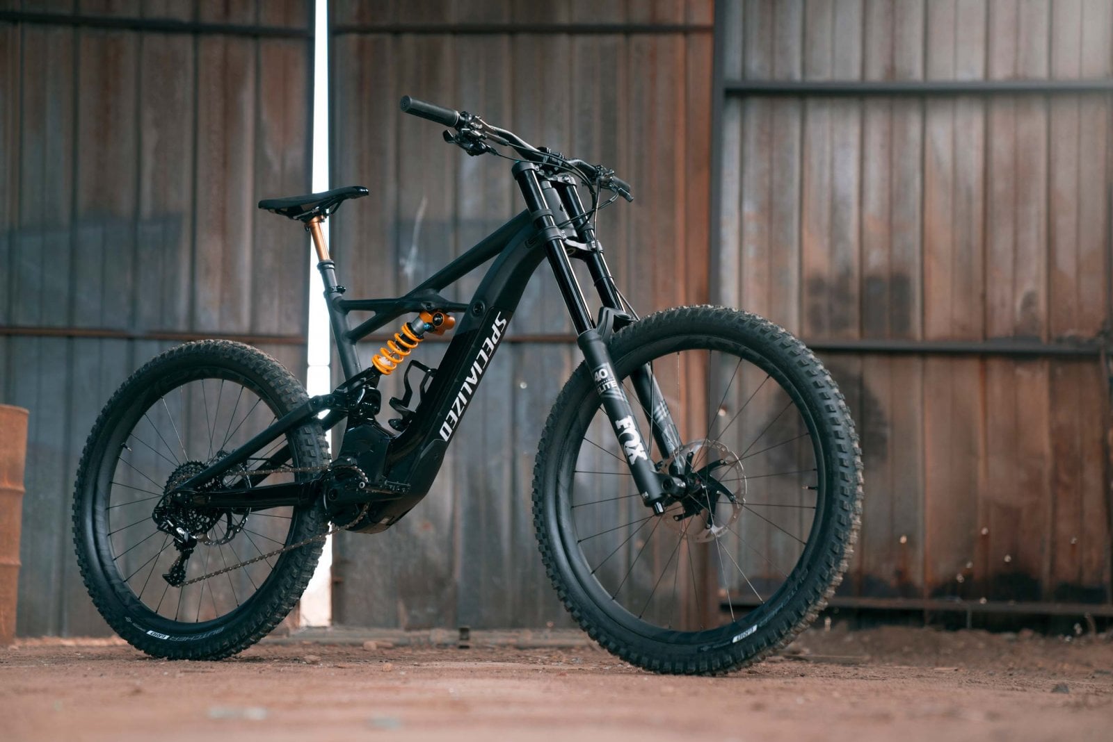

The Forks just arrive from Italy , can't wait! I think this could be some of the first sets in the UK i was unable to order these anywhere online in England but found this supplier my mistake on Italian ebay thank you google :)...
The build starts .... "BoXXer RC DebonAir™ 29”"

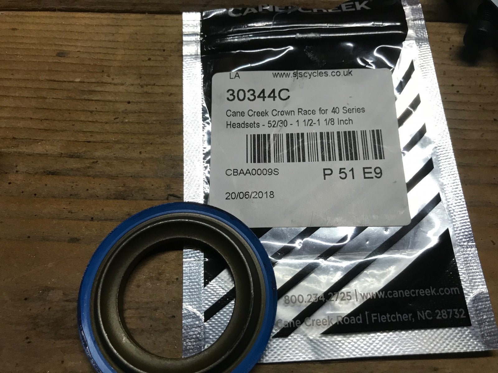

First Job was fit the Cane creek - 1 1/8” to 1 1/2” crown race adapter , really simple just used a bit of wood and a hammer to get it in place.

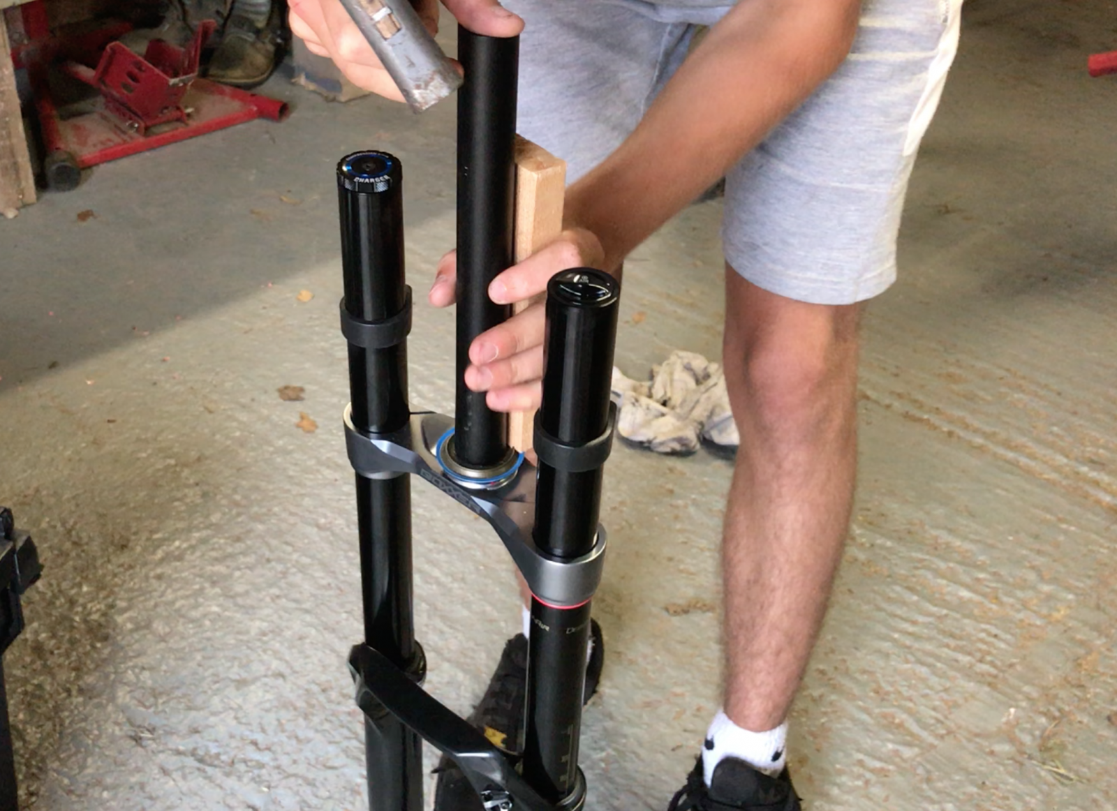

Next take old forks off and test fit new one to measure for cutting the tube down. We used a cheap Pipe cutter I had in my tool box cost £2.99 its take about 20min of turning!! (as its make for copper pipe) you can buy a better cutter for steel pipe about £29 at screw fix. great thing about the little cheap cutter is you don't have to loosen the bottom
