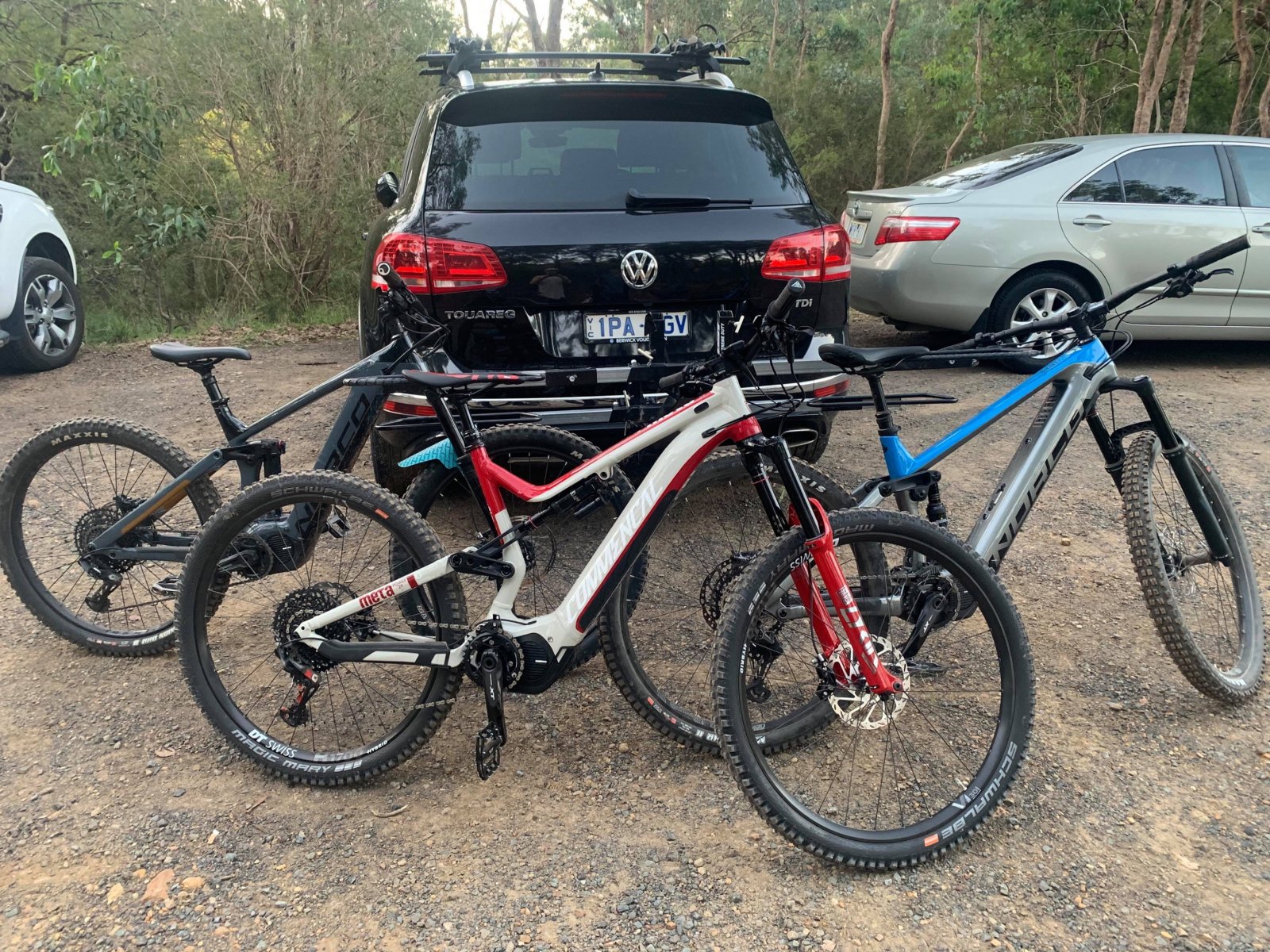

Hey all, as of yesterday I'm proud to call myself a Commencal Meta Power 29 owner. I've got it all together, just need to tune it up and take it on its maiden voyage.
Commencal looks to have done an awesome job, design, colour scheme and specs seem really well thought out. For the longer term owners out there, can you recommend any must have mods or tweaks to get the most out of your bike? I've been running 2.6's on my previous bike to good effect, are the 2.35's sufficient, they seem thin given other manufactures specs? Are the factory pedals any good? I've never owned any SRAM components, any changes here? Also any tips or good tutorials for suspension setup on the Lyrics?
I've been mostly hands off in the past, but putting the bike together has me inspired to get my hands dirty.

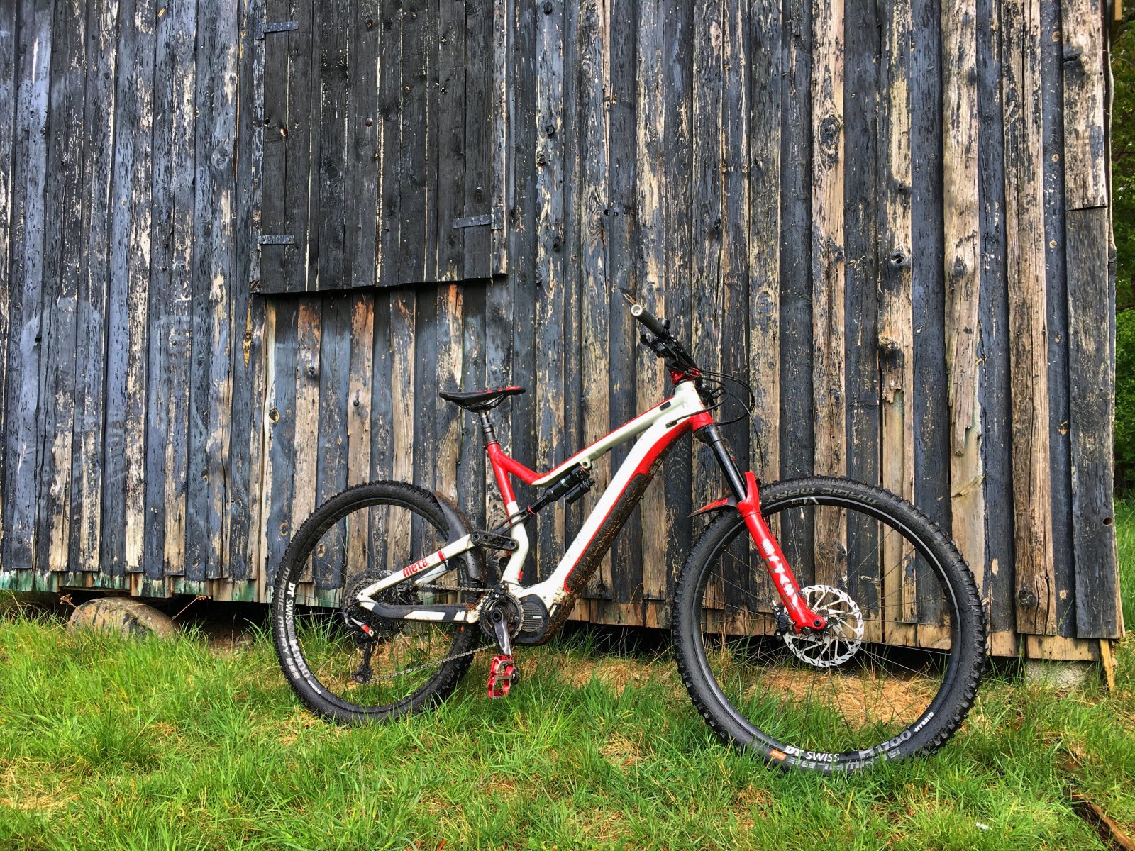

Nice looking bike. Welcome.
Go tubeless. I'm happy with stock Magic Mary and Hans Dampf and I'm heavy. Good predictable grip on most surfaces at about 23psi.
For UK winter riding I fitted a mudhugger rear and front on the back to protect my back, the seat post and the motor and bearings. The stock front Commencal mudguard is too short and lets a lot of stuff hit the bike.
Invisiframe or similar before riding. Last yeas paint chips really easily and touch up is not available.

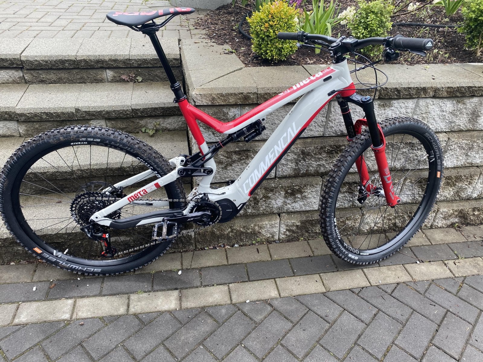

Me too. Just back from my first ride. I like it!
Need to tinker with the suspension a bit, and I think I want bigger tires + cush core maybe?
