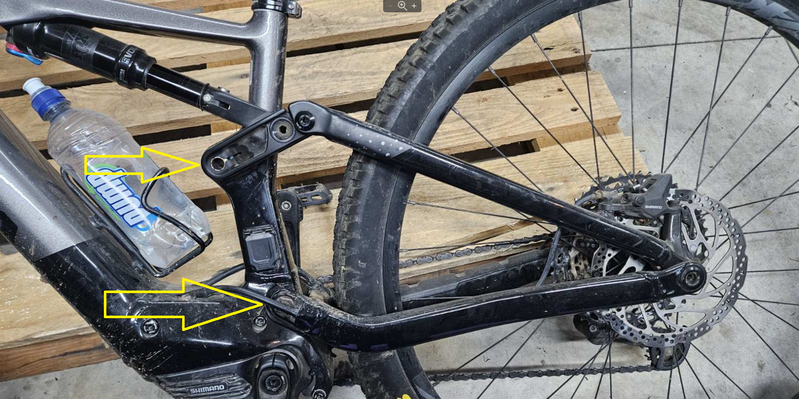

Ahhhh.... ok, that's a different fish then. The Orbea Rise is a light weight bike with light wheels forks on it. Its too light for you particularly for jumping. She'll be flexing on g-out of the take off face and pinging you off line, Yourl also find it more difficult on burms and chunk too. Its just too light. At 19st you need a solid enduro spec bike with zebs or fox 38's or similar.
Sell it and buy a stronger E bike of similar spec to your strive and you will solve the problem. In the Orbea line up look at a wild. That will suit your purpose better.
It all honesty i'm getting a bit of old man rage at whoever sold you a Rise to begin with. Its absolutely the wrong bike for a big bloke.... particularly one that's send jumps.
Side note. I'm 12 stone and my daughter has a Orbea Rise which i have ridden and jumped before. It doesnt ping for me jumping at 12st, but i do feel the flex in burms and chunk.
Jumps aren’t that big as I can’t get beyond this issue. The rise system weight might be the issue but…. The reason for looking at the rise in the first place was that it was a lightweight ebike that DID fit my weight. Most other bikes quote a total bike and rider where orbea quote a rider weight alone which I’m within, or was. I forget the figures

My daughter has a 22 rise. It's too weak and light for me.... hard think what sort of a noodle it would be under your weight.
My call is still the same. Selling and go full enduro build to get stiffness the stiffness you need.
Mid power e makes little sense for a heavy bloke too. Yourl burn the battery too soon. Just go full power full battery and turn the power settings town to get to the assistance you want.

I don’t agree on the light e bike principle that they are all weak purely due to the light weight. That’s due to the low battery weight and in turn dictating lower power, both of which I want. I want to work harder on the bike and have less weight to throw about. It keeps up with full power bikes if you work and they can’t throw full power about so well generally speaking. The rise is the right choice I just need to get past this problem which means identifying exactly what the cause is in the frame. Assuming all the bolts are tight and bearings good, which they are, that leaves frame wheels and tyres
I'm not stating all light weight mid power E bikes are not suitable. Quite clearly there are light weight mid power enduro ebikes that are acceptable. The Rise is not one of them. It is a light weight build is skinny weak flexible chainstays, noodle wheels and forks. Its not the right bike for you. perhaps the 2024/5 rise LT is stronger. The fy22 model you have is a noodle. It will never work for you due to frame flex, particularly in the rear end.
Now if you were to look at a Trek slash plus enduro e bike which is designed more stress, you would have a stronger platform on which to build a bike that's suitible to you.
But if you want to stick with the Rise then look at replacing the wheels with stiffer wheels and replace the fork with 38m stanchion fork and that will reduce some of the noodle effect. Then it will just be noodle rear end you have to contend with and adapt your riding style to.
