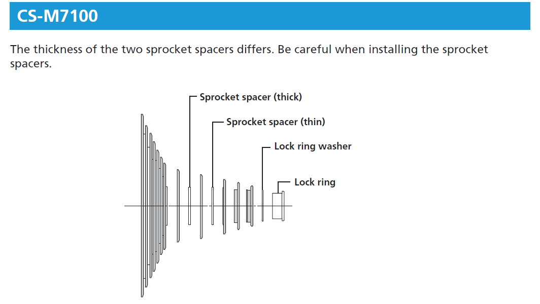

I took my cassette apart today to give it a good clean and get rid of the crappy grease that chains are delivered with. It's the 12-speed CS-M7100 on the 2021 Levo Comp.
After rebuild, the jockey wheels are clicking in three of the gears. It appears to grab the chain and hold it a bit longer than it should roughly once per revolution of the jockey wheel. Happens in gears 9, 10 and 11 (the 2nd, 3rd and 4th smallest cogs). All the rest, including the 12th gear are OK.
See video here. (Sorry, couldn't see a way to upload a video file)
It's too new for it to be wear and it was working fine beforehand. I'm convinced that I rebuilt it correctly according to the diagram from the manual below (except that there was no lock ring washer):
I also took the jockey wheels off and cleaned them. The jockey wheel is rotating in the correct direction according to the arrow on it and pictures I took before I took things apart. The jockey wheels are different and were replaced in the correct positions.
I'm out of ideas.
Any thoughts?

Check if the small cogs are clockwise in the right postion and sitting in properly . Especially the smallest cog on the 2nd smallest cog, there are postion markers (little dots) on them.

Take the cassette off and rebuild it again. 12-speed cassette is really accurate that it is assembled correctly.
Thank you. Yup, done that a couple of times, all is correct. Even found that the locking ring washer was still attached to the locking ring, so all parts are definitely there. Also spun the cassette with the wheel detached from the bike to check that there was no wobble.
Still clueless.
