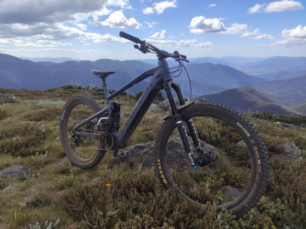

I got the jam2 6.7 here in aus too.
I swapped out a bunch of parts from my previous bike. Fork was utter garbage. I put a manitou mezzer on it and have it set to 170.
Shock is surprisingly good but I want to put a mara pro on there but unsure if it will fit.
I also swapped out the wheels, stem, bars, dropper and brakes but only because I had better components to use.
I reckon the build was pretty good although my mate has issues with the freehub binding on the stock novatec hubs.
It's an amazing rig, my first ebike. You'll be stoked.

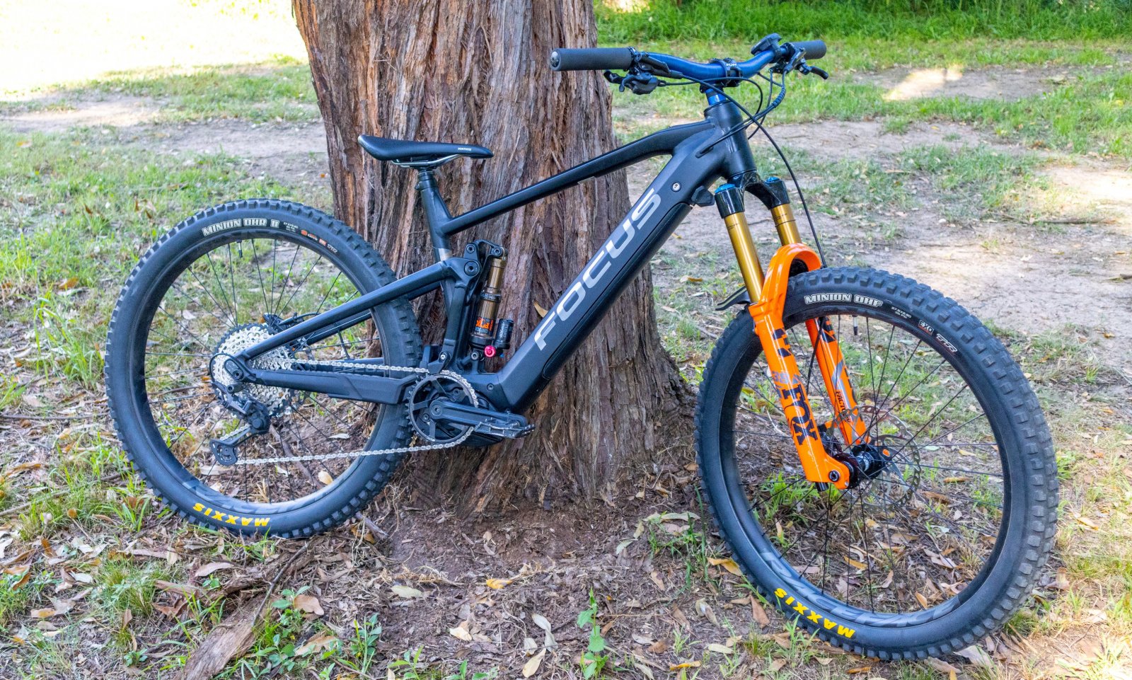

My Focus is matte black - I think that a gloss black fork won't exactly suit it, so it's either non ebike Factory orange or Performance Elite matte black. The only difference in the forks between ebike and non ebike is the damper. And Factory vs Performance Elite is the Kashima coating.

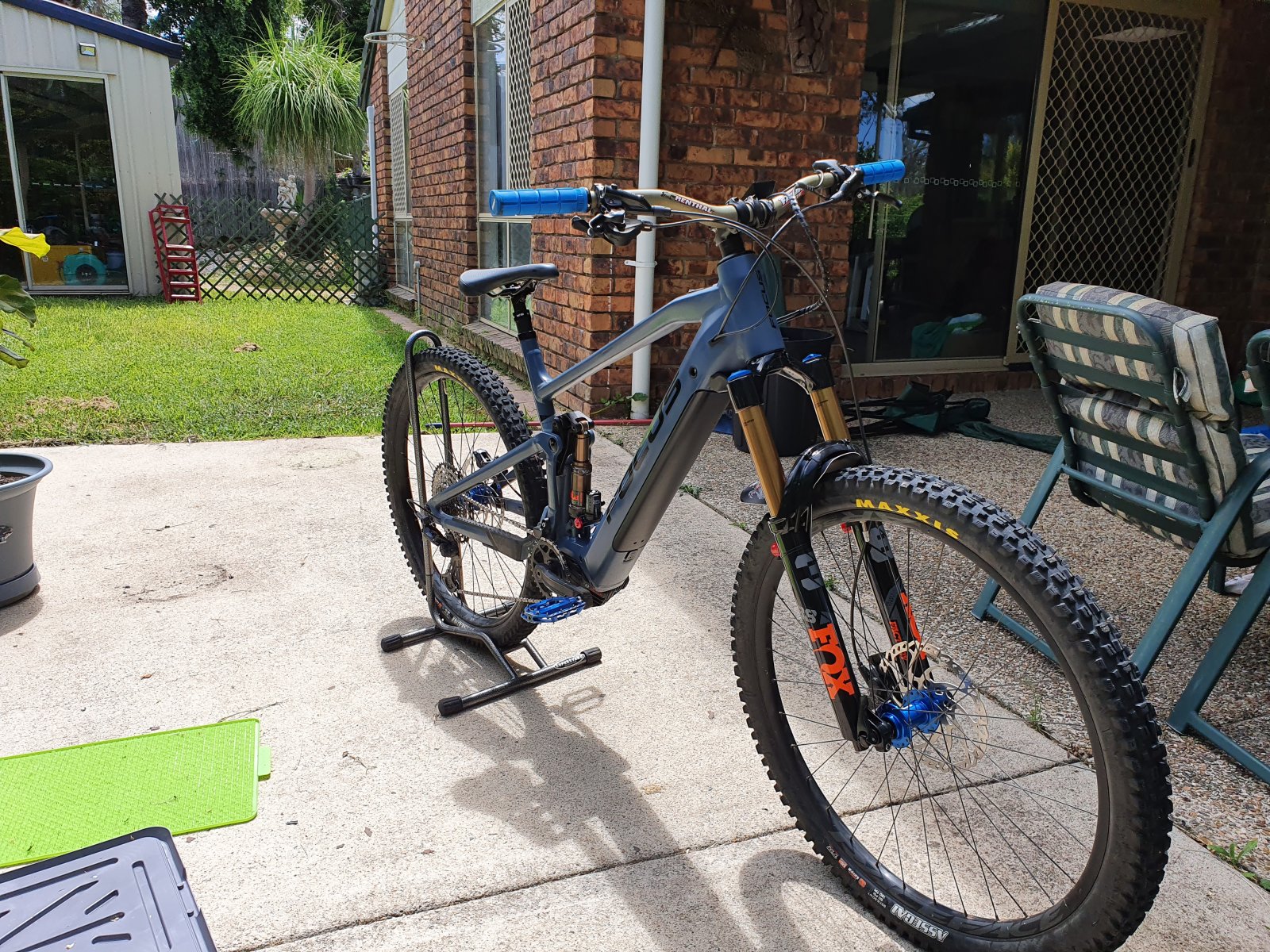

you r right they do only come in 44 offset, I got mine built to suit.. what part of the country u in ?
I have the matt blue focus
