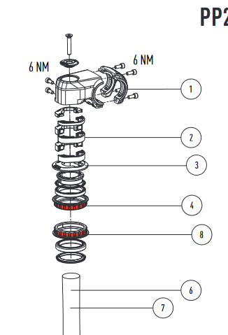

I just checked in with Focus on the headset / integrated system.
Focus Say:
You just need a different top cap from acros that allows you to run the cables through the top cap and run whatever stem you like (like Olly Wilkins and Ben Deakin do to run sponsor correct stem) we spec an acros headset but replacement bearings are available elsewhere (aire valley bearings just as an example).
Top Cap:
RustyMTB
Jul 22, 2020
3,066
7,442
I'm visualising how a bike would look with the cables running through the top cap & I think I would drill actual holes in the top tube before fitting one of those. This is an awful lot of fannying around in order to solve a problem that doesn't really exist.

Does it make it more difficult with the cables through the stem / headset? Never tried fettling around with it but noticed this in the press pack if people want to swap things around:
From Focus:
For riders who want to use a standard stem, the whole system is interchangeable with standard options. You only need to change the top cap of the headset. With a regular stem setup, the cables still get routed through the headset and the frame.
Yes.
MTB headset bearings ideally need to be easily accessed for routine replacement.
and cables/hoses routed through the headset (and through the top bearing) make the job an absolute ball ache.
If you ever meet the twat who came up with this idea please shit in his dinner!

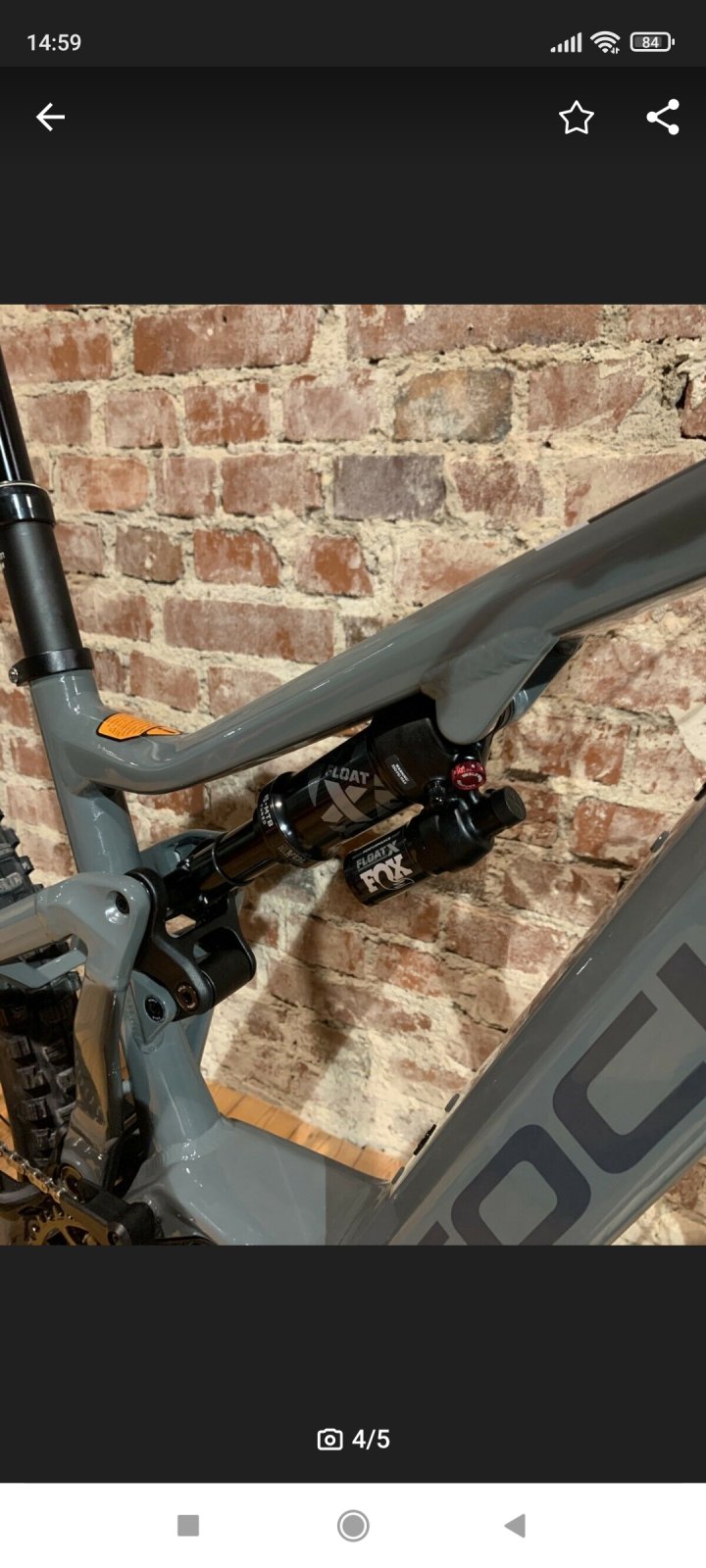

I was wondering why a 150mm bike even had a Zeb nevermind an overall weight of 57lb as that sounds absolutely horrendous to me. and then i watched a video that said this bike is rated for riders up to 150kg.
Fair enough. Emtb as a pastime is definitely attractive to the heavier person so someone has to cater to their needs. I'm sure it'll be a lucrative decision.
But...
From your review @Rob Rides EMTB where you are impressed with the small bump "plushness" ;) I thought it may have had a really progressive curve (which should mean supple in the beginning stroke and around sag if set up well). but then you went on to say you were getting through all the travel on what looked farily tame flow trails.
So what's the shock stroke/leverage ratio for the bike to genuinely be useable for a rider that heavy?

shock is 210x55. They say it’s suitable for coil or air.
According to Focus Press pack (no curve charts):
The suspension was developed to offer a super smooth and sensitive ride with great bottom-out resistance. This is achieved by a linear-progressive suspension curve.
The main pivot is really close to the axle, low anti squat causes little pedal kick-back. Anti squat value is close to 100 when you ride in sag. It means the bike not only descends pretty well, but it also has a great climbing ability. Especially on technical terrain where consistent traction is key.

Nicely vague marketing. But at least it's truthful ;)
What's the shock stroke?
and what's your weight and what pressure did you run?

Just edited to my post above, but it’s 210x55. Can’t remember exact PSI, bike long gone now, but would have set sag to 30%. 87KG.

That's a 2.7 leverage ratio.
a 300lb rider is going to need a custom shock or exceed the max pressure by quite a bit
Ideally for a rider of that sort of weight you'd want a lower leverage ratio and a more progressive curve.
but then it wouldn't work well at all for lighter riders.
Just wondered if the bike was genuinely suitable for a rider up to the weight limit claimed.
Unsurprisingly. seems not.

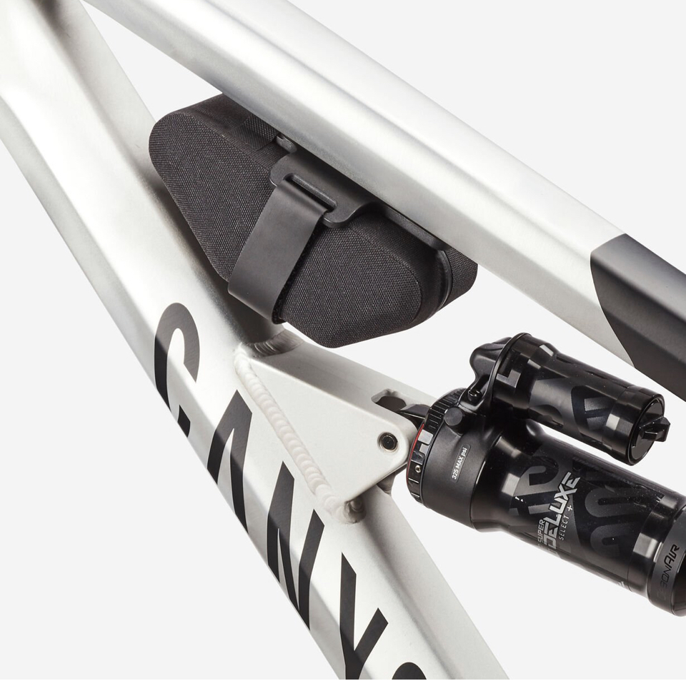

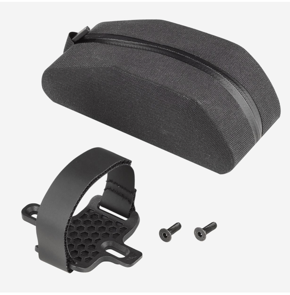

I like the Bag idea, I am a big fan of extra bosses on frames for storage and would probably only use a strap mount but the option of the bag for as and when needed is neat.
Canyon do something very similar
