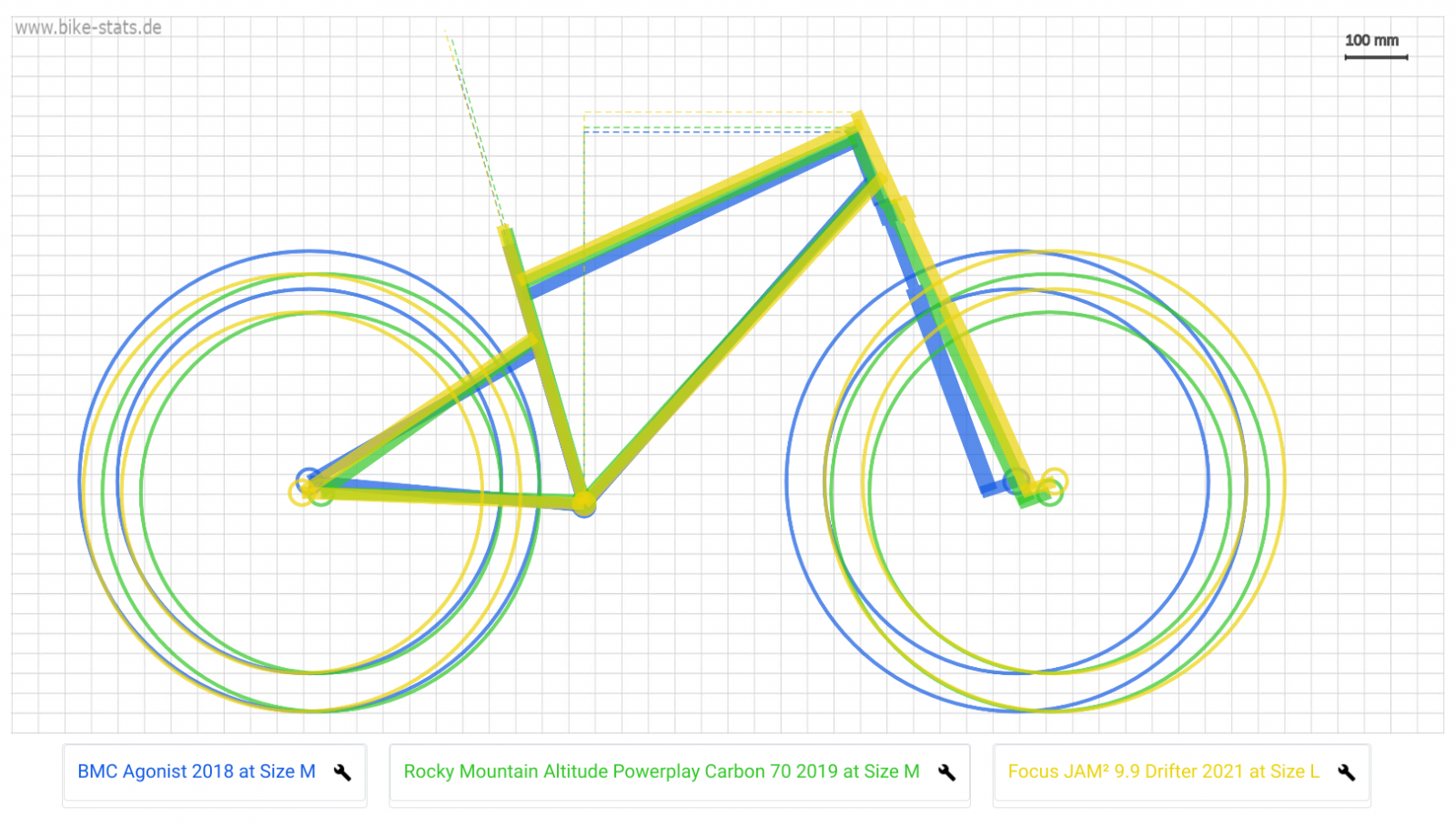

The Jam² 9.9 Drifter in size L has a reach of 440mm, which does not seem substantially longer than my current bike.
Geometry comparison on bike-stats.com
In fact, several reviewers noted that the size of the bike is rather small: E.g. ebike-mtb.com says "Our 1.80m tester was riding the largest size, size L, and it felt very compact." I also reached out to the tester of the bike on emtb-news.com, who says he is 174cm (5cm smaller than I am) and he would also choose size L for himself. Lastly, Rob himself in his review (and comparison video) also comments on the compact-ness of the bike.
Now, I know that reach is only one aspect of the geometry, and the Focus is definitely the largest bikes of the three, but I am curious to hear if people think the size will be an issue.
