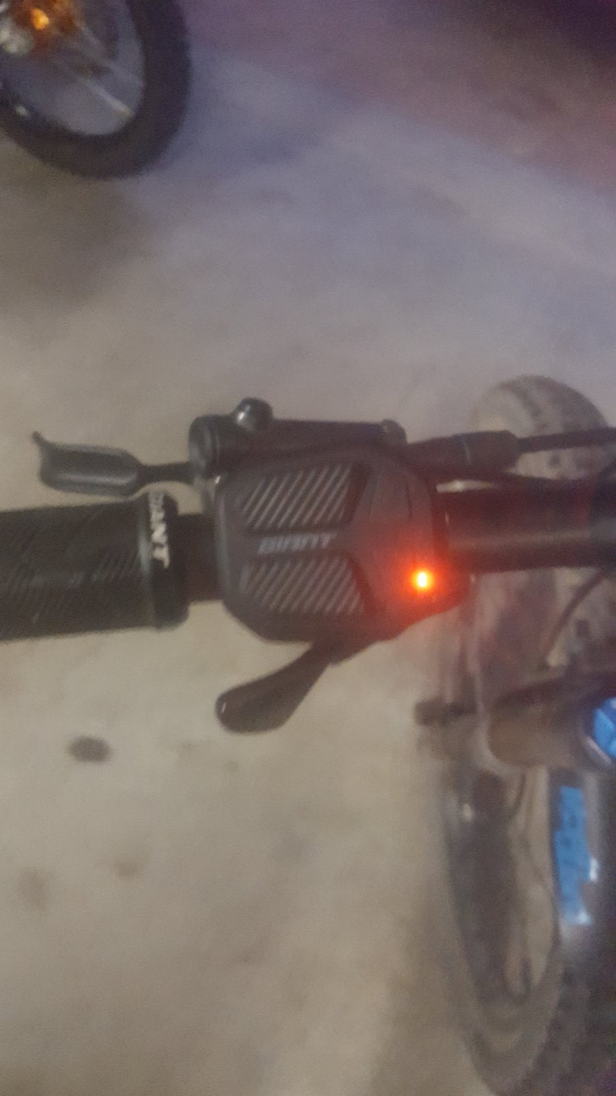

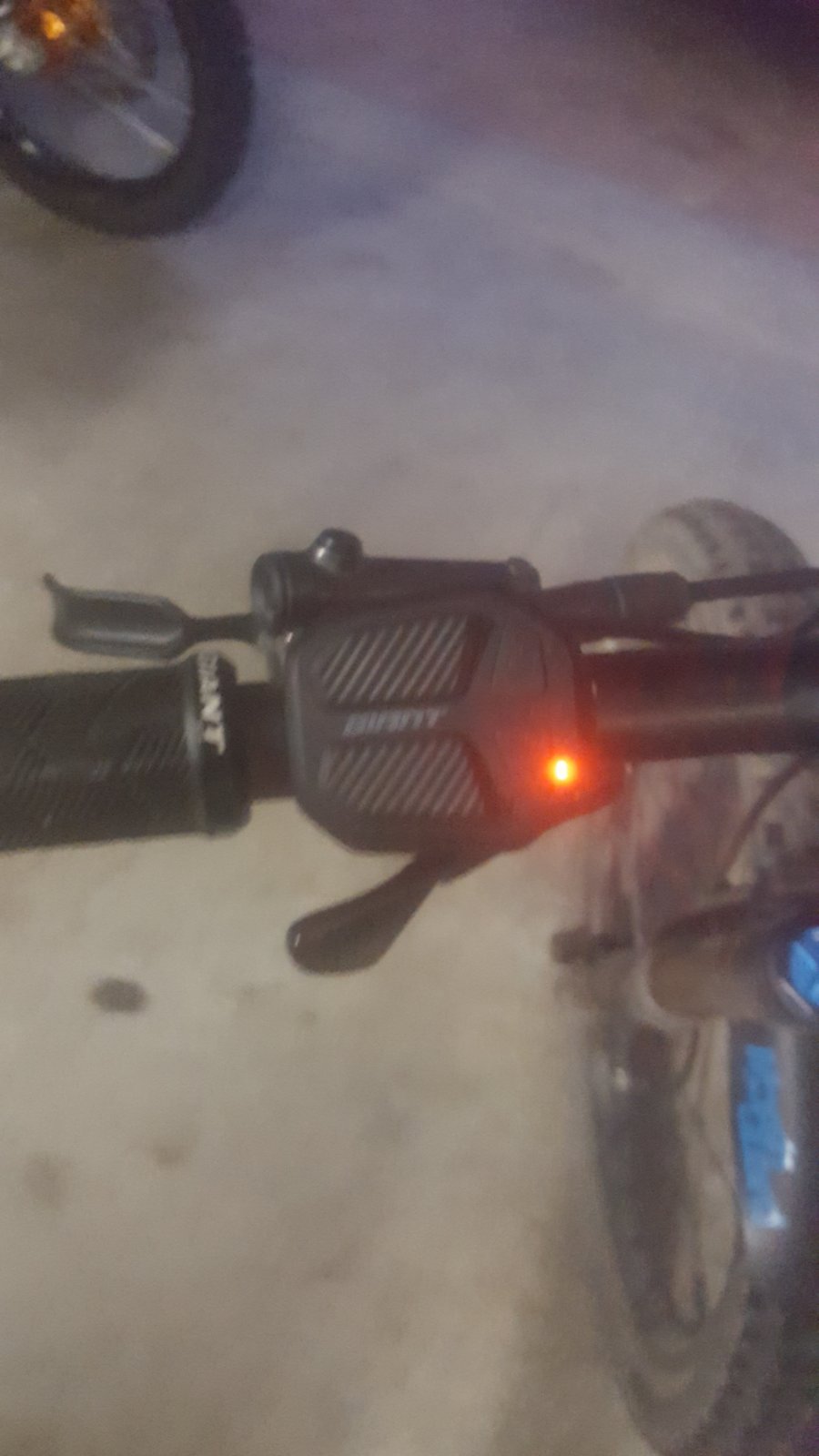

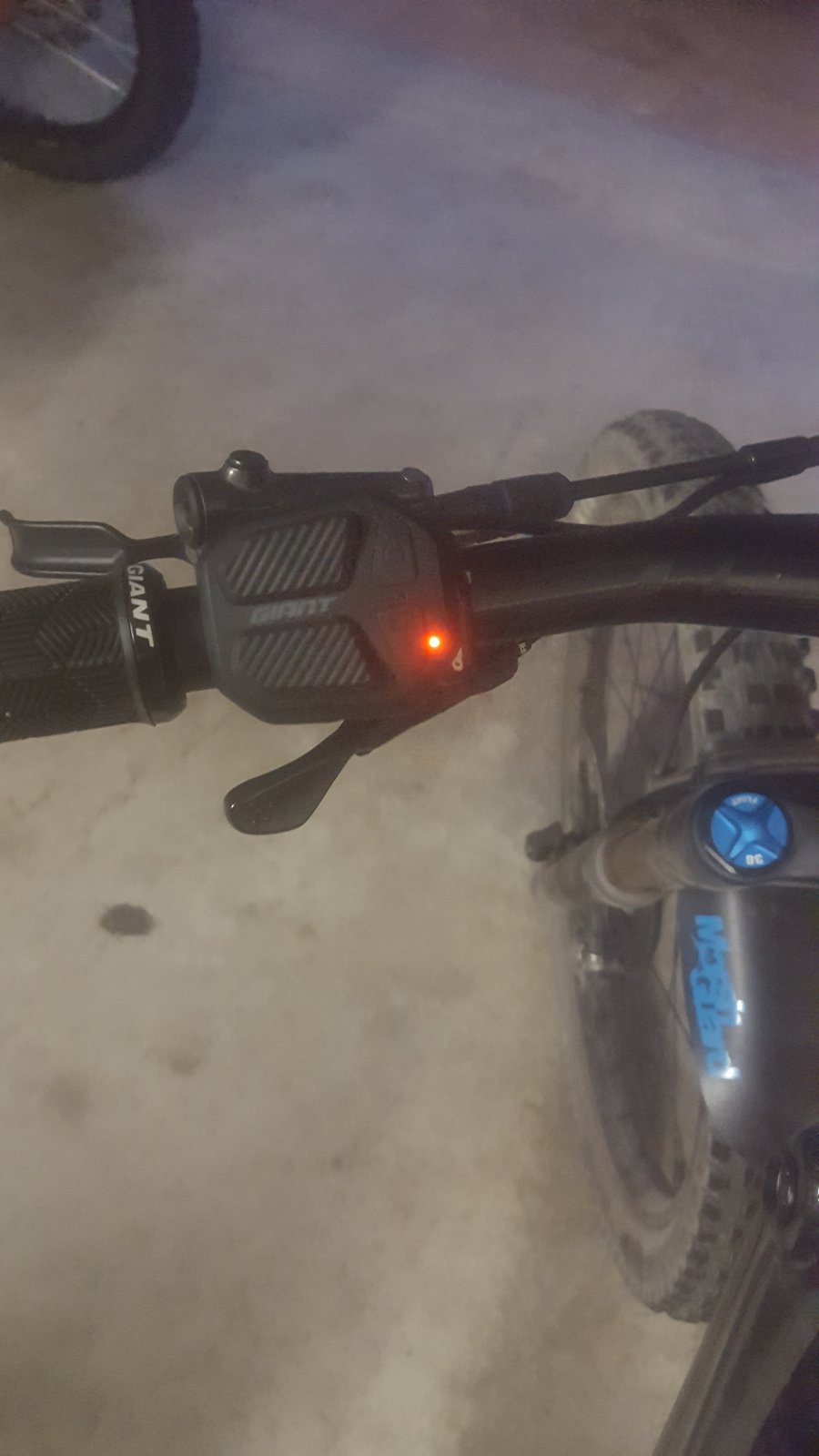

Well 9 weeks in and my stance e died today’ 14 miles from home with alot of big climbs!! Knackered by time i got back..... hasnt been rode in rain and i wash it very gentle , bike cut out repeatedly today and then died all together showing either 1/2 red flashing lights ( battery or motor)... wouldnt power back up!! Phoned my giant dealer reckons never heard of that before so will see what they say when i drop the shite off

Dan did yours cut out constantly and then display a red light fault?
at first no red light fault.. just on and off.. then it got worse like constantly on off.. lastly red light.. it wont turn on again unless i remove the battery and put it back again.. then can last for few km before it off again.
Lee67
Nov 21, 2018
195
205
Yorkshire
Yep exactly like mine.... ive washed bike , removed battery and its turned on ok as you say
