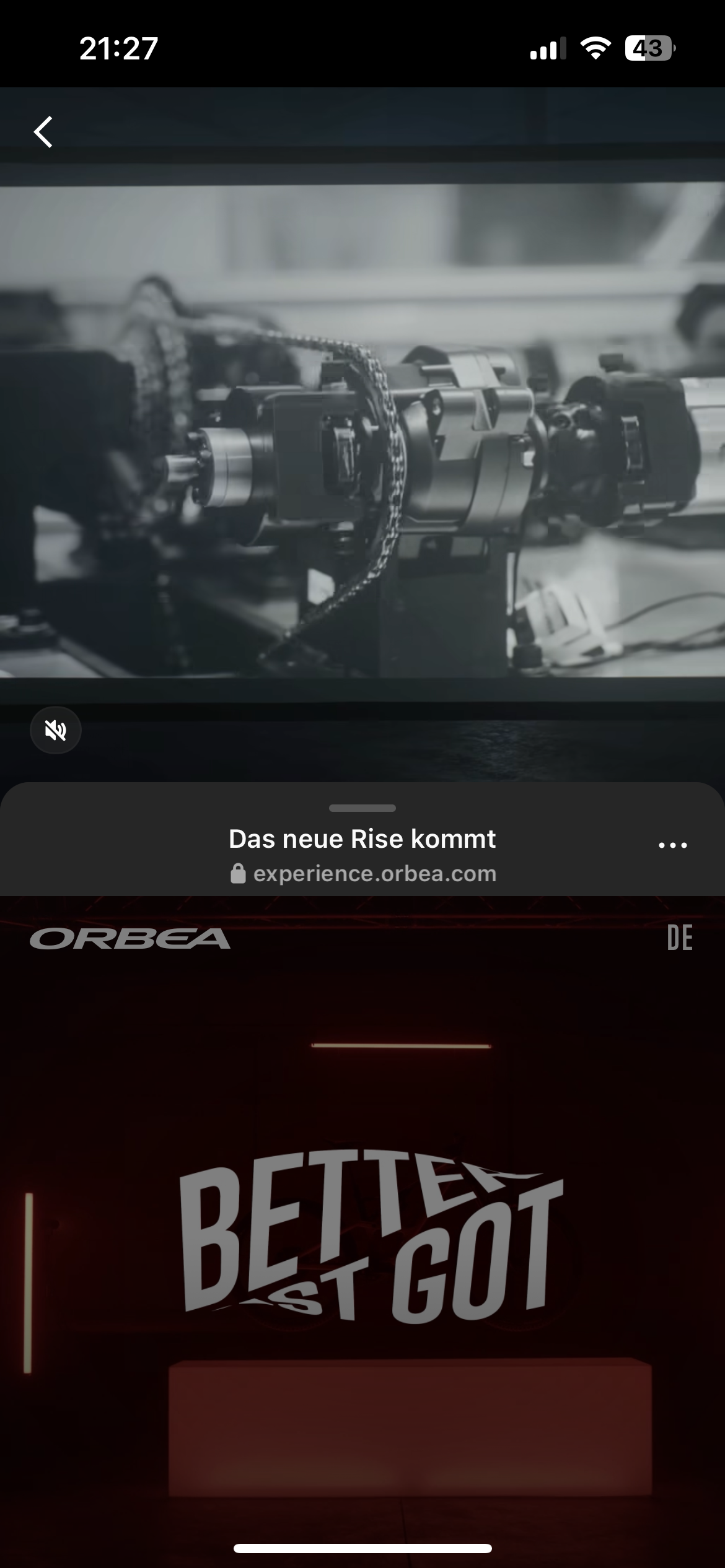

is there a new Orbea about to land ??

No idea about the wild, but the refreshed Rise with 160/160 travel and bigger battery is going to be much closer in ability to the Wild than before. The entire range was up on the website for a day, so it will be announced very soon.

Nah doubt it. This picture was on my feed and that is definitely not the sx. Also, my local bike shop meantioned in confidence they are only getting one sx bike this year which turned out to be the mondraker. And they sell like a ton of orbeas, so I kinda think theyd habe known..
